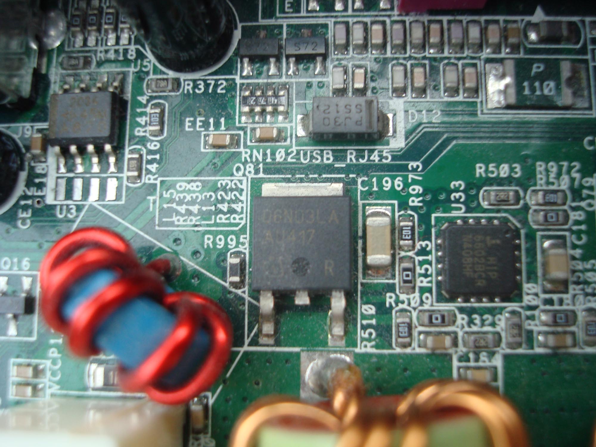

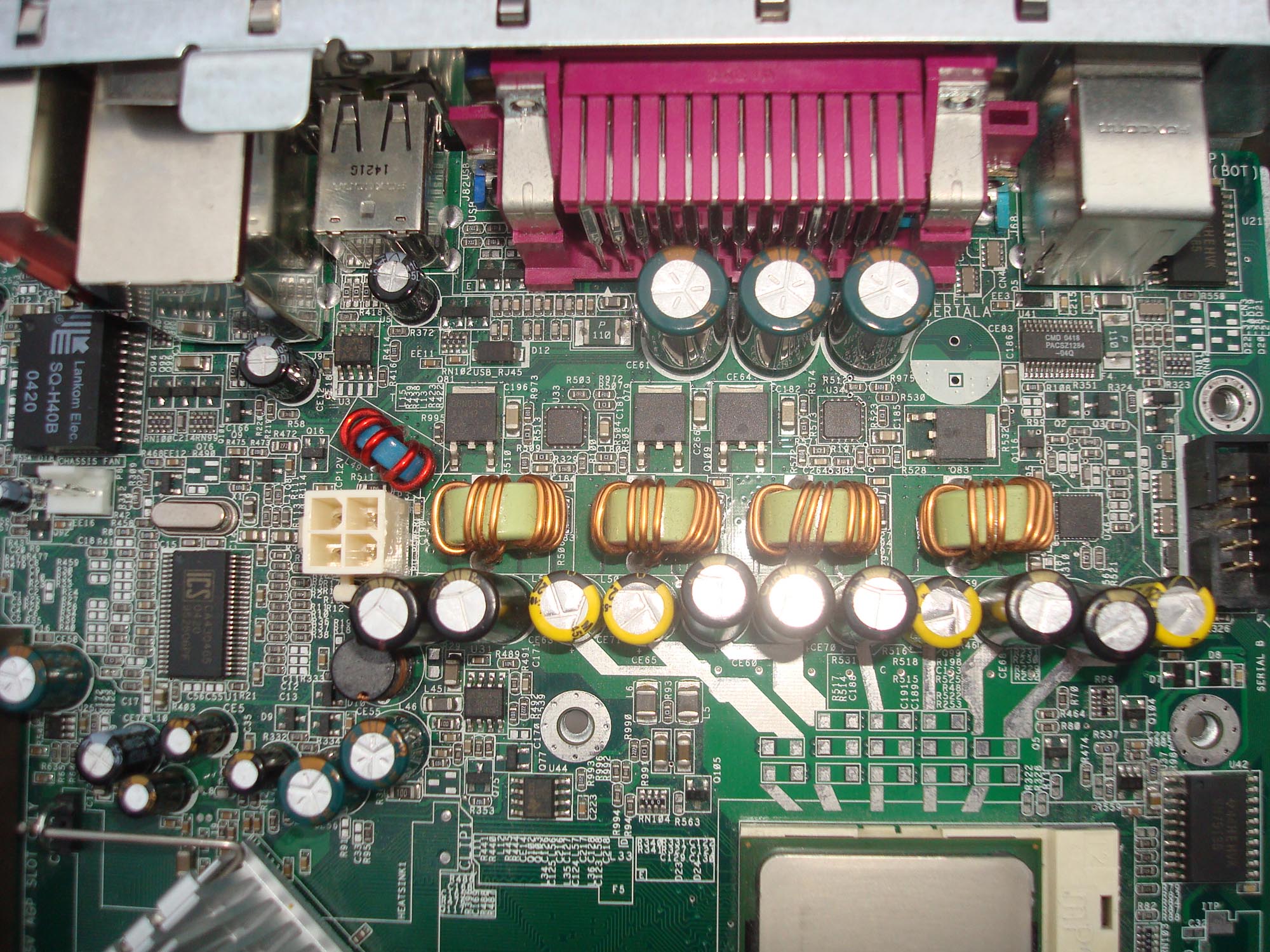

        Here are some pics of the moboif it helps?
        The little square black things I think are MOSFET's are labelled:
        06N03LA
        AU417

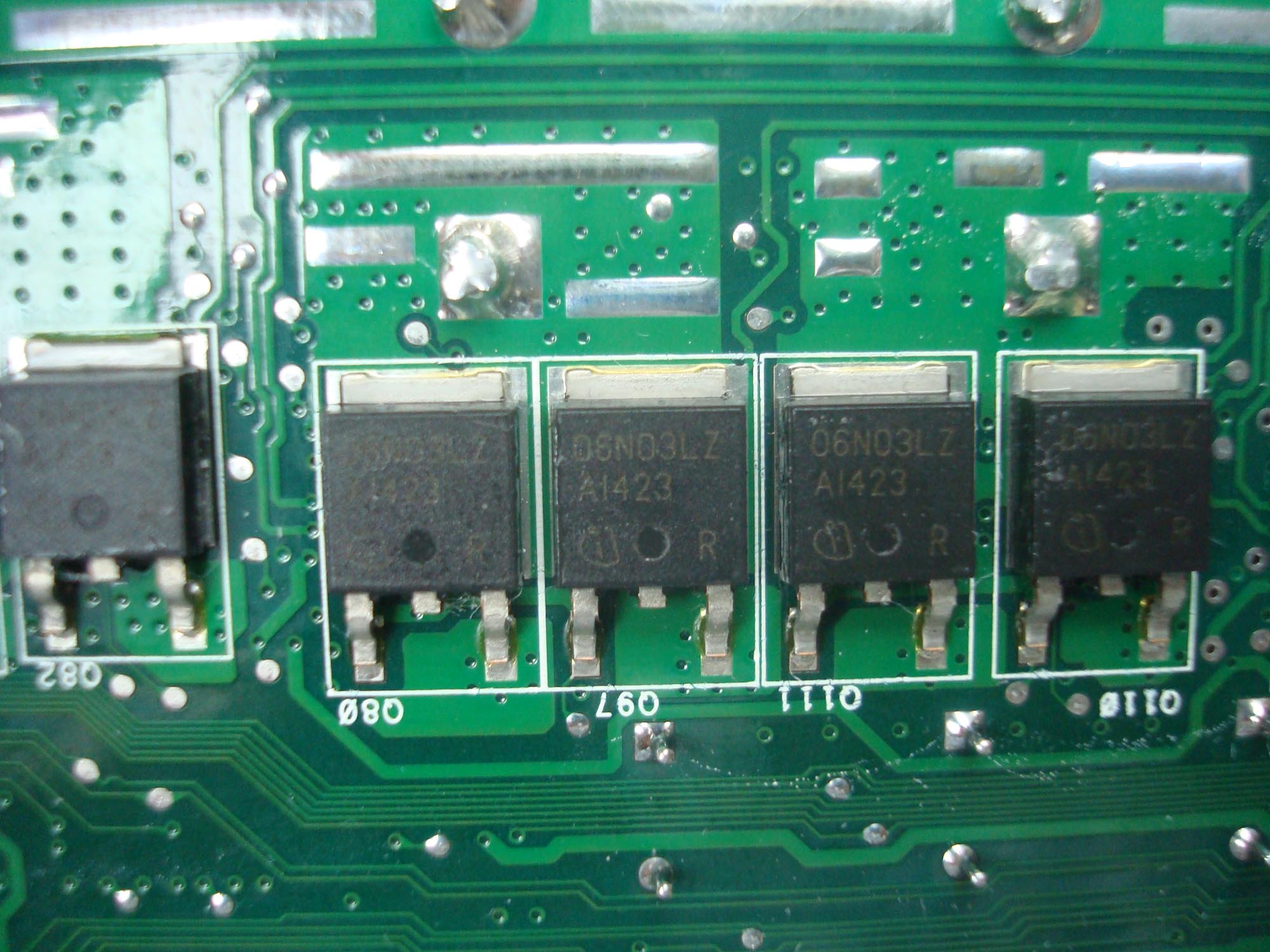

          Oh and I almost forgot these little suckers (look like mosfets to me) were on the bottom of the mobo underneath and near the VRM row of caps.
          06N03LZ
          AI423
          They are seperate from the motherboard bottom plate by a large peice of rubber which had a slightly wet and semi sticky substance on it...I had wondered about this possibly creating a short when I first took the mobo out to bench test it.
          Again, they look like MOSTFETs but not sure how to test? I have heard they often go shorted between GS? or SD? or both?
          Cheers in advance
          -Al

            Tried to test MOSFETs using following procedure. The expected result from the instructions is in the brackets:
            06N03LA
            1) Use DVM in diode test position
            2) Holding red lead on S
            3) Black lead on D. Reading climbs to 557 after about 2-3 seconds. (Instructions say reading should be 500-800)
            4) Put black lead on G. Reading is 13. (Instructions say should be open)
            5) Hold black lead on S
            6) Put red lead on D. Open Circuit (reading 1) (should be open?)
            7) Put red lead on G. Reading 13 (should be open?)
            8) Put red lead backon D. Open (reading 1) (should be low value close to zero?)
            06N03LZ
            3) Black lead on D. Reading 3 (Instructions say reading should be 500-800)
            4) Put black lead on G. Reading is 737. (Instructions say should be open)
            6) Put red lead on D. Reading 3 (should be open?)
            7) Put red lead on G. Reading Open (should be open?)
            8) Put red lead backon D. Reading 3 (should be low value close to zero?)
            Note sure if this testing procedure is correct and if it indicates good or bad?
            -Al

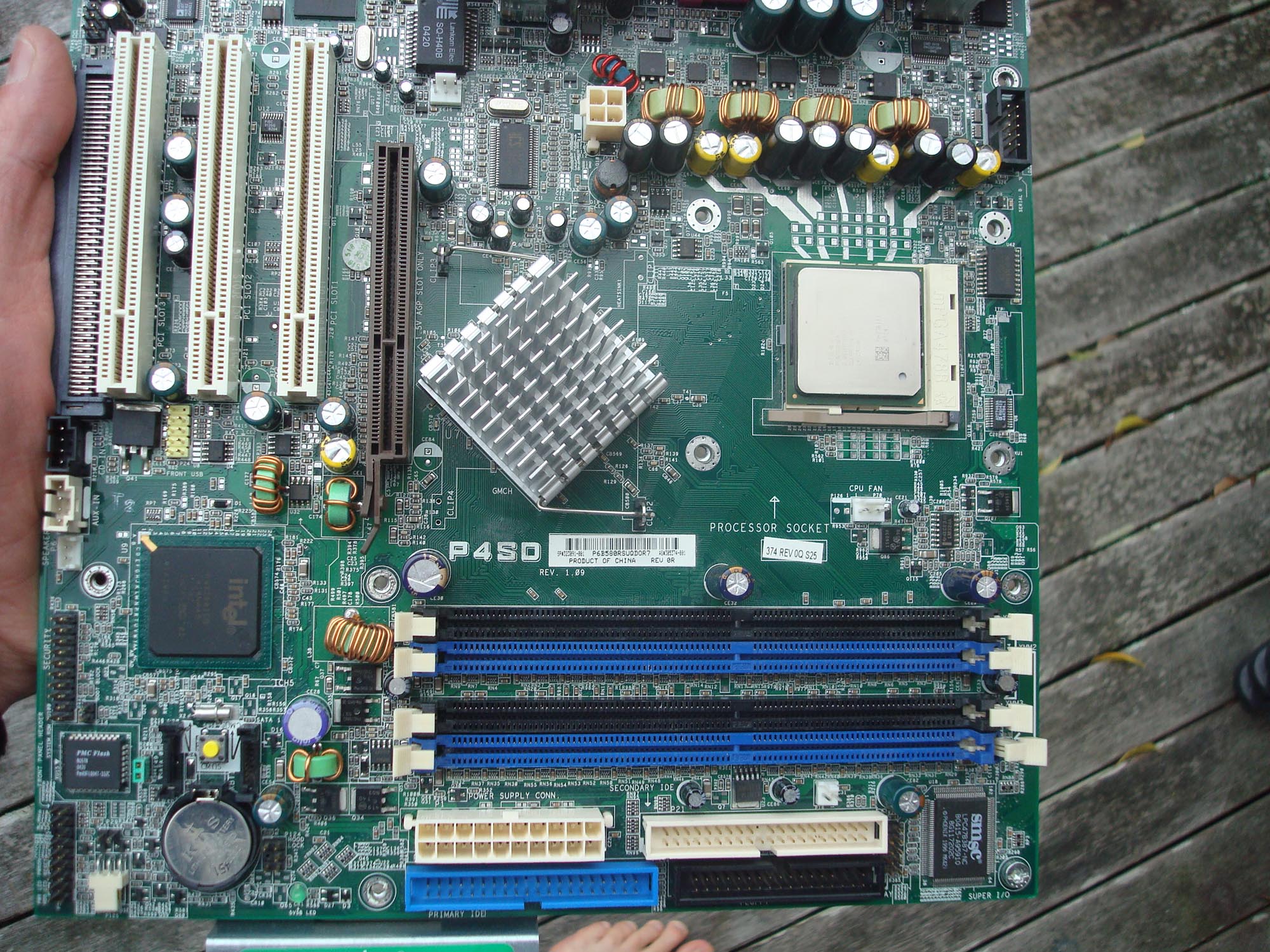

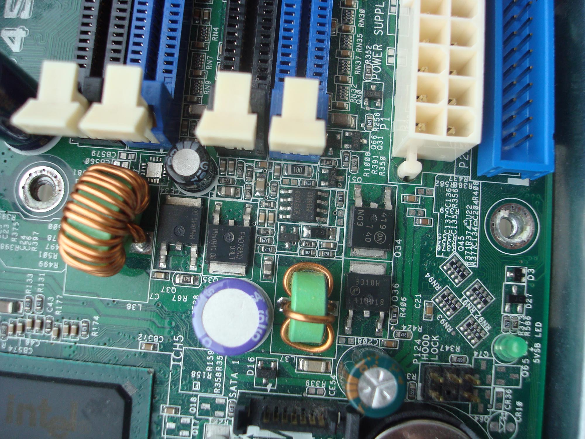

                      • 31067
                      Re: HP D530 Part Deux
                      the whole thread is bullshit,
                      the 5v standby has nothing to do with the vrm or fets.
                      it's used for the main chipset and goes through a regulator.
                      look for 3.3v regulators, maybe type 1117
                      meter them for shorts.
                      or if you want to be hardcore, hook the 5v standby & ground on the mobo to a variable bench supply,
                      set it to 5v and 500ma
                      then see if you can find anything getting hot.
                      if not - wind it up another 500ma and repeat looking for something hot.
                      just keep repeating till something starts to cook.
                      • BigAlNZ
                        • Mar 2008
                        • 65
                        Originally posted by MXM
                        i was wondering if you fixed the 5vsb flashin led problem, i got this on a d530 sff, is not the psu cause i tested it on other mobo.... any ideas??
                        thanks,.
                        ps. are the testing procedure mentioned above correct?
                        No I replaced the mobo in the end. stj's suggestion is not bad, but it may be a bridge failure and youll need BGA gear to repair.
                        -Al
