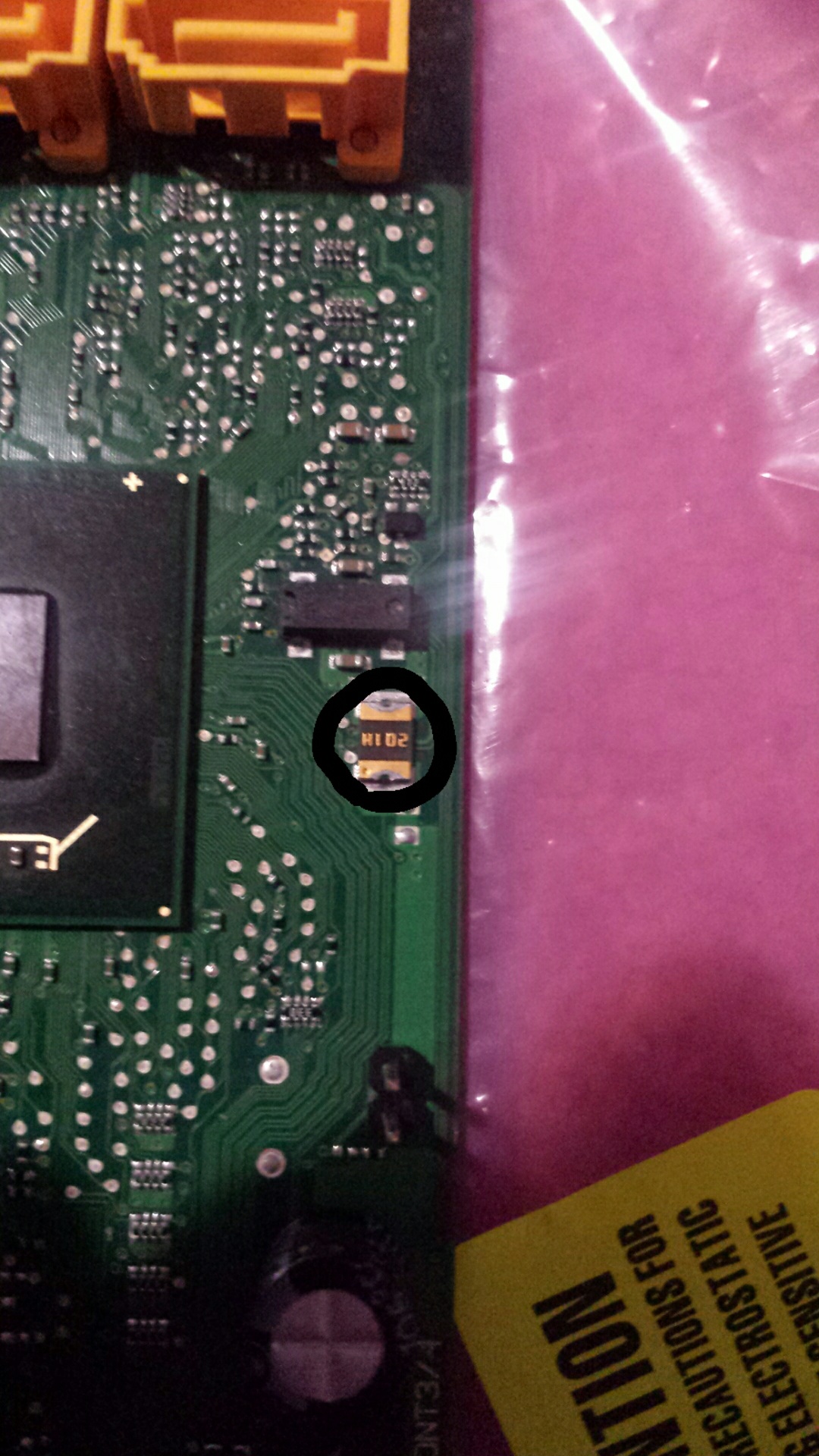

    I'm almost certain that it's a resistor however the code on it is invalid it's off a motherboard if it's any help there is another one with exactly the same code. Many thanks for looking.

    Perhaps this?

      It could be a nand gate but having a look on the internet doesn't show any nand gates like this. Maybe it could be a capacitor???

        Looks like its only connected at the ends, could it just be a inductor (coil) How does it check for resistance?
        Or maybe a diode?
        EDIT: what is the (5 pin) device it is connected to, that might also help

          I think you're right with resistor. Can you remove it with hot air and measure it's value.

            It's has no voltage across it and the resistance was tiny around 0.2 ohms. I'm going to remove it tommorow so I'll let you know.

              measure millihenries across it with your meter .
              another thought it might be a fuse .. check schematic or draw it out yourself if poss .

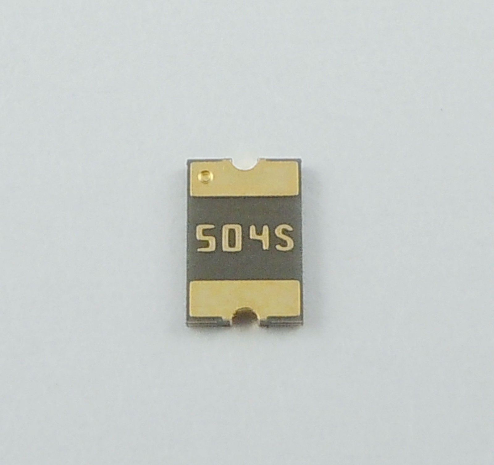

                Looks like a resettable fuse like one of these :
                http://www.littelfuse.com/products/r...ace-mount.aspx

                  I do believe it is a resetable fuse by Bourns maybe 2 amp

                    Re: Help identifying component
                    You could very well be correct. It does appear to connect to a thick pad. It is kind of hard to tell because of the black circle.

                      Thanks for all the help you have given me it defiantly is a resettable fuse.

                          It also could be a current sense resistor, which typically are very low value.
