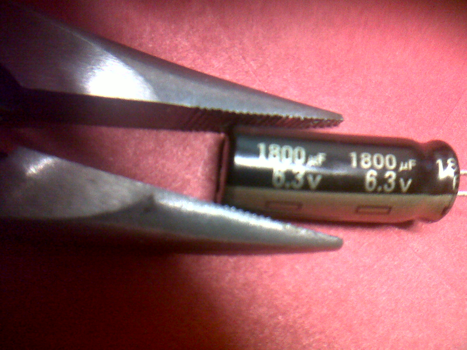

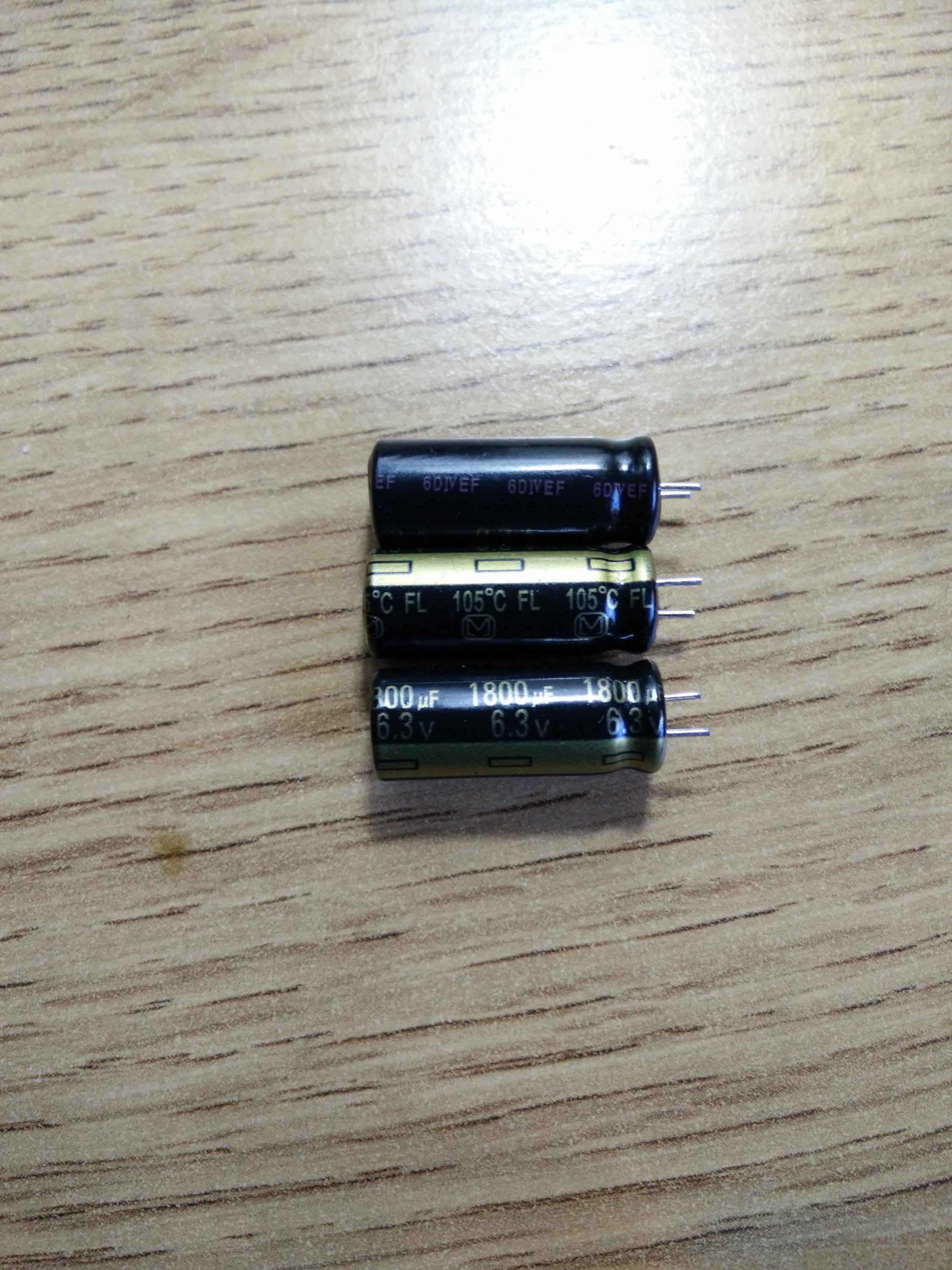

    Hi All. So I am new to this forum and would appreciate your help in identifying some capacitors I ordered from Amazon.
    I ordered them before really researching and finding more reputable resources like Digi-Key. The caps I originally ordered were Rubycon MCZ from the pictures shown. I later found out this was a bad move since these are outdated and have been heavily counterfeited. Much to my surprise, when the caps arrived they were not Rubycons but the ones shown in the pictures attached. Can anyone identity them and tell me if they look fake. Any help would be appreciated.

    Matsushita-panasonic is the brand. Better IMHO. Though, they look fake too. The cropped leads are not promising either. Can't really read the other text.

      Since Matsushita renamed itself to Panasonic Corporation, new Panasonic electrolytic capacitors no longer have the manufacturer's insignia - should Panasonic have an insignia for their components? I think so.

        Re: New Capacitors
        So if these are even genuine, are they old stock?

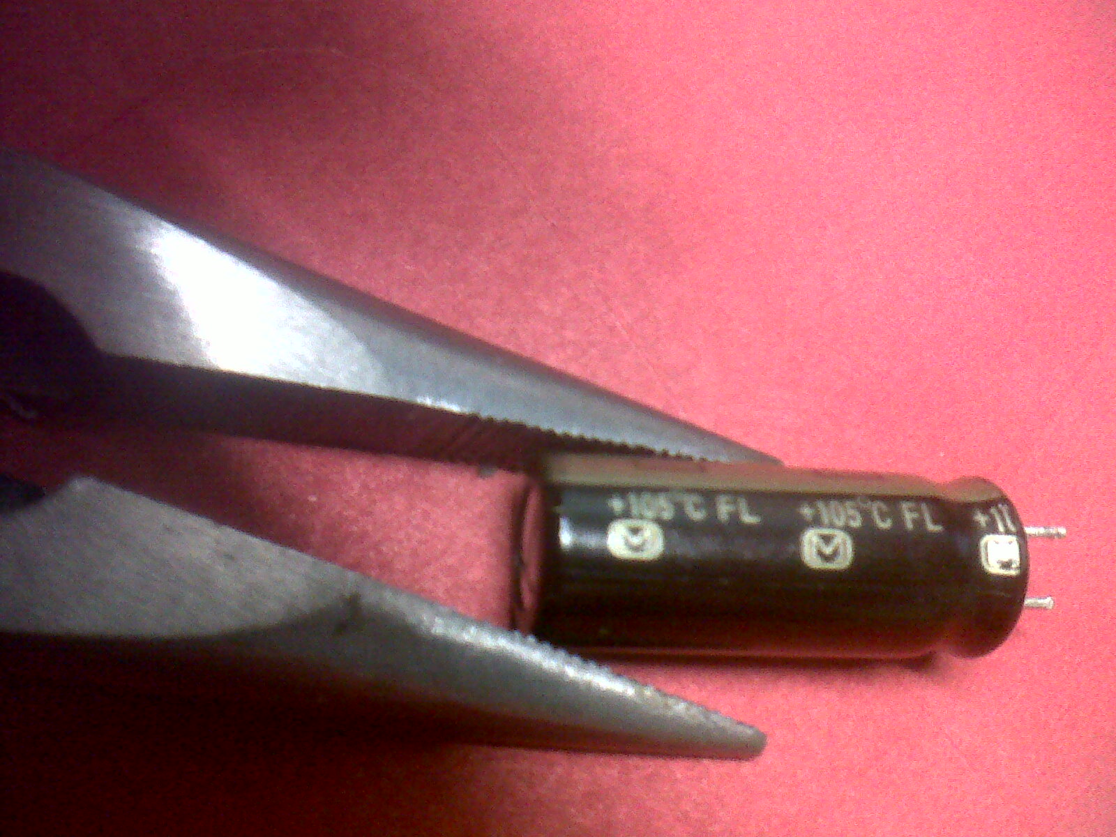

          Re: New Capacitors
          they *almost* look correct, they should have a "+" before the temperature - other than that they look right.
          they are cropped because FL series are used on motherboards, but not AFAIK sold to the public.
          so the leads will be cropped for pick-n-place machines.
          that's also why you wont find a datasheet.
            i would say they are surplus from a chinese or korean production line.
            you should find a date printed on them lightly in red between the gold bits.

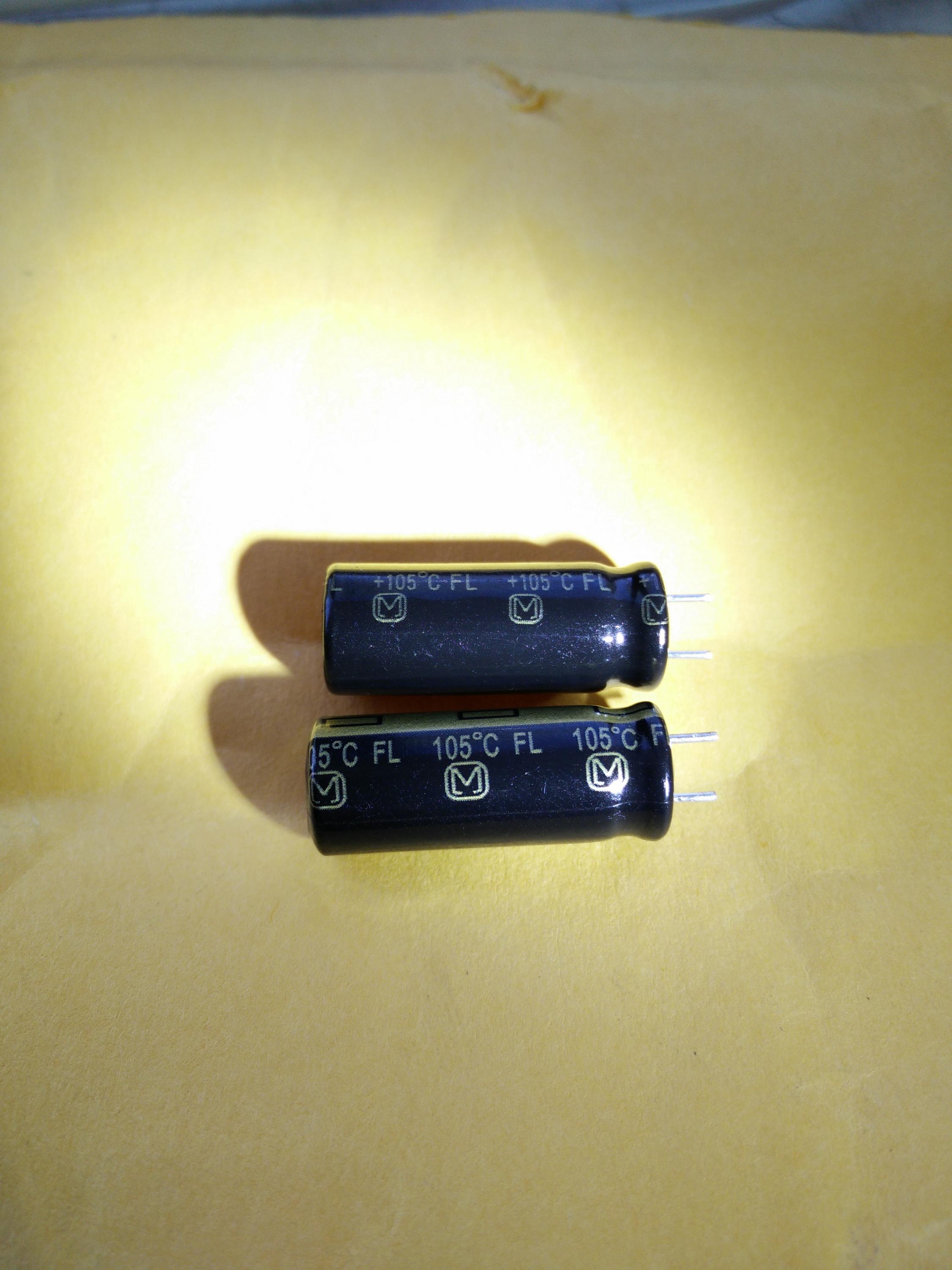

                • 31070
                Re: New Capacitors

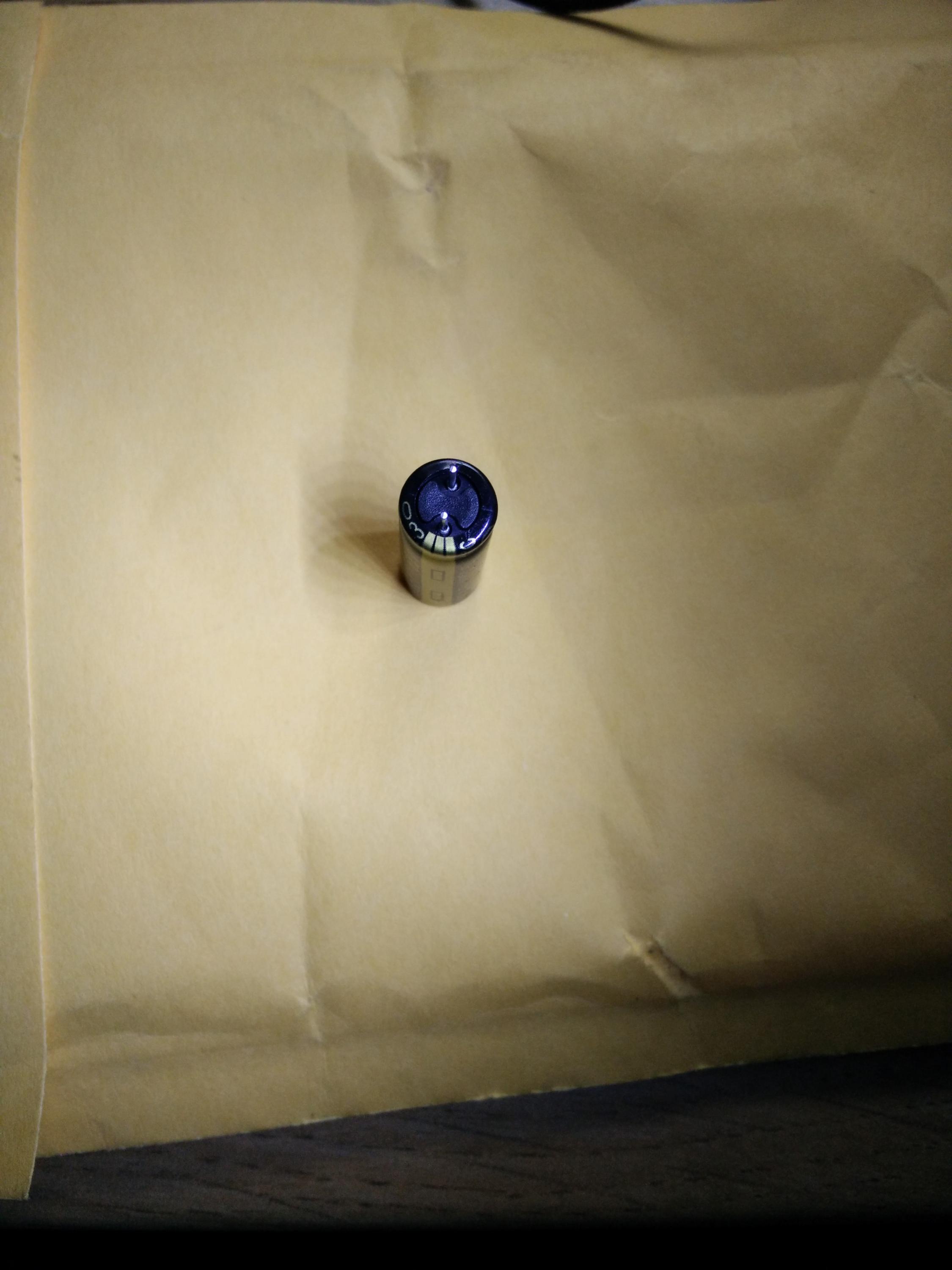

                no, it's not been used, but i want to see the bung.
                look at a real one i pulled.
                i just pulled it from the spares rack & foto'd it.
                • BustinCaps
                  • Mar 2016
                  • 43
                  Re: New Capacitors

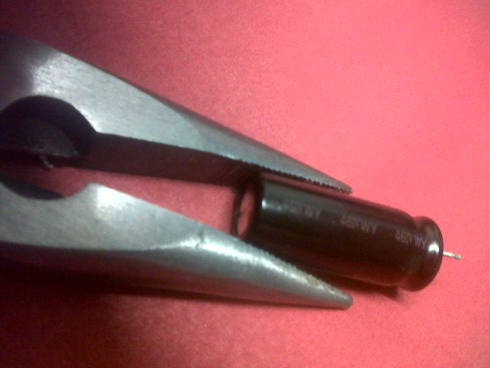

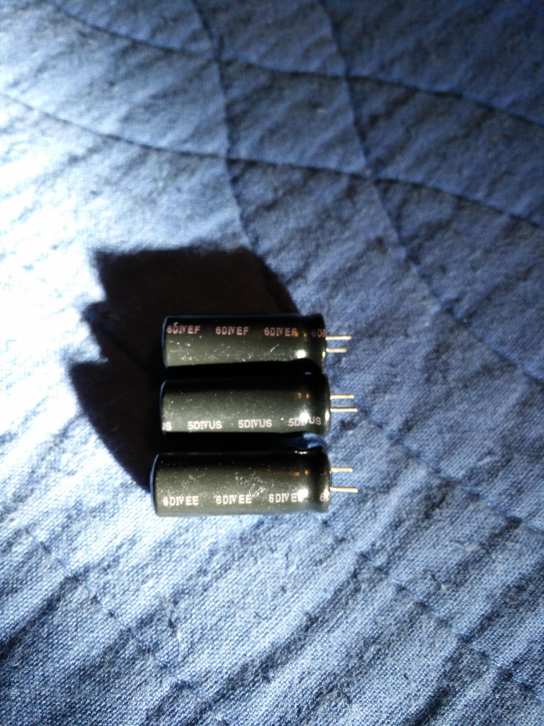

                  OK there are 3 different markings on the caps. Most have what looks like 6DIVEF. There is also 5DIVUS and 6DIVEE. I hope you can see this from the attached pic.
                    So you think they are used and have been pulled from mb?
                      • 31070
                      Re: New Capacitors
                      looking at an internal datasheet - they may be used / recovered from a board.
                      the FJ datasheet shows several lead types, but short & straight isnt one of them.
                      it's hard to say for sure though - what does the bung look like ??

                        Re: New Capacitors
                        Take a look.

                            • 31070
                            Re: New Capacitors
                            well it's the right bung, so it's probably not fake.

                              Re: New Capacitors
                              Thanks for the info. I will probably keep them then.

                                Re: New Capacitors
                                cant help noticing the following issues with the TS' caps:
                                1. why is the bung purple/blue tinted?
                                2. the line used to draw the M logo is too thin.
                                3. the "105°C FL" font is too large compared to stj's genuine caps.

                                  Re: New Capacitors
                                  The bung is black. Probably just the lighting that makes it look a different color. There are differences in the print between caps labeled 6DIVEF and 5DIVUS. See pic below. 5DIVUS shown at the top..6DIVEF at the bottom. Font and logo size look different. Also, top cap has + before "105°CFL". Maybe different production runs. I don't know. If anyone has any further insight, it would be appreciated.

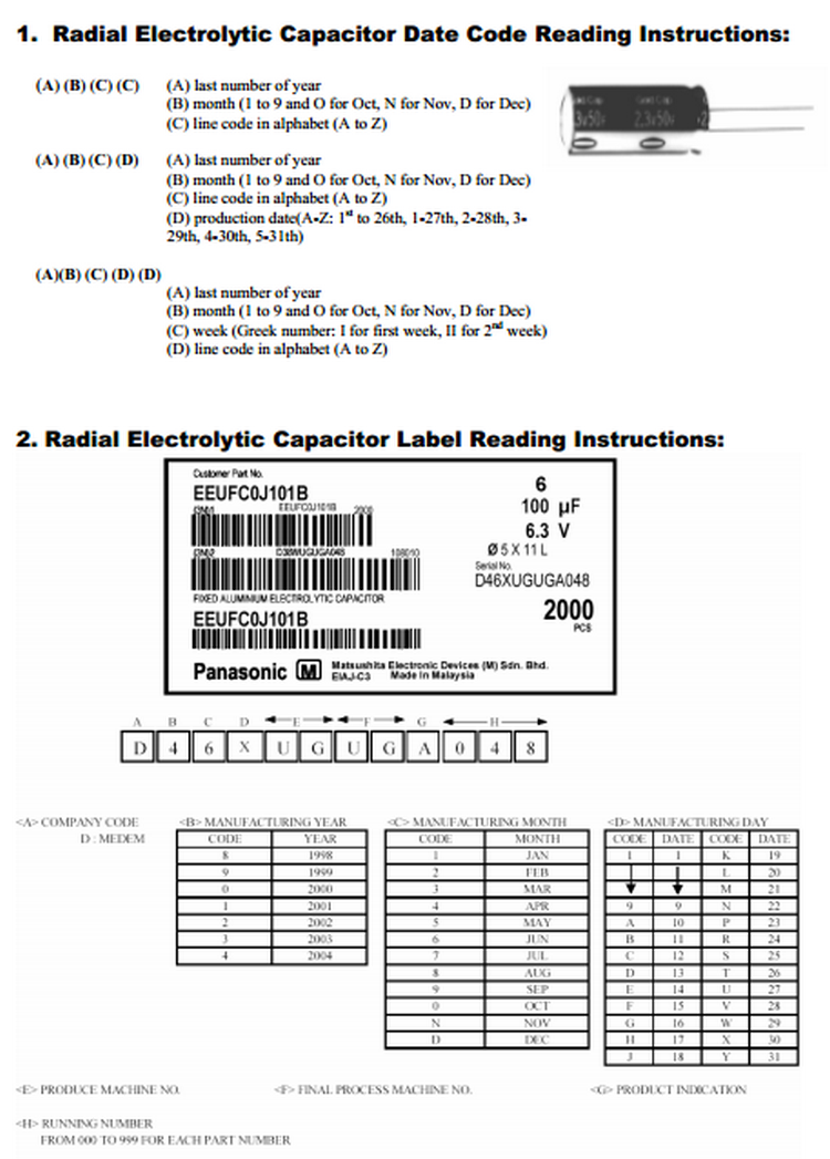

                                    Re: New Capacitors
                                    There are differences in the print between caps labeled 6DIVEF and 5DIVUS. See pic below. 5DIVUS shown at the top..6DIVEF at the bottom. Font and logo size look different. .....If anyone has any further insight, it would be appreciated.
                                    A snip from a Panasonic pdf from 2004, i think it was .
                                    Looks like yours are supposed to be 4 week of dec, 2005 and 2006 .. or dec, 2015 and 2016 or afake date code.
                                    Seems like December of 2015 is too fresh, and the ones from dec 2016 are even fresher
