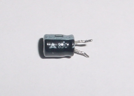

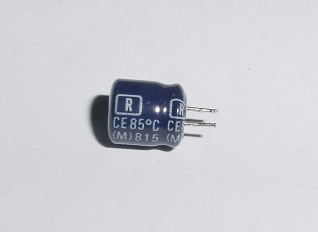

    Hello forum,
    I'm recapping a Sony Telephone Answering Machine, IT-A650. I need assistance identifying the manufacturers from the symbols on two caps. The pictures are attached below.
    Does anyone know these manufacturers?
    Regards
    1. R in a square.
    2. Triangle with arrowheads on the vertices.

    Re: Identify Cap Manufacturer from Symbol
    Mitsubishi caps !
          OK, the triangle with arrowheads is likely Mitsubishi.
          What is the "R" in a square?
            Rubycon. They use that on very small caps.

                    One the Rubycon cap pictured in post #1, these are the specs that I have:
                    Rubycon 2.2μF, 50V, 85°C, CEW M896, dia. 5.13mm, length 11.32mm, lead spacing 2.18mm, lead dia. 0.48mm.
                                second is matsushita(panasonic)
                                quite old.
                                  quite old.
                                  Is the triangle with arrowhead on the vertices Matsushita? Now, Panasonic?
                                  Someone indicated they were Mitsubishi.
                                      Yeah they are Matsushita, I completelly missed that…
