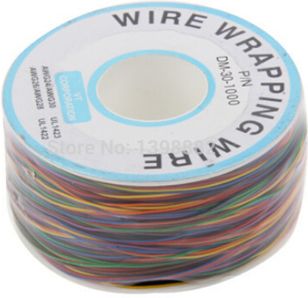

          Here's my shopping list so far, am I missing anything?
                            Looks fine.
                            Are you wire wrapping everything, by the way?
                              No I'm soldering everything, but I'm using wire-wrapping wire because it's solid core. Also that's what I thought you were using on your breadboard, and I thought it would be a convenient way of placing/pulling jumpers on a breadboard I might purchase in the future other than using bona fide jumper wires.
