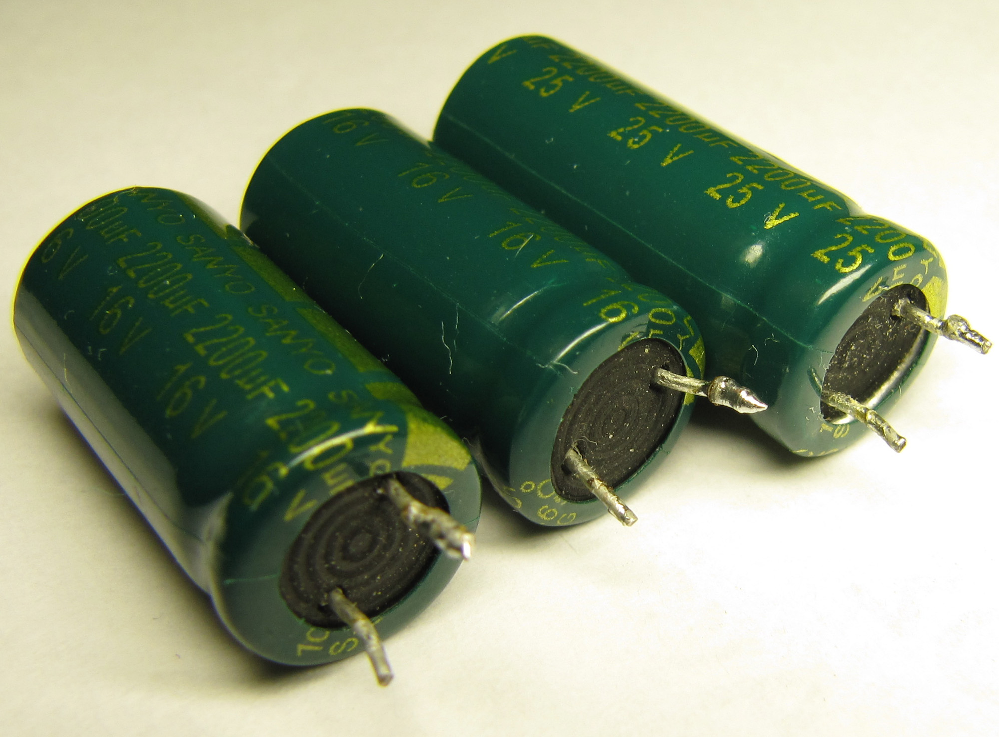

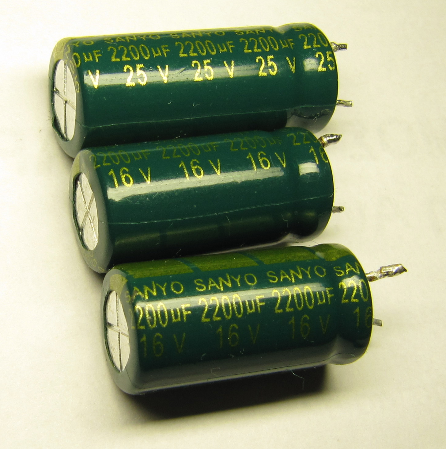

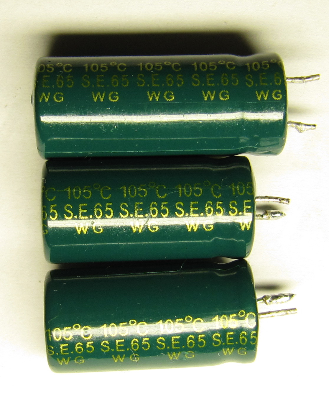

    Those were bought from ebay by a friend (the same guy that gave me a bunch of burnt psus).
    They are definitely fake.
    I tested them with esr micro:
    2200uF 25V --> C: 1840uF esr: 0.11ohm
    2x 2200uF 16V --> 1) C: 1540uF esr: 0.04ohm
    2) C: 2130uF esr: 0.03ohm
    They didn't even try stay close to specs

    Wow, those are terrible, visually and spec wise! They could at least get the correct vent on there if they're going to be faking Sanyo caps

      The bung and vent is a dead giveaway...

            Why does every knockoff always use Arial as the main font? It doesn't help that Arial itself was a modified knockoff version of Helvetica/Univers.

                And the caps weren't even new, they were pulled from used electronics (short, soldered legs)?!
                I'd say 2200uF #1 is starting to go bad.

                  They were pulled from the burnt psus I have posted last 2 weeks. The guy tried to fix those psus recapping them with fake caps. I let him know about that.

                    Also, the 25V cap is barely bigger than the 16V one. It should be significantly bigger. Also....Does 2200uF 16V and 2200uF 25V Sanyo WG even exist in the first place?! They're not in the datasheet.
