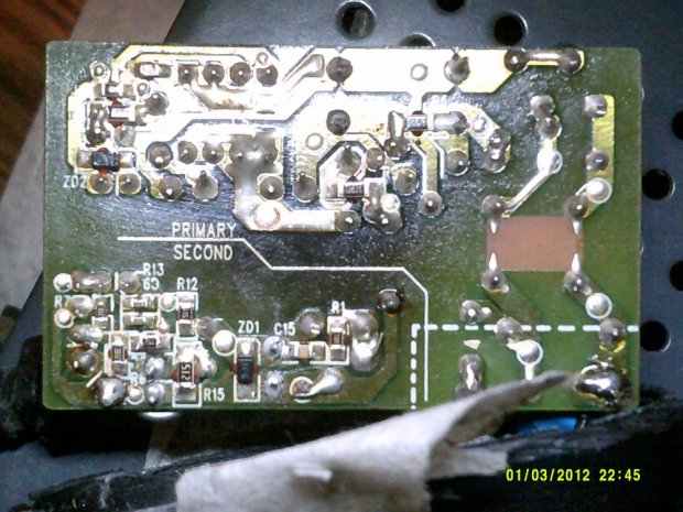

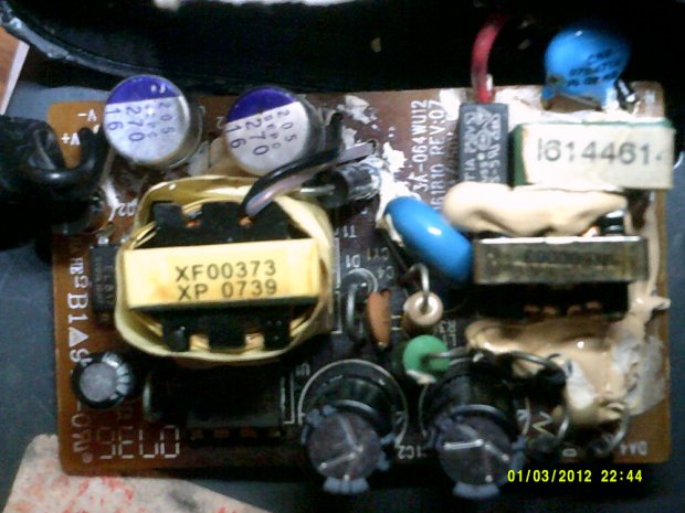

    Had to repair a 12v 500mA switching power supply for a linksys router I use on the go. It was overheating to the point of thermal shutoff (due to the ST VIPer voltage IC on it) while even idle. The insides were smoothed and looked to have been slightly melted from the heat as expected. After inspection I found it had bulging 400v 6.8uf & 16v 220uf Samxon caps with the wrapping so dried out it was cracking off. Was no help there was so much glue in there the insides should have just been molded to a box which didn't help with heat in any form.
    Being as I needed caps on the fly as I'll be traveling overseas where the voltage is 220v@50hz for my router... I had to resort to ebay. Most I had in my cap box were up to 200v-250v and didn't want to cut it that close.
    Ended up with buying the closest match I could get [at the time] on ebay which I normally don't buy caps from to begin with. They happened to be legit looking Rubycons but cannot find the matching capacity or size in their YXA datasheet at all.

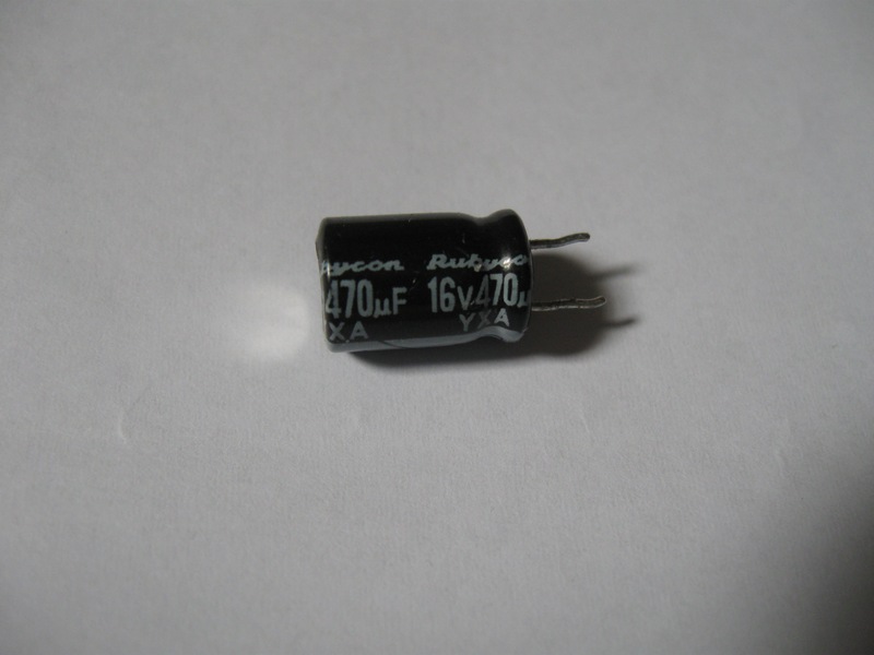

    Brand: Rubycon
    Series: YXA
    Voltage: 400v
    Capacity: 6.8uf
    Height: 16mm
    Diameter: 8mm
    Knowing how everyone is a voyeur here is the image of them from the listing.

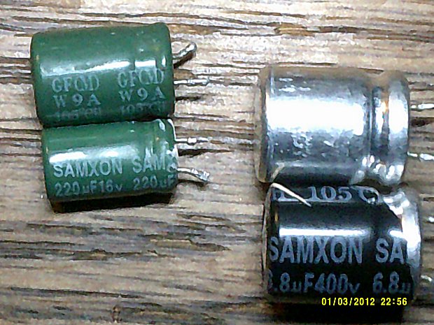

    I'll get a picture of the failed caps later on however once my batteries recharge3 for my crapcam. The DC side 16v 220uf Samxon caps wI replaced with a pair of 16v/100uf OS-Cons salvaged from a dead Gigabyte motherboard since the high ripple will be more than sufficient to make up for the lower capacitance. It works fine but those 400v Rubycons I find are questionable due to not being listed in their Datasheets.

    You should know better, as on eBay there are plenty of counterfeit Rubycon, Nichicon, Panasonic, Nippon Chemi-con (a.k.a United Chemi-con), Elna and Sanyo capacitors on sale. Some counterfeits are easy to spot, especially by looking at the printing on the sleeve, color of the markings, the vent on the top and/or the bung at the bottom. Some counterfeits can look pretty darn close to the originals and quite often does not show up in the datasheet for the given capacitance and voltage rating, and sometimes it can be found in the datasheet but of the wrong size (usually the height).
    I would recommend getting capacitors from authorised electronic components distributor such as Newark/Farnell/element14, RS Components/Allied Electronics, Mouser and Digikey. At least they are guranteed to be genuine...
    Examples: Newark > Passive Components > Capacitors > Aluminium Electrolytic Capacitors - Leaded > 400BXC6R8MEFC10X16, Allied Electronics > Passive Components > Capacitors > ULD2G6R8MPD1TD, Mouser > Passive Components > Capacitors > Aluminum Electrolytic Capacitors > Aluminum Electrolytic Capacitors - Leaded > Nichicon UCS2W6R8MPD, Digikey > Capacitors > Aluminum Capacitors > EKXG401ELL6R8MJ16S, etc...
    Does not sound right, as that is a huge capacitance difference (at least half of the original capacitance is gone). You should be using 220uF instead of 100uF...

            IMHO, those Rubycon YXA 6.8uF/400V that you got from EBay are 100% original NOS caps. They'll work practically forever on the primary side of the small SMPS wall-warts. There are however larger values available in slight larger diameters - 22 or 47uF/400V in Nichicon CS, PW, etc. are in the 16 or 18mm diameter range, and fairly compact in height.
            Edit: All the Japanese majors have capacitors that differ in dimensions from the preferred dimensions on the datasheet. The alternate dimensions may be special-production items for large customers, or just older or newer product that was removed or not updated on the datasheet.
                That helps as I normally go by Datasheets verbatim as being the only offerings. I guess I don't need to worry so much after all then about them if that's the case.

                It actually got so hot (thermal shutoff when not connected to anything in less than 5 minutes) due to the caps failing inside (Samxon GF/KM) series. It got to the point the KM's even had their sleeves brittle and flaking off from touch. Ever since the recap it's been cool to the touch while pushing it on an overclocked WRT54G-TM (which is also my webserver) during stress testing but the router only consumes around 4-5watts (~400ma) as it is so well within limits. It's a thin wart which was preferable and hate to toss something that can be fixed. I wish those were so cheap to get here however. I have plenty of linear transformer based warts so I have many I could use.. just needed a switcher for when I go overseas.
                Can tell how much it overheated previously as the board was even darkened as a result. I did remove about 90% of the glue they used in it as even the original caps were at least 50% submerged in it. Was a bit ridiculous looking like someone just squirted the whole bottle blindly.

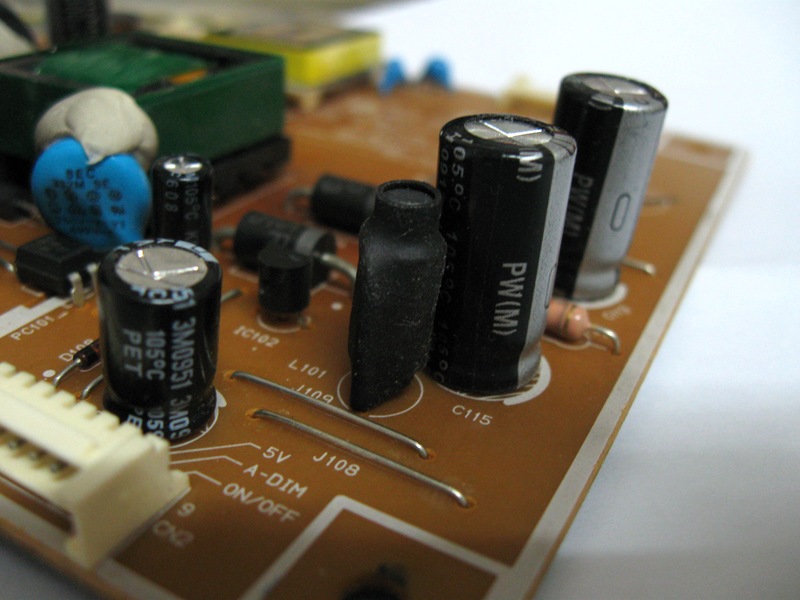

                  Anyway, here's that questionable Rubycon with that suspicious "y" in the first attached image. Its also a YXA series. None of my Rubycons have that type of "y" printing. In the second image, fake Nichicon PW series capacitor (from someone else's self-repair). The colors and the size are both wrong. When pulled off the board, the bung is incorrect. The real Nichicon PW series have white letters on brown (while the fake one is silver on black), plus the size is supposed to 12.5x20mm for 1000uF 25VDC (while the fake one is 10x20mm).

                    Those Samxons don't look too bad - maybe slightly bulged and dried out. The excess heat may be due to a leaky snubber diode - possibly D1. If it's not heating up now, you can leave it alone, but otherwise it may be worth replacing D1 with a UF4007 or HER108 fast-recovery rectifier.
                    Edit: The Nichicon PW above is most probably fake, but that Rubycon YXA is probably authentic (need a closer look at the bung, vent pattern, scoring and text to be sure). YXA isn't worth faking, since it's a widely available GP/moderate ESR series.

                      I have a switching bench PSU that has fake Nichicon PW's also. They are black, instead of the proper brown color, and the printing is horrible/messy, AND the bung is circular, AAAND the size is incorrect!...

                        One of the GF's failed despite showing no physical changes as well. Before changing both the supply would audibly click and struggle to provide even so much as 5v despite changing the primary filter caps out. If I'm going to recap one I'd be better off recapping them all.
                        I'll look into the diode and run it through a few paces off board this week for the heck of it. I don't have any axial diodes extra aside from the common N and U series ones. Seems to be all there are on the scrap boards I have from a destroyed projection TV I salvaged them from as someone smashed the Fresnel lens, clipped out the copper windings/inductors, etc.
                        Visually, I cannot really tell the difference with that YXA from the photos. It otherwise looks okay aside from the compressed Y on the inner bell curve of the cap.
