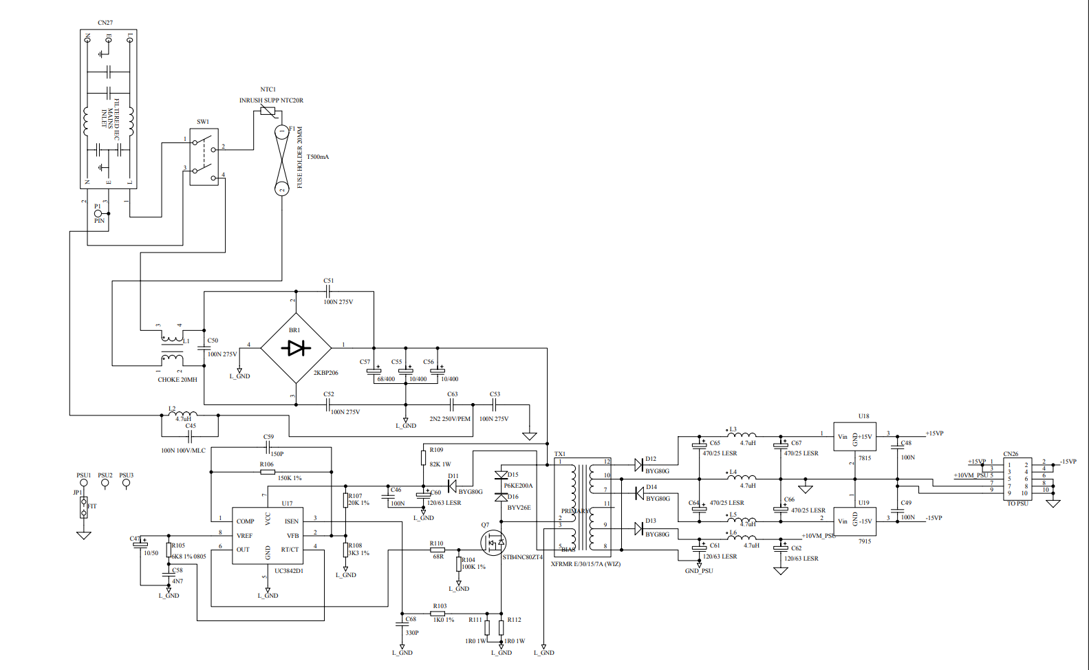

    I'm having issues with my DJ mixer, and after taking it apart and checking everything out, it seems that I need to replace 2 rotary potentiometers for the filter, and that the PSU has some caps burned. Hopefully these 2 fixes will solve my issues.
    The potentiometers I will just replace (hopefully the repairman I spoke with will indeed send me the spares, in case he doesn't, I'll update here if we can find a suitable replacement), but for the PSU caps I'd kindly ask you forum members, if anyone could help guide me in the right direction. I'm having difficulty choosing suitable replacements, since this is my first electronics ''repair project'', and my electrical knowledge is extremely limited.
    There was an almost identical post made here many years ago, but many of the replacements used in that post are discontinued, and a few caps have different ratings than the ones in my case, so I figured I would open a new post here.

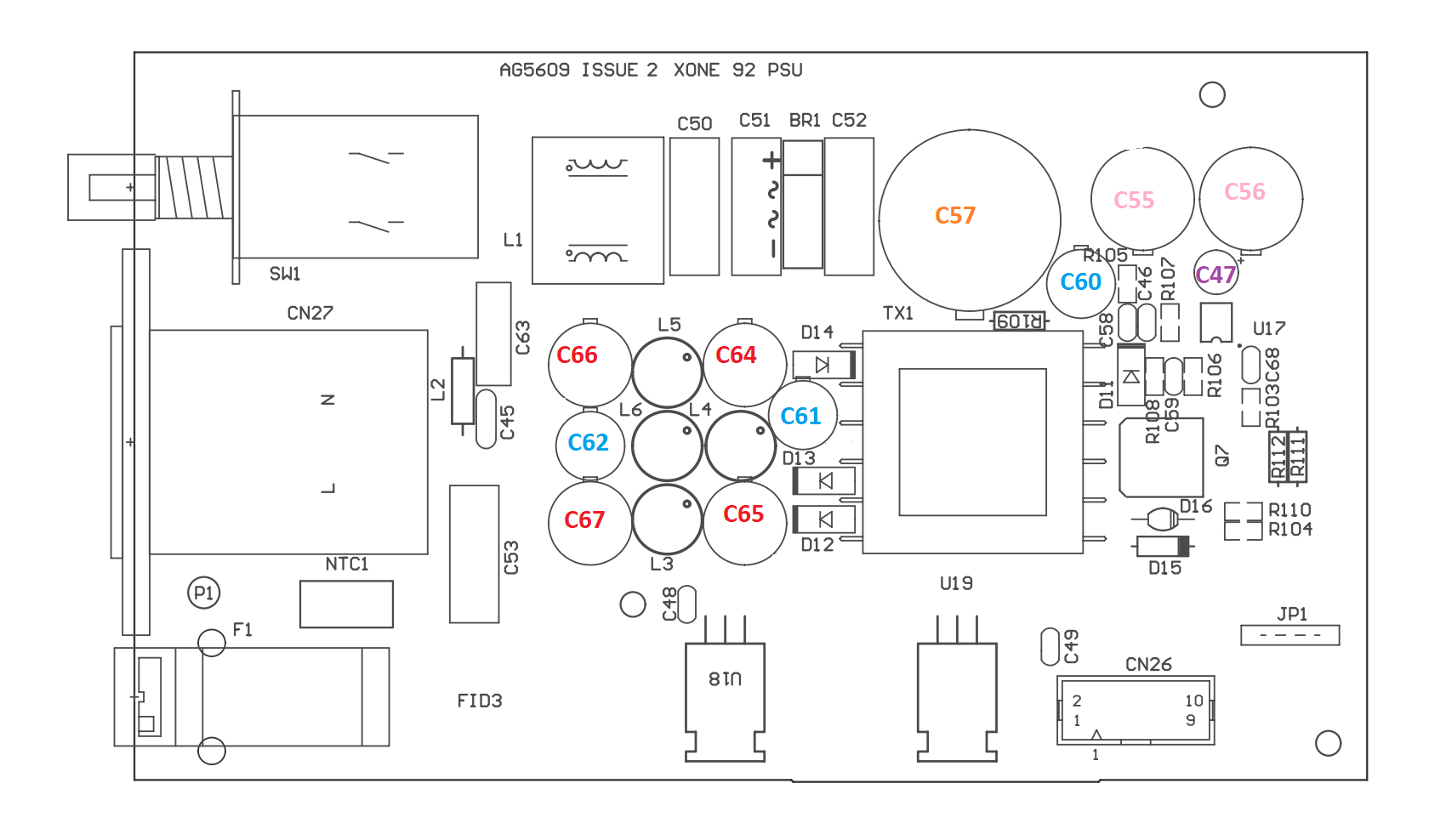

    I went ahead and got the diagram schematic, I am posting it below. The text with the same colours means the capacitors are the same in those spots.
    Are there any issues with me using caps with different heights compared to the original? Apart from them fitting in, I mean. The space in which they must fit is 35mm tall, and they would probably need to be a bit shorter for better cooling etc.

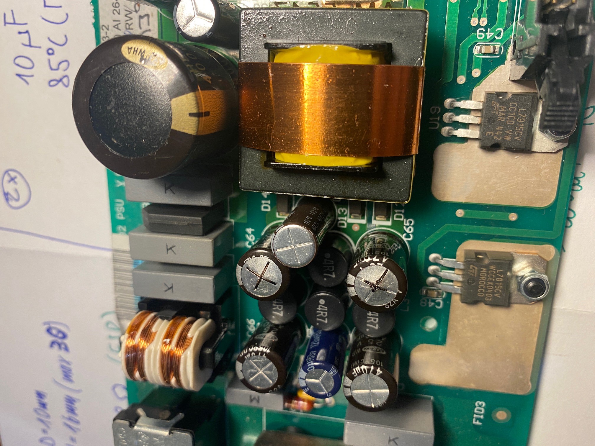

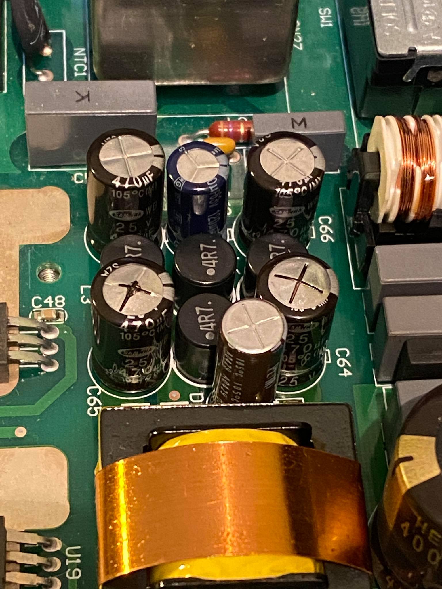

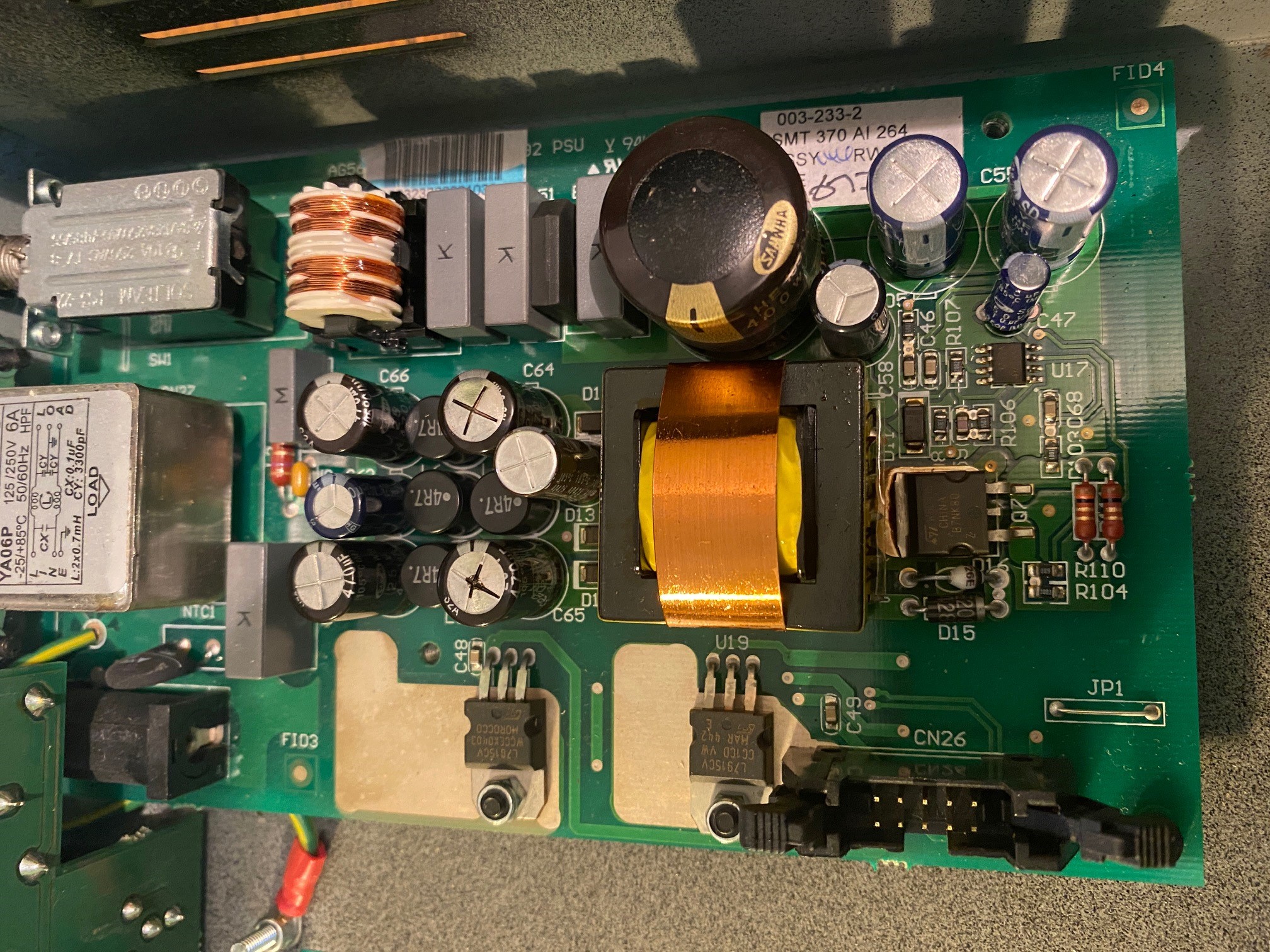

    If we look at the photos of the PSU, we can see 2 caps are bulging a bit, and seem to have some burned black stuff on the top. I'm assuming they are not working. Is the possible reason for this the cap on their right side, position C61? It is not the same as C62, and it should be. I think someone might have replaced this one in the past, with an incorrect one, causing the following two to burn?
    Anyway, here are the caps on this board:
    1) Positions C64, C65, C66 and C67:
    SAMWHA WB-series capacitors.
    25V, 470uF, 105°C, D=10mm, H=16mm.
    max impedence@20°C@100kHz=0.038 Ohms,
    ripple current@105°C@100kHz=1430 mA rms
    The replacement used in the old post was this:
    https://uk.farnell.com/rubycon/25zlh...25v/dp/8126461
    While the impedence of this replacement is 0.039 Ohms compared to the original 0.038, I am skeptical about the ripple current. This replacement has the ripple current written as 1330 mA rms, but the part it's replacing has a ripple current of 1430 mA rms. I think this would cause an issue?
    2) Positions C60, C61, C62
    JAMICON WG-series capacitors.
    63V, 120uF, 105°C (M), D=8mm, H=16mm.
    I am unable to find information about these caps, the only info available for this series is for
    63V and 100uF (impedence=0.274 Ohms, ripple current=550 mA rms)
    63V 220uF (impedence=0.142 Ohms, ripple current=920 mA rms)
    I am guessing, that if I try linear extrapolation, and assume a 120uF cap, that the result will be wrong? Maybe logarithmic extrapolation would give me the approximate value of my cap?
    Capacitance tolerance given is as +/- 20%.
    I do not know of any suitable replacement, the one in the old post was replacing a different cap than mine.
    3) Position C57:
    SAMWHA HE-series capacitor. Snap in type.
    400WV, 68uF, 105°C (M), D=22m, H=20-25mm (Not sure, slight bulging)
    Ripple current@105°C@120Hz=0.44 A rms=440mA rms
    Cannot find ESR values, capacitance change is given as +/- 20% from initial value.
    There was a Panasonic snap-in type linked in the old thread, but it is also discountinued now.
    4) Positions C55 and C56:
    SAMWHA SD-series capacitors.
    400V, 10uF, 85°C (M), D=10mm, H=16mm.
    ripple current@85°C@120Hz=115mA rms
    Cannot find ESR values, capacitance change is given as +/- 20% of initial value.
    This seems to be a suitable replacement to me:
    https://uk.farnell.com/panasonic/eca...0uf/dp/1907181
    5) Position 47:
    SAMWHA SG-series capacitor.
    50V, 10uF, 85°C (M), D=5mm, H=11mm.
    ripple current@85°C@120Hz= 72 mA rms.
    Cannot find ESR values, capacitance change given is as +/- 20% of initial value.
    This was posted as an appropriate replacement in the old thread:
    https://uk.farnell.com/united-chemi-...ial/dp/1220672
    This replacement has a ripple rating of 115 mA rms, where as the original had 72mA rms. I think this is no good.
    The last two capacitor types are rated for 85°C, but they are inside the same metal cover as the other caps, which are rated for 105°C. Would it be better for me to replace these with 105°C caps?
    I am also wondering how exactly would I test the ripple current of the PSU once I'm done changing caps, is just a multimeter okay? I will be getting an electrician friend to come teach me, since I don't want to get zapped by the PSU, but the reason for this project is also so that I learn something about board repair.

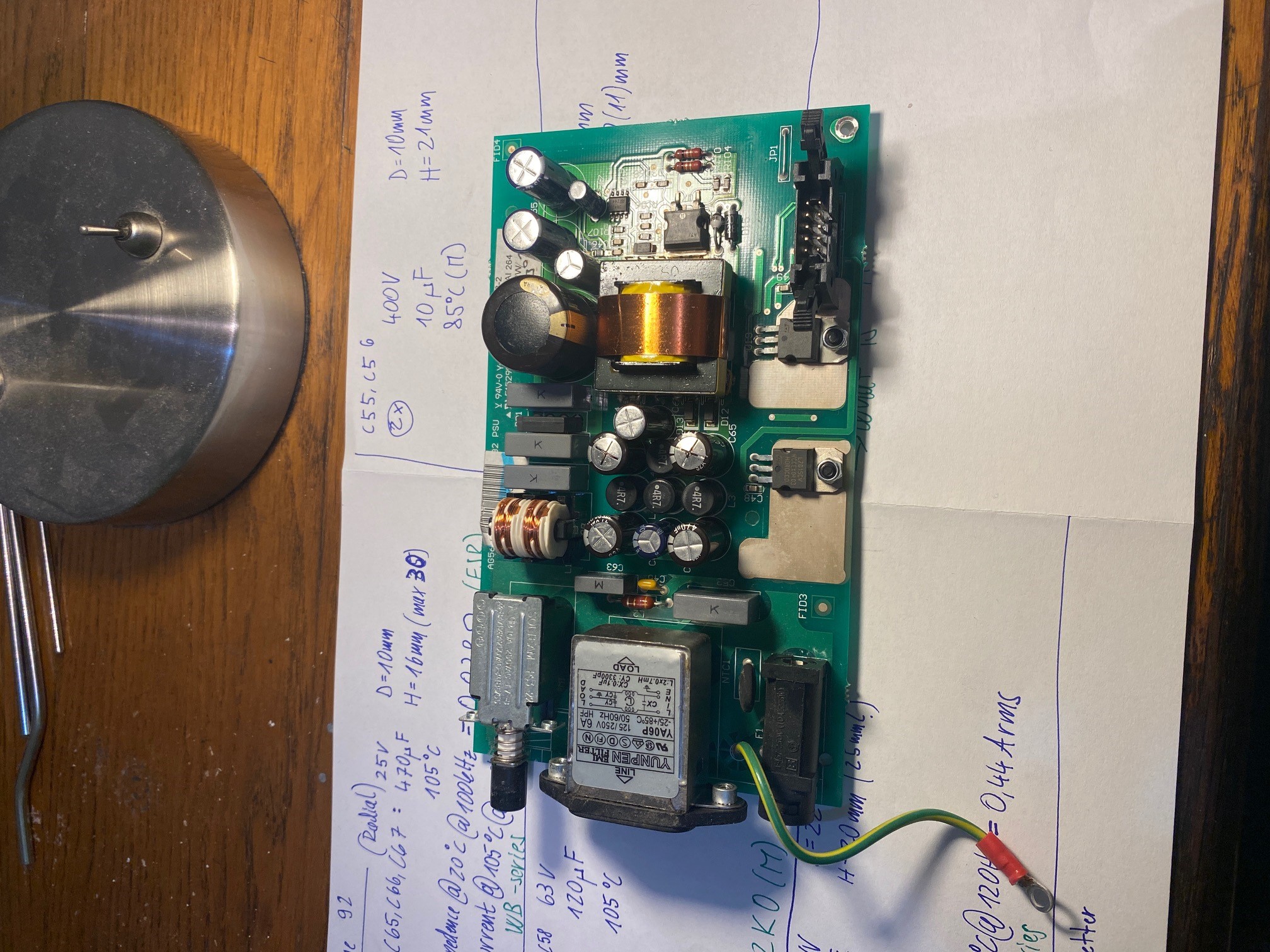

    Below are attached all of the pictures.

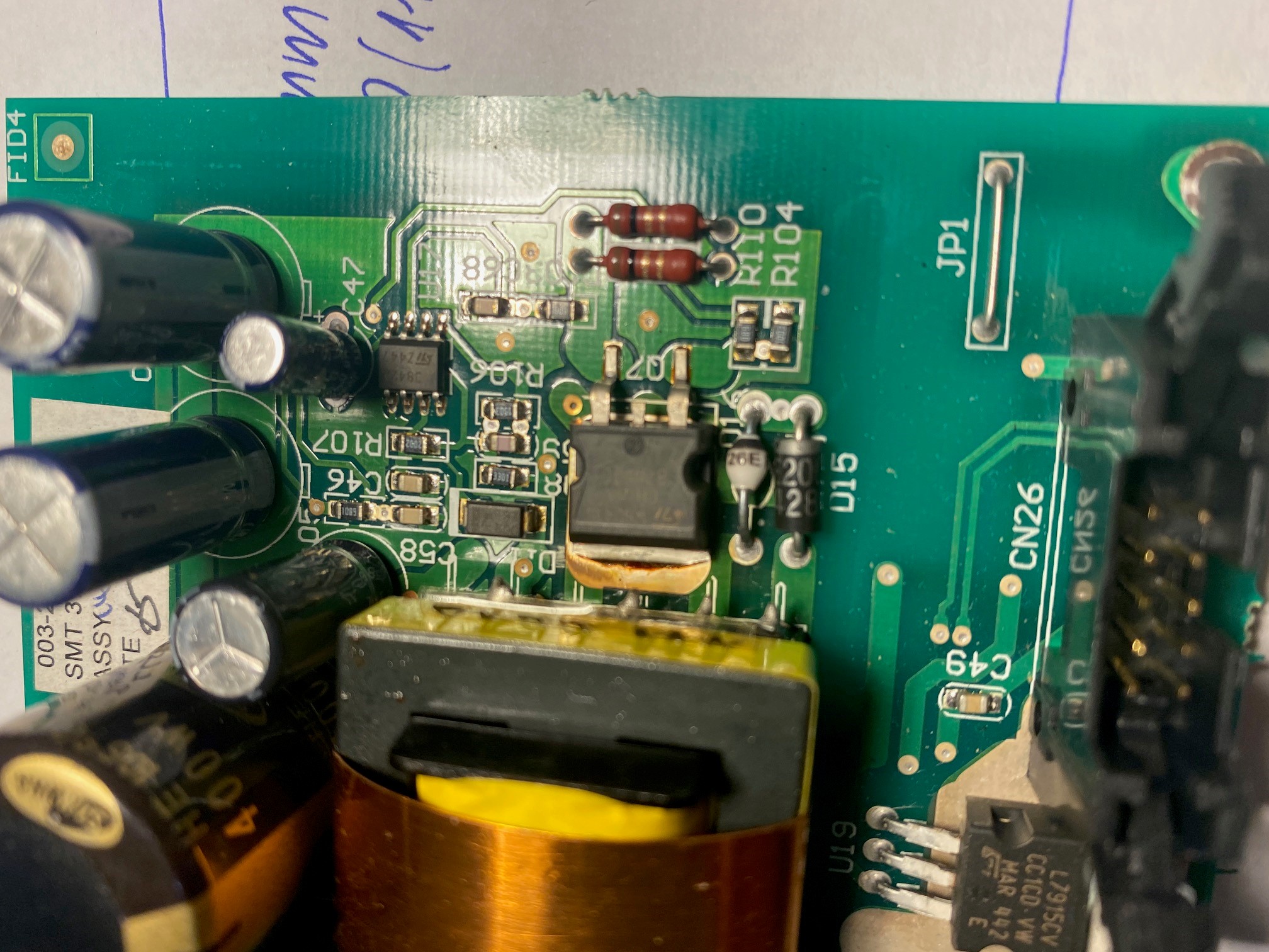

    PS. I forgot to ask about picture number 6. I'm not sure what that part is called, but it seems to have some corrosion there? I'm not sure what that stuff is. Should I try cleaning it?

          Alright, Q7 - the component from pic6 - no reason for worries here - just some flux leftover.
          What you have there is a just a switching mode power supply.. and not a fancy one.
          On the primary side ( the high voltage one ) I wouldn't change anything without prior measuring of the caps. Only C55 looks like starting to bulge ( compared to its neighbor ) but could be just the light and the angle.
          On the secondary side - yes, you have failed caps.
          If I was to do the repair for myself and did not have the means to measure the caps, I would just change C65 and C64. Would get anything decent that covers the specs and fits the spot.
          After that I would test the unit... and about the test - shorten one of the inputs and turn the gain, channel/master volume to the max.. then listen for noise on the headphones. If you can't hear a "significant" noise - job done.

                It's common to use the smallest capacitors possible to save money. But they run at higher stress (ripple current) and do not last, let alone the junk brands out there.
                C64, C65, C66, C67 - I would upsize them to 560uF or 680uF if the height allows it. They feed 1A voltage regulators so ripple current max would be split 1A/2 caps, or 500mA.
                C61, C62 - oddball 63V part on a 10V? rail. But same as C60, so they wanted to just use the same part. Again, it's OK to go up to a common value if size permits. 25V parts are fine on a "10V" rail.
                C55, C56, C57 - mains primary caps - they wanted a total of 88uF there, note C55/C56 have much bigger footprints, so again they could have used larger parts there. Even 100uF total is fine. So 68+22+22 I would consider if height permits.
                C47 is low freq, ESR not critical.

                    I realized the power supply has no feedback from the secondary ala opto and TL431. Instead it's regulating by the SMPS IC's supply voltage on the primary aux winding. I guess it would mean regulation can fail if C60 goes bad and overvoltage the secondary caps?
                    +10VM doesn't look like 10V for the sch drawn extra transformer turns, I wonder if it's phantom power. 25V caps for the 15Vreg input.
