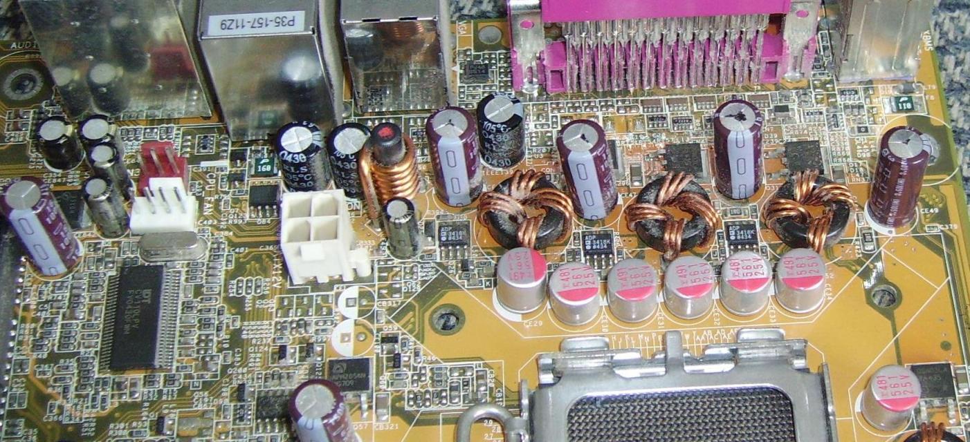

    KZJ suffer a bad fate too
    well, we still have some deer-lookalike psu with each rail using 2x 1800uF/16v KZJ and none of those PSU have failed yet. psu are some p4s and athlon xp in our net cafe. i glad i conducted that experiment in that 2006. it's been 3 years..
    days are so short when you actually do something..
    • yanz
      • Nov 2004
      • 910
      #42
      Re: For those that swear by KZG...
      only one is pic showing.. and i would like to know what capacitance and voltage are those black KZJ? usually chemicon use three line date code style, and those KZJ are just different, they use 2 lines...
      • yanz
        • Nov 2004
        • 910
        #43
        oh wait, maybe it just the angles..

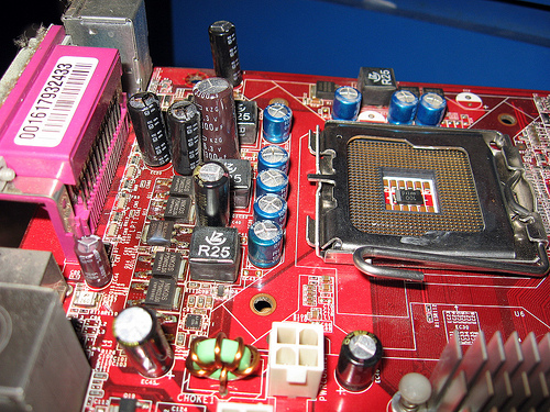

          #44
          These are some leaking Chemi-con KZG from a HP Motherboard. I replaced them with panasonic and the mosfets gave off smoke. I then discovered two pins on the CPU socket were touching!
          • 370forlife
            Large Marge
            • Aug 2008
            • 3113
            #45
            Yup, thats lga775 for ya. Great idea intel.
