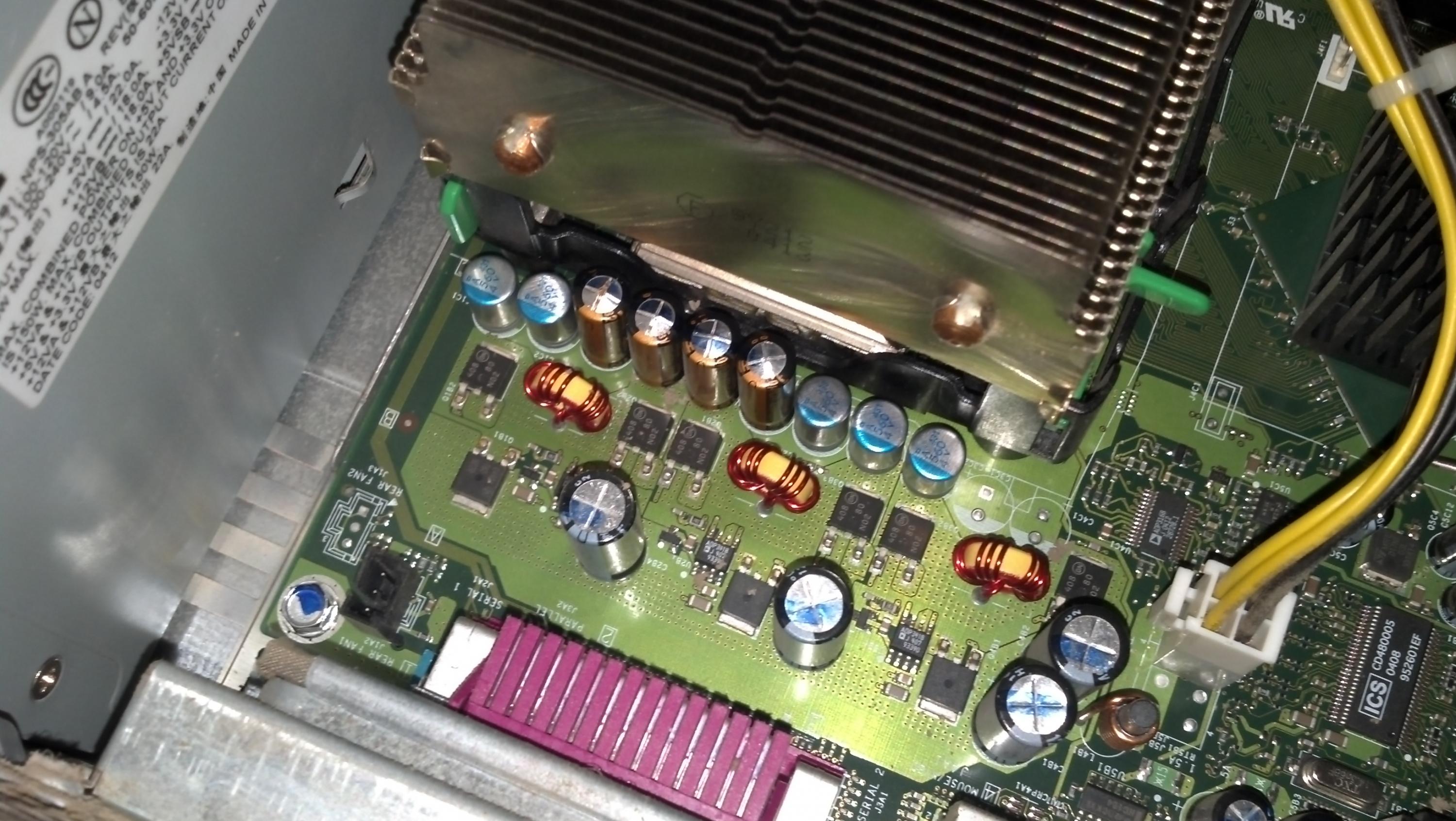

Hi guys, I have a Dell Precision desktop in the shop that has burst Nichicon HNs in the output side of the VRM. All other caps appear to be visually OK. All I've done at this stage is open the case and look around.
As you'll see in the picture they are four 6.3V - 820uF mixed with five 4V - 560uF polymers either side.
Now, I've seen this before on motherboards but with one electrolytic at each end of a row of polymers. It raises a couple of questions if I may...
1- Why ? What would be the purpose of the board manufacturer doing this ? Is is to effect timing? (though I don't think how this would make sense) or is it saving them a couple of dollars ?
2- Given the answer from 1- would it work to just put 4 polys in there or does it have to be the same electrolytics?
Thanks in advance for your input

higher end boards at 3x the cost with all polymer (plus the extra gadgets) seem to have set a precedent. But a lot of this just has to be more towards marketing besides cost (unless we're going to find in a couple of years they were using cheapo sub standard polymers?) Hopefully it won't be true and remain a benefit to consumers.
