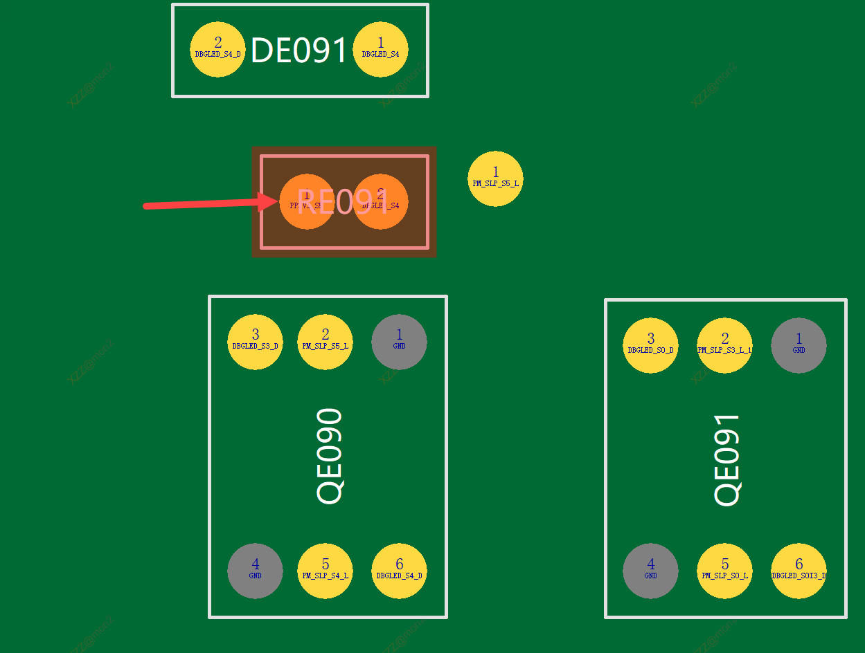

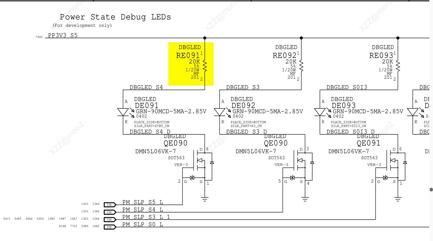

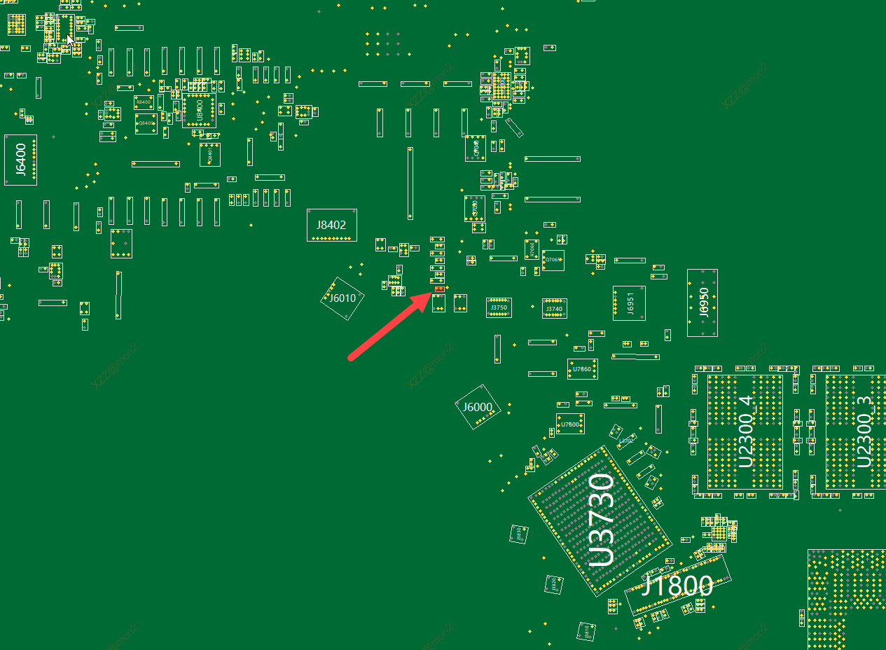

            Locate the debug led which are probably not stuffed but you can use the PCB pads to measure the PP3V3_S5 voltage to ground without removing of the logic board.

              very small PCB pad , but no voltage drop on PP3V3_S5 . Is there is a LED on the other side of the board ? So with a short on this circuit, it is more difficult to identify the source or should I remove the board ?
