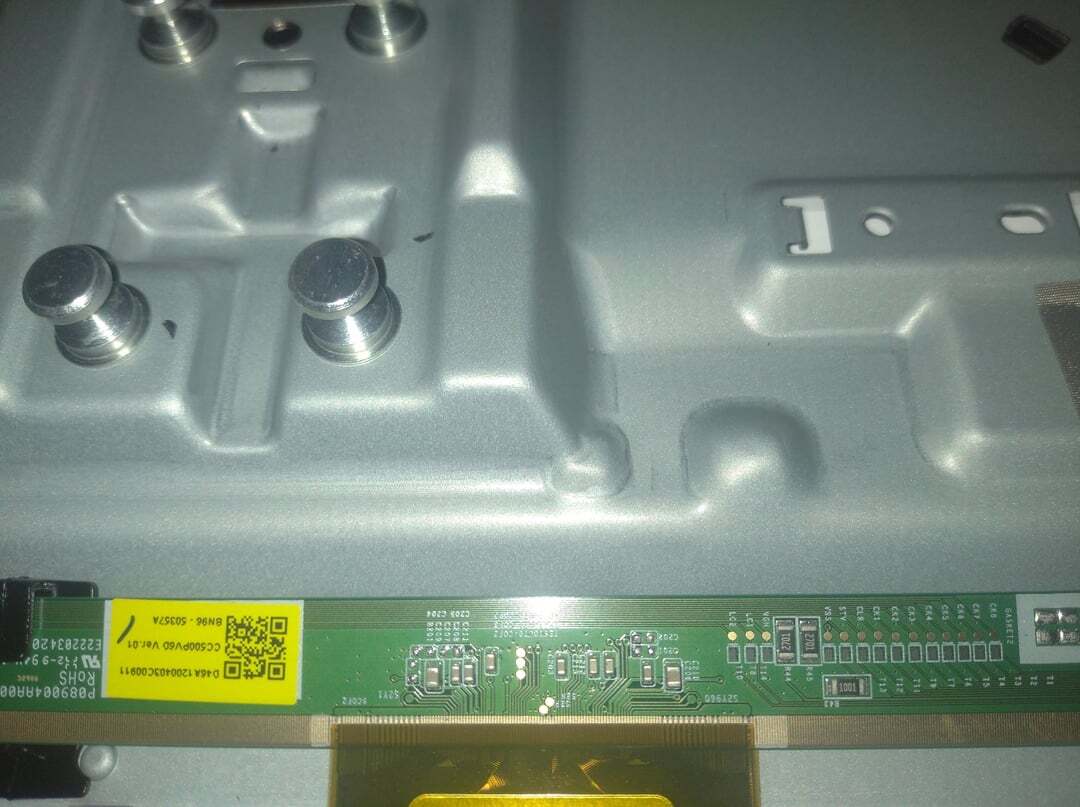

    Can anyone see the attached images ?
    What is the blinking code of your TU8000
    Been told at https://www.reddit.com/r/TVRepair/co...t=share_button
    The double blink code means there is a communication error in the tft portion of the display.

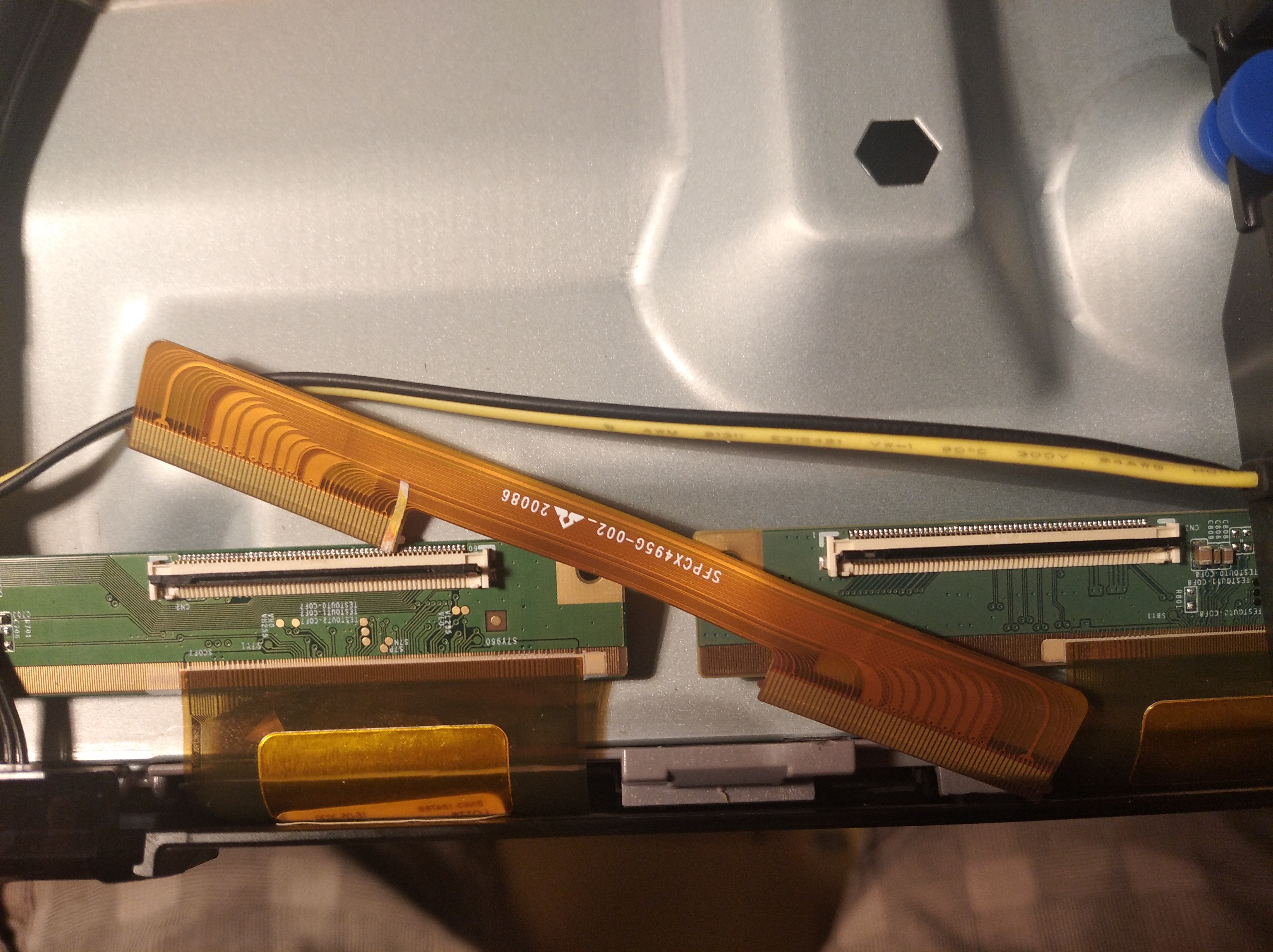

      May this help, I am also trying to troubleshoot a UE50TU8005KXXC that ships a CC500PV6D
      Click image for larger version  Name:	samsung-ue50tu8005k-black-screen-backlight-and-sound-ok-v0-g68j1lk1qref1.jpg Views:	27 Size:	74.2 KB ID:	3691521
      Your UE50TU8005K is probably similar to North America model UN50TU8000
      https://www.youtube.com/watch?v=6mm5zQSD_DM
      which has T-Con on main board, single flex to left panel board, flex from left panel board to right panel board. This kind of T-Con connection doesn't allow testing of left and right panel board independently so finding which side of the panel is shorted is difficult.. If fault is in left panel baord, there is no way to disconnect it and just test the right panel​.

        Originally posted by howardc64
        If fault is in left panel baord, there is no way to disconnect it and just test the right panel.
        I think have isolated the short
        It is the right side, I had to cover pin 1 and 2 with tape to stop the reboot loop.. but I have no idea of the pinouts of the middle cable that connect both side of screen
        SFPCX465G-002_20086
        On the left side ( SN2 near SCOF1), I had to tape pin 1&2 (on right side of connector) to enable boot to sound
        https://www.taobao.com/list/item/661546742557.htm

          Did you get a display or just quit looping?
          • rzr
            • Jul 2025
            • 7
            • fr
            No display, but i can see the backlught and hear the welcome sound and remote event
            See attached hack
