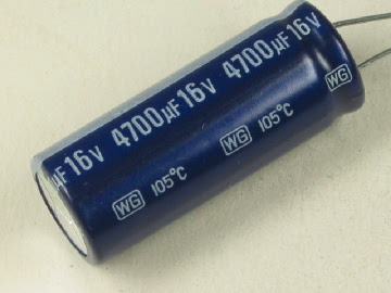

    need help identifying this cap
    Could anone identify this cap?
    may be an Sanyo WG?
    The pic isn`t from me, so no pics of vents or other markings are possible.

    Re: need help identifying this cap
    It has a honeycomb went so yes it could be a Sanyo, their larger caps does not have the K vent...
    Though I've never seen anything but Green Sanyos and especially not on the WG series...
        It is NOT Sayno WG. I guess it is a fake Sanyo caps. Where you get this picture?
          i believe it is a jamicon WG
          jamicon put the series letters in a box same as that. jamicon also have honeycomb vent
            Well thx for all the reply, i think willawake hase got the right answer. The pic is from the online shop system of an smaler elektronic shop in Germany. And they sell a lot diferent capacitors from difrent brands. They haven`t the complet offering from one manufacturer. And this makes it somhow dificult to choose the right caps. They don`t state the manufakturer, but most caps are easily identified by the markings.
            But as they sell many jamicon caps it could be that.
            But the spec of that caps isn`t that good. It has only 2,6a ripple current for that size. A MCZ with 1500uf could reach easily 2,770a.
            What is your opinion on that Jamicon cap? With the generall purpose caps and the high temp caps from Jamicon i have no bad experience. But never have seen any low esr typ from them.
              sure doesnt look like any sanyo i have ever seen.
                Jamicon WG in my addtronics psu
                the specs are worse than panasonic fc. MCZ is not available in so high capacitance so no point comparing them. they would probably be fine on mobo, definitely ok in psu
                we have seen some bad jamicons here i believe but i would not place them very high on the list of crap. those WG in my addtronics have been fine for a few years.
                    2.6A for a 1500uF, 16v low-ESR cap is not bad at all - and I haven't seen a single bulging large Jamicon. You should have no problems with that cap in a PSU or VRM I/P, especially when four are used in parallel.
                      2.6A for the 4700uf 16v actually. 1500uf 16v not available, only 1000uf 16v (0.076 ohm, 1.16A) or 2200uf (0.043, 1.89A).
                      4700uf 16v is also 16x40 dimensions !!!
                        Sorry, my mistake. However, 2.6A for 4700/16 is not bad - you can certainly use it on most PSU +12v rails, even better if paralleled. It's perfectly OK for VRM I/P caps.
                            Sorry I was drunk, the larger Sanyo caps use an X vent instead of K vent...
