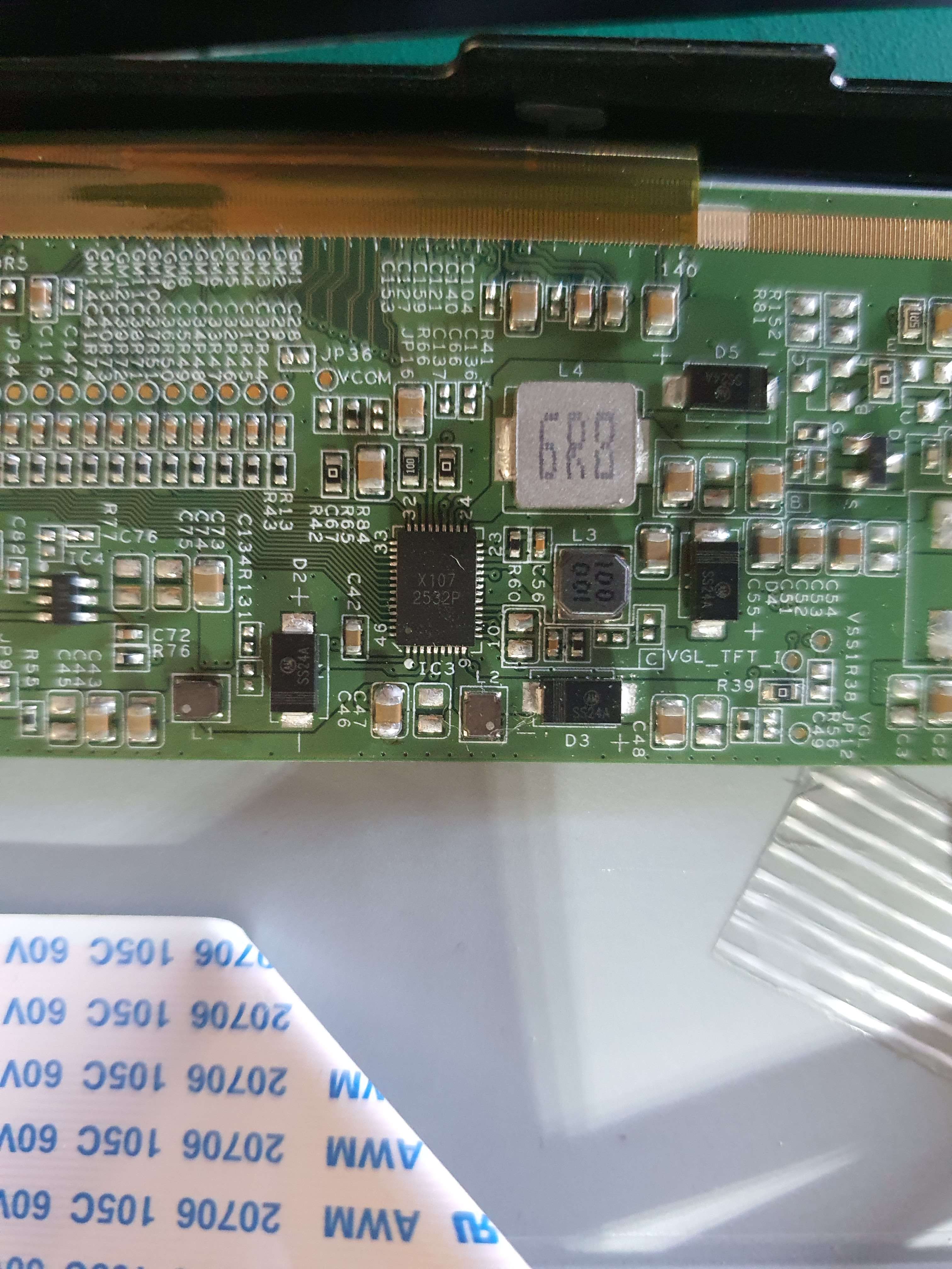

KOORUI 24E4 monitor with HKC HKM238Fj01 panel I need help with identifying TCON ic.
  • SendyCatKiller
    • Jul 2023
    • 4
    • Poland

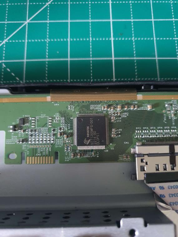

    Hello! I am looking for help with identifying this tcon chip on KOORUI 24E4 monitor.
    Driver board number: pn238ct01-3-xc-2
    Other IC on the driver board: NT71265MFG-001
  • SendyCatKiller
    • Jul 2023
    • 4
    • Poland
    Update for those who find this thread looking for answers:
    There are couple revisions of this monitor I bought a broken one for super cheap hoping it would have the same panel but they have different panels inside.
    The one with broken TCON has a barcode with CF5H979XXXXXX and has HKC HKM238FJ01
    The one I got broken has a barcode QB4V985 and has HKC HKM238FC01 panel
    The difference also comes with power supply. The 1st one has 1.5 A power supply, the 2nd one has 2.5 A power supply.
    Tcon inside is different, it has SG2381B01-2-xc-3 driver board with CSOT CS603 and himax chip. (damn if only I got this revision instead, would be a simple fix)
    Looking through auctions barcode is pretty consistent across these, I already found two with the same barcode as mine so if I get them I will update this post for ones who need it.
