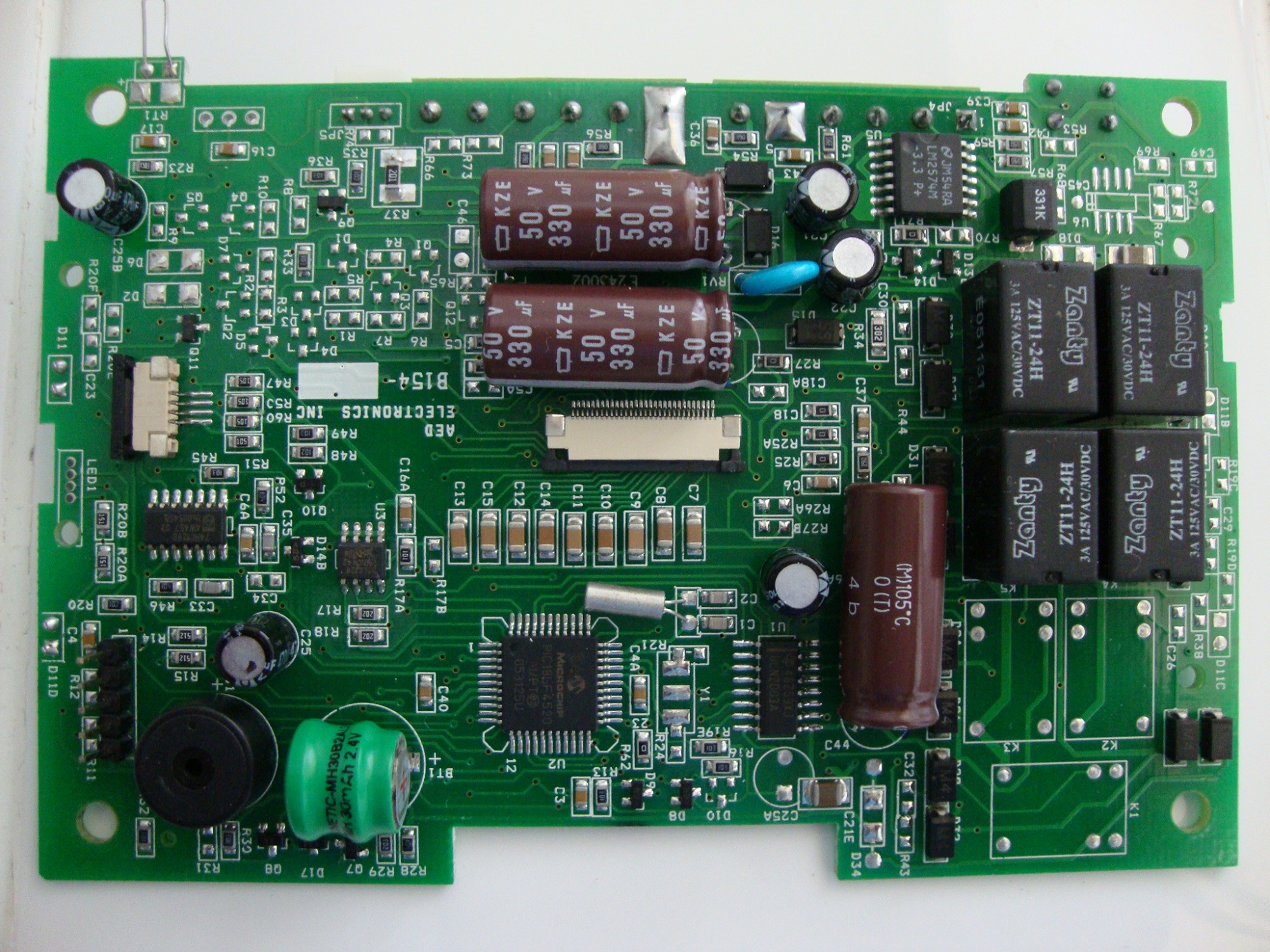

                                    The item in question is a touch screen thermostat, sorry PC you guessed wrong . Two of the five caps are side by side and in a cramped spot so a 8mm will not even fit but the others have a little wiggle room.. Stay tuned for the pics when I get home in the morning.
                                      Re: Help me
                                      As promised here is the pic of the entire board
                                      jsog the caps have no other markings except for what I have already posted and the temperature rating which is -40+105 C. I checked each one and nada
                                        Re: Help me
                                        Are those KZE original because they are laying on SMD parts and don't look like they should be there.
                                        Also doubt that board has 50v on it anywhere.
                                        I'm thinkin' someone used whatever they had laying around.
                                        Looking at it I think for the caps you asked about I would try the LXZ.
