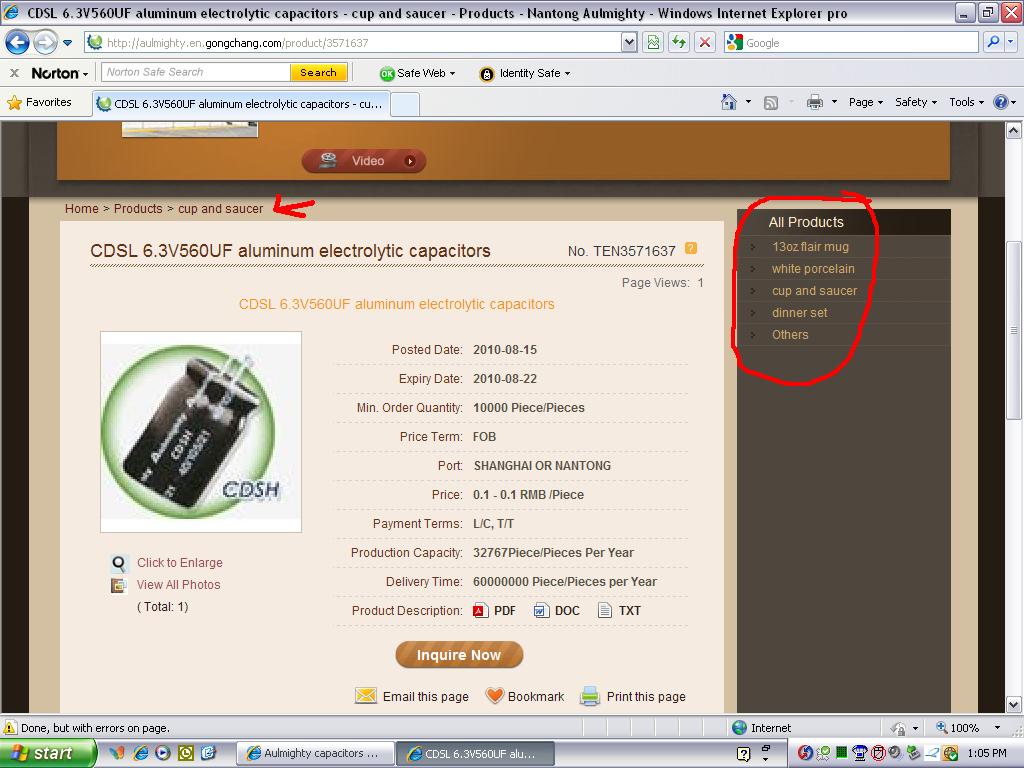

    In my ongoing effort to recap the various electronic devices featuring 'lytics, I came across these "Aulmighty" caps in a Siemens Gigaset SE567. The board is a hodgepodge of cap makers, ranging from Nichicon (VZ) and Panasonic (NHG) to G-Luxon (SM) AND Aulmighty "CD268" & "CDSL". I was able to find their website, but their datasheets are for shame (see 6973542 & 5346311 PDFs below). However the CD268 seem to be a series from more than one cap manufacturer (see CD268 & cd268-2 PDFs below). Perhaps they are Chinese government issued design? The 6.3v560uF CDSL cap is bulging and will be replaced; the (5) 25v1000uF CD268 caps aren't but will be replaced regardless. I'm using Nichicon VZ and Panasonic NHG caps as a baseline for replacements as they are quite similar to each other. From the datasheets I've found for CD268 caps, they seem close to VZ and NHG caps in ripple (no value for Z/ESR). The question is the CDSL cap; it's right next to a choke coil, so I suspect it's doing filter duty (which is why it's probably bushy-failed). I'm thinking it would be good to replace this cap with a low-ESR cap?
    So:
    Does anyone have "real" datasheets for Aulmighty CD268 and CDSL series capacitors?
    Is the CD268 a common series among manufacturers (Chinese)?
    Do you think the CDSL was meant to be low-ESR?
    I know the answer, but do you need pictures?
    Were you laughing at the Aulmighty website too? Or just their datasheets?

    Electronic meter long life electrolytic capacitors with high frequency We are Nantong Tianli Electronics Research Institute,/ Nantong tianzhili Electronic Technology Co., Ltd., specializes in producing high-grade aluminum electrolytic capacitors, we are the designated supplier Siemens. Although the days of power companies do not, but the quality is definitely first class Days of power management concept is: not the biggest, but the best; others do not have, people have my spirit; your needs, our pursuit of We look forward to the opportunity of co-operation, we will sincerely serve you In order to meet international market demand, I launched a full range of environmentally friendly aluminum electrolytic capacitor to satisfy the export demand for voltage: 3V ~ 500V, capacity: 1UF ~ 1F Look forward to your visit! Firmly believe we will win tomorrow!

      Ha, ha, ha would you like some white porcelain with your capacitors??? Thinking maybe they should work on their Engrish! In fact I was making an attempt to understand the company name which I've come to the conclusion they meant to spell it "Alumighty" (as in aluminum electrolytic), but instead their Pinyin pros misspelled it Aulmighty.
      To read the PDFs, you have to install Acrobat's "language pack" to view. Ironically, once I did, I discovered there weren't any Chinese characters to be found. Did you try looking at the ones I posted??
      I'm fairly certain the CD268s are similar class to VZ and NHG series caps (albeit with slightly less ripple handling ability), but I was most curious about the lone CDSL cap on this board because it is right next to an inductor (or choke coil, which ever you like). That seems to suggest it's being used as a ripple filter, which would suggest the possibility of it being a low-ESR cap.
      And I know that 2 letter series descriptors like SM across brands coincidental, but CD268??? I've come across several brands with a CD268 series. Odd?

        I didn't want to instal the language pack. The two you posted require the language pack as well.
        A lot of Chinese cap brands use CDxxx series numbers.
        I ththought the brand namewas supposed to be "Almighty."
        Try using a low ESR cap to replace the CDSL. All the site says is that it is rated for high frequency filtering.

          The 'old name' for capacitor was condenser and the old name is still used in some parts of the world.
          CD268 just means Condenser [CD] - model/series 268.
          That naming convention is not too uncommon from small companies.
          If they cross from brand to brand it's just by chance. - Don't count on it.

                Presumably referring to the attachment from LTI in post #2

                  I think there is at least some similarity, for example CD17 is always Photo Flash capacitor series:
                  http://www.jianghaius.com/Pe/CPML1.htm
                  http://www.js.cei.gov.cn/jsmeio98/0600008/entdrqcq.htm
                  https://cdn.badcaps-static.com/pdfs/...50849d2066.pdf

                    The rest of the title was cut off. It is actually "Windows Internet Explorer provided by Qwest." The Qwest setup/diagnostic software changed the title. It isn't Internet Explorer Pro.

                      Yet in this brand they aren't even lytics.
