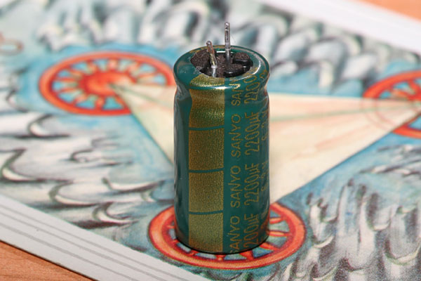

    I need some pictures to identify Sanyo WG caps
    If any of you have have a sanyo WG, please post a picture here. I need to see the font, the bung (bottom seal), and the top.
    I have the CA series, generic, and WG Sanyo caps and not all that have the same bung..!! There is high probability that they are original (pulled from some powercolour vga cards).
    Thanks in advance...

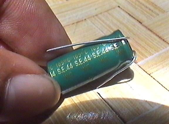

      Wow... I really appreciate your response!!
      There's two flavor of Sanyo WG I got from the retailer shops (they gave me free samples). The one is exactly the same with yours, nothing different except mine is with S.E.44, the looks is also decent.
      Sanyo 3300uF 6.3V
      105C
      S.E.44
      WG
      (10x23mm)
      (forgive my dirty fingernail )

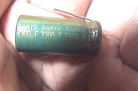

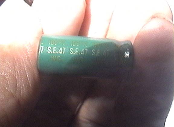

      The second, almost nothing different. The look is good, the same with the first, but the bungs are different. They are in 3300uF and 1500uF:
      Sanyo 3300uF 6.3V
      105C
      S.E.49
      WG
      (10x23mm)
      Sanyo 1500uF 6.3V
      105C
      S.E.36
      WG
      (8x20mm)
      Since I know that my trusted Sanyo CA (1000uF 6.3V 8mm, pulled from powercolor vga cards) isn't fake, I think the 8mm 1500uF WG isn't fake too. Its bung isn't special because it's < 10mm diameter. I know that Panasonic FC caps are also like that.
      Now the question is why are there two version of 3300uF WG (10mm diameter) which different on their bottom seal? Is it counterfeit?
      What i think:
      - Maybe because it has different number, so the latest (S.E.47 & S.E.49) have no special bung compared to S.E.44 (yours is S.E.38)
      - They all came in one box/packet that the local shops received. So if one is counterfeit, then the others (which is identical with yours) is counterfeit too. Or both are original but have different batch manufacturing.
      - I am a short mind guy so I just installed three caps to my abit KT7 boards, running duron 1200 at 1350, perfectly fine. vcore and 5V are stable recorded with speedfan.
      - I install 2 of them (3300uF 6.3V) to my Tt 480W Purepower w/APFC, the result is good, no problem appeared on voltage rails or vcore, running full load/benchmark perfectly fine.
      - Their dimension matches the spec/datasheet.

        Re: I need some pictures to identify Sanyo WG caps
        and sorry for late reply. i just want to make sure my rigs running fine for more than 1 - 2 days...
        Maybe I only see what I want to see, but this time I think they aren't fake (not like my fake rubies YXG, damn...). Maybe I should pour my abit boards with more of them, I may do that later.
        I am still interested in what you think...

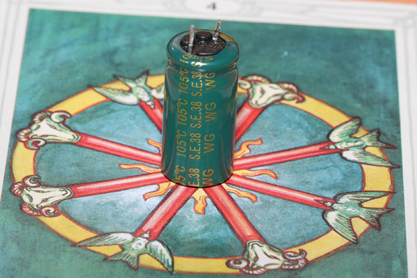

            Hi!
            I own a EPoX 4PEA+.
            I removed the 3300uF, 6.3V, SANYOs WG and their bottom has two "flavours" like on the pictures that were posted:
            1st "flavour" -- flat bottomed;
            2nd "flavour" -- "T" bottomed
            Also, did you mention fake Rubycon YXG? I've received from EPoX.NL some 1000uF 6.3V YXG Rubycons with dimensions 8x13mm different from Rubycon datasheet (10x16mm). Were your fake Rubycons 8x13mm also?

                i think the s.e. is a datecode on the sanyo parts.
                i have lots of rubycon yxg 3300@10 and they came in a heatsealed bag with yellow/clear rubycon logo and a yellow block with part number/qty stamped in black
                the part number on these is rs-118
