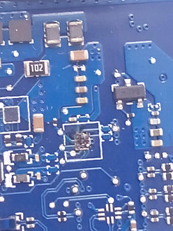

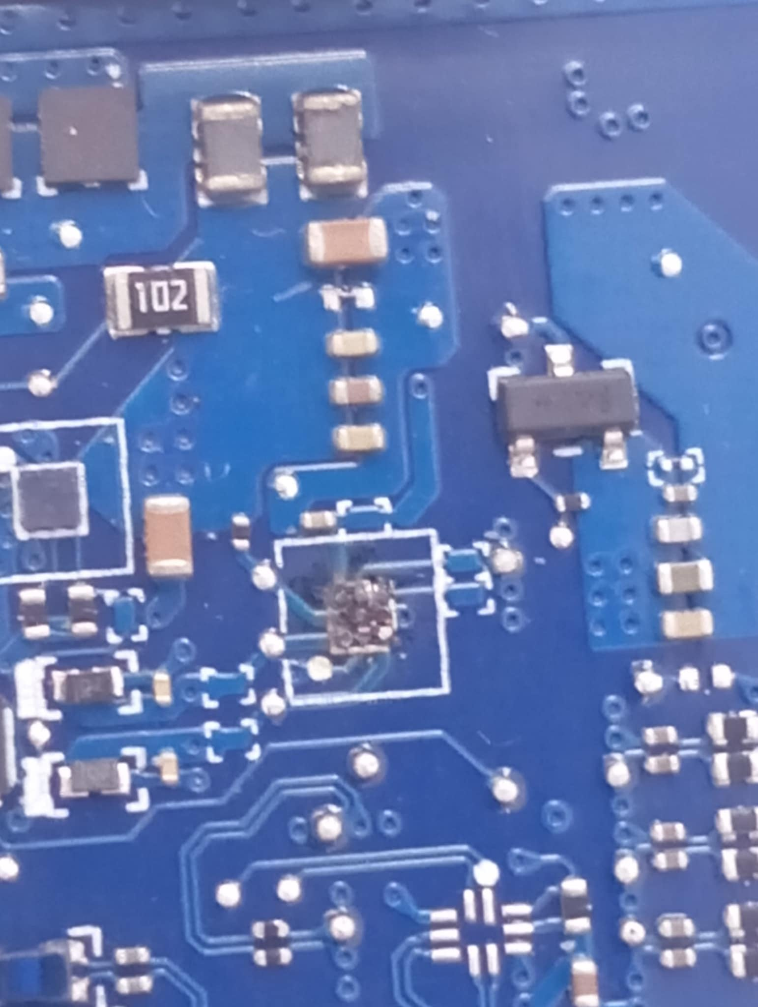

    I am trying to identify a component that was burnt on this board. I can't seem to find a good image of what this was.
    I will upload here the best i can get but ill start with the unit itself.
    Its a Huawei Matebook D14 Ryzen 7 4700U Variant
    The board is a DAH98AMBAD0 Rev D
    I have a few pictures that may help us find out, (I tried digging online but i can't seem to find the value. Maybe someone can help me out here)

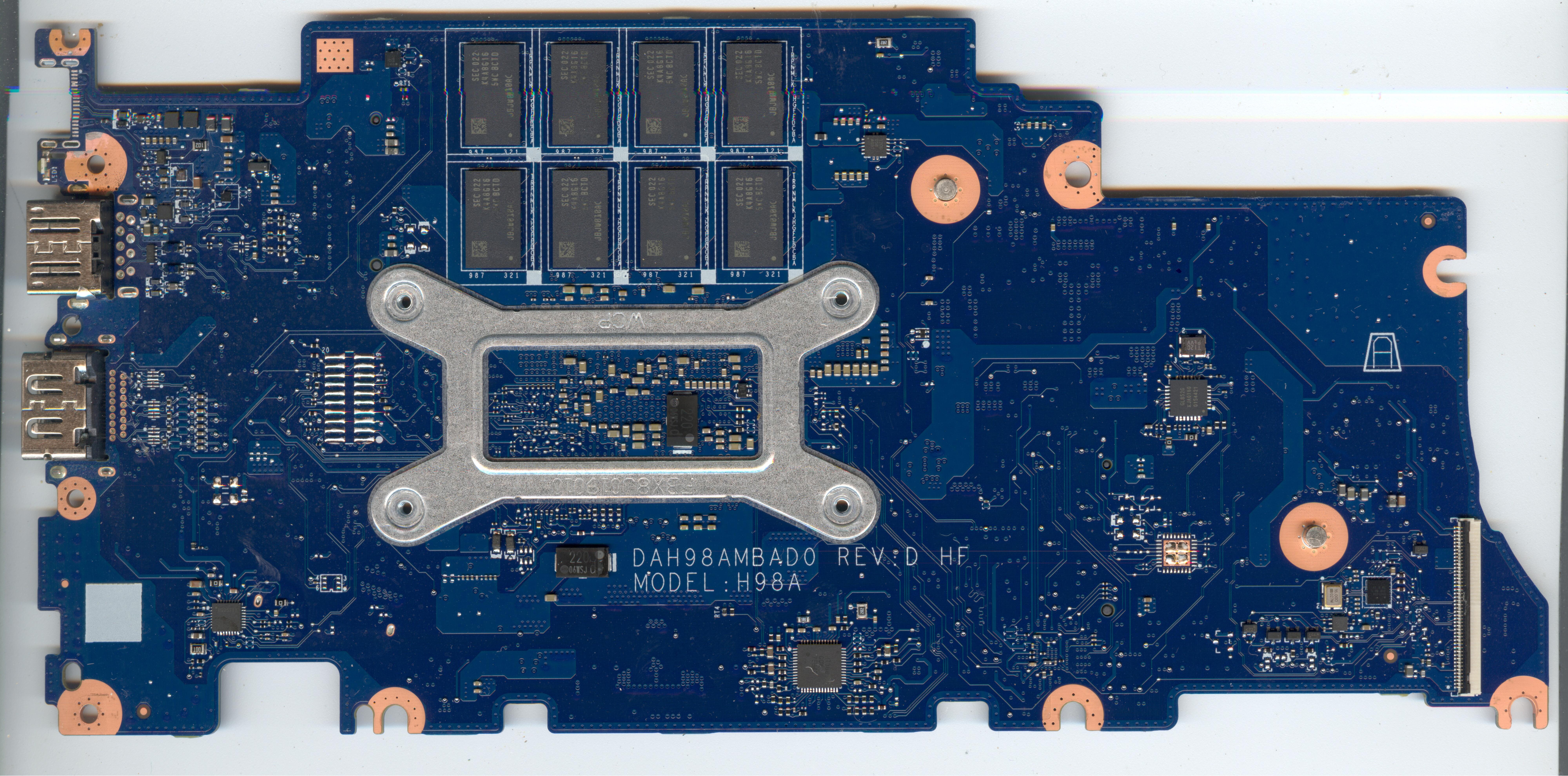

    Here's the full size board for your reference.(attached below)
    Here's the Hiroshima picture
    Click image for larger version  Name:	burn.png Views:	0 Size:	1.60 MB ID:	3711436
    I have searched the web for the closest thing to this and i found this.
    Click image for larger version  Name:	464.jpg Views:	0 Size:	163.8 KB ID:	3711437
    when i zoom in the HD picture(which i have uploaded below) i see it kinda says "464" but im not sure if it was.
    Please help. Badly needed.

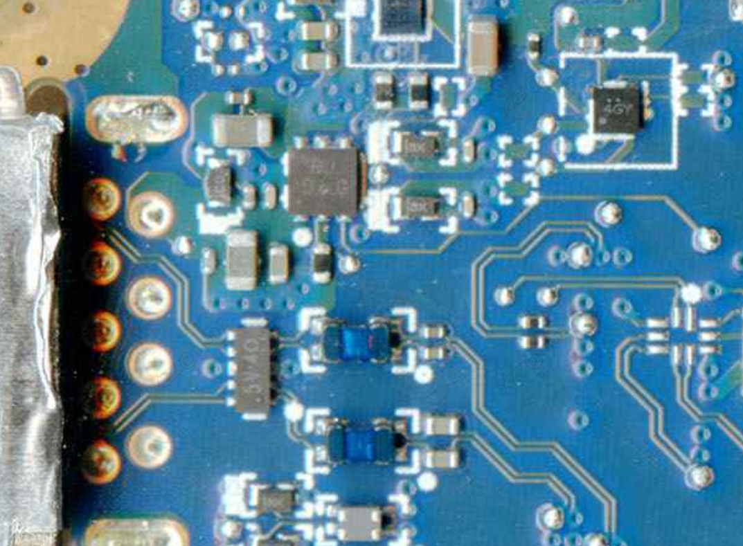

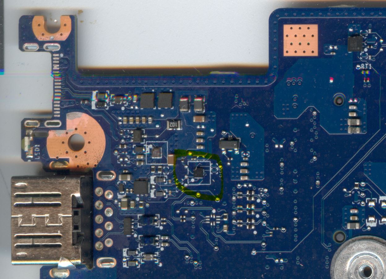

    More clues..(suspecting this to be a USB load switch for the VBUS line or similar)
    From my database of board pics - has '4GY' with the 2 dots.

      Could it be a RT1711HWSC
      • mon2
        • Dec 2019
        • 14863
        Nice find R_J !! You are a parts hound.

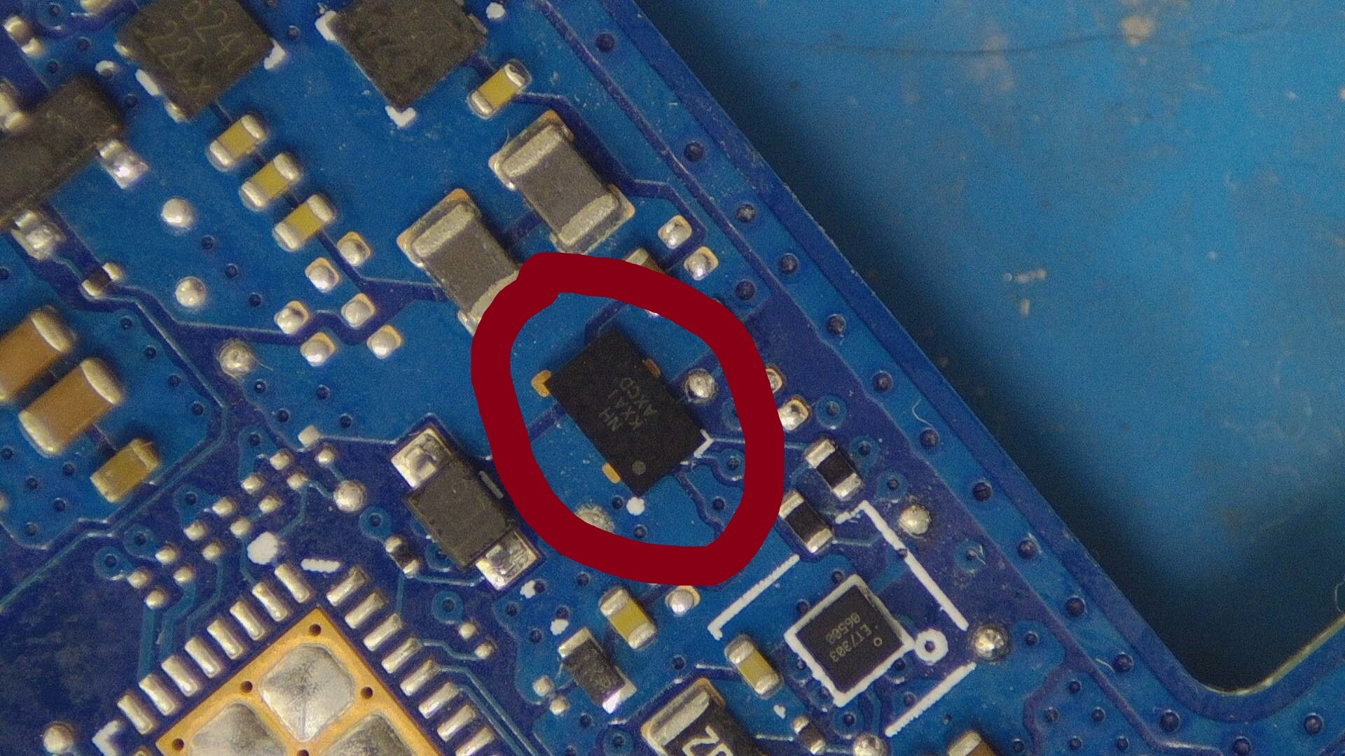

          Can someone help me identify this IC? motherboard dah98ambad0 hiawei matebook D15
              Sorry, I didn't realize there was more than one ic in the photo.
