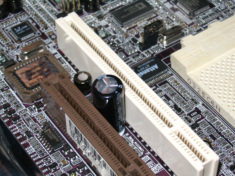

    Could this problem be due to a bad cap? [pic included]
    I have a little Soltek QBIC 3701M SFF PC (circa 2003) used as a media center PC in my living room. Being small form factor, it's expansion options are limited, and it only has one PCI slot and one AGP slot. The PCI has a digital TV card in it, and about a year ago I got a Leadtek FX 5900 XT to fill the AGP slot. Well, the card worked OK but there was some glitching when changing channels with the digital TV card.
    I thought it must be power because at the time it only had a 200W PSU, and when I tested the system with an external 350W PSU plugged in to the GPU, the glitches seemed to go away. So I set out to find a higher power replacement PSU, which turned out to be an extremely long and difficult exercise since it uses a very uncommon long thin form factor of PSU (FLEX-ATX).
    Eventually (after many months of searching and e-mailling) I discovered that the Shuttle Silent-X PSUs, although 4cm or so longer, would fit in place of the Enhance 200W, so I ended up putting in a Shuttle PC40 250W PSU recently, which works well. However, when I put the 5900 XT back in, it wouldn't work correctly -- as soon as Windows loads the drivers, it hangs or BSODs. It boots up fine, BIOS works and *most* of the time, safe or VGA modes work of Windows, but as soon as it boots proper, tries to load (or even install) any of the ForceWare drivers (I tried 6x.xx, 7x.xx and 8x.xx series), it crashes. Sometimes Windows will almost load the "Welcome" screen but it hangs after a moment and you see some display corruption (odd pixels here and there). So I purchased another card, an XpertVision 6200. It had exactly the same problem, yet both of these cards worked fine in another system. Oddly, an old GF4-4200 worked fine.
    Interestingly, ATI cards seem to work fine also - a 9800 Pro, a 9600 and a 9550 have all worked fine in this PC (yet, all of the cards that work correctly have terrible quality TV-out compared to the nVidia, and since this is used primarily for digital TV through s-video, it's kinda a backwards step). It seems modern nVidia cards refuse to work on this box, yet the 5900 XT *DID* work in the past, even with the 200W PSU -- which I tried again in place of the 250W -- it just refuses to work *now*.
    I tried everything, and I mean everything to try and get the cards to work, formats, reinstalls, different drivers for GPU and chipset, older service packs, bios settings, mobo jumper settings, removing hardware, IRQ settings, removing/reseating/swapping RAM... nothing works. Eventually I wondered if I might have a bad cap issue... I looked over the board carefully with a flashlight, and it seems most caps appear to be Sanyo with a K vent and are not bulging, and I also could not see any leaking electrolyte. However, there is one cap with an X vent wedged in between the AGP and PCI slots that looks very suspicious to me, I cannot see any leaks at the top or underneath, but it definately looks like it's bulging... I can't quite see the make of it but it also looks like a Sanyo?
    Here is a detailed pic:
    OK... so, does that cap look bad, and could it be causing my problems? (and if so, why is it only modern nVidia cards that are failing yet ATI cards -- including 9800 Pro -- work fine?) What do I do now? :\

    Re: Could this problem be due to a bad cap? [pic included]
    OMFG, the Holy Bible!! J/K
    From the pic, there's no doubt about the bad capacitor though. Replace all 1000uF and up.
        That capacitor is definitely bad.
        And it is definitely not a Sanyo, I would bet on it being a GSC capacitor, I'm holding a GSC in my hand right now comparing with the pic you posted and it looks exactly the same, that logo on the stripe, the GSC name should be facing the AGP slot, and the farad and voltage rating should be facing the other direction (the white populated PCI slot)
        It is most likley the cause of the problem; either the other cards has better power filtering on their own or they consume less power which this bad cap is still able to provide...
        If the other capacitors are not of this make but Sanyo (which is a excellent brand) only swap this one out... But take the mobo out of the case and look it very carefully over so you do not miss another bad cap...
          That cap is definitely NOT a Sanyo. Sanyo/Nippons have a "K" vent. As mentioned, thats a GSC or a Lelon most likely.

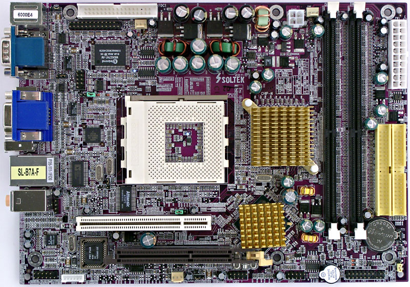

            Here is a high-res pic stolen from ixbt.com that shows that indeed all caps except that one between the AGP and PCI slot is a Sanyo... There are also 4 Panasonic T-Vent caps on the top of the board used for the input side of the VRM circuit that are most likley just fine too...
            The smaller caps below 500uF on the board can be pretty much anything but are probably fine too, just swap out that cap between the AGP and PCI slot and you should be fine again...
            http://www.ixbt.com/mainboard/images...7a-f-board.jpg
            EDIT; After washing my glasses I now see another crap cap right between the south and northbridge on the mobo...

                Meh, I'll steal it for real instead of hotlinking then
                Image source
                • {RainmakeR}
                  • Jan 2006
                  • 10
                  LOL... good find... well there you go guys, that's my tiny mobo... I'll have to check that other one in-between the bridge chips closely. Hopefully it looks like there won't be that much to replace, I let out a sigh of relief when I saw most were Sanyo's. Wow this forum rocks, you guys got straight onto this and are obviously very knowledgeable, thanks!
                  P.S. I'm crap with a soldering iron so I hesitate to do the replacing myself... any ideas? I'm in Australia, perhaps I could find a local electronics tech that could do it?

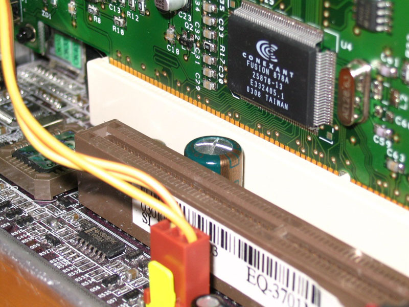

                            Thanks, I will look for it. BTW, just a followup, I just looked at the board again with the flashlight, turns out the other dodgy cap in the motherboard picture above is actually a Panasonic T-vent cap on mine, and where the Panasonic T-vents are on the picture are actually more Sanyo K-vents on mine. So.... hopefully only one to replace then!

                                Well, I took the motherboard to a local electronics technician this morning (wouldn't trust myself to do the replacing), and seriously in less than a minute he had it replaced with brand new cap rated at 105C, 2200uF 16v:
                                Just reinstalled all the hardware, and guess what? VIDEO CARD WORKS ABSOLUTELY FINE!!! YAY!!!!!!!!!!!!!!!!! He didn't even charge me for the work, just 90 cents for the capacitor! He even used an air compressor to blow dust off the mobo while I went to get the capacitor from a supplier (he didn't have one thin enough for between the slots). To say I'm happy now would be an understatement.
