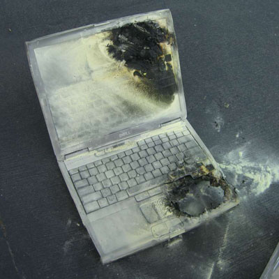

    Re: Dell laptop batteries Getting closer to the truth+other tid bits
    Interesting - from the descriptions of the burn patterns and locations, I suspect there are multiple/combinations of issues here:
    1) Poor quality Li-Ion batteries - probably from 2nd and 3rd-tier Chinese sources. I'm still running an old Latitude CPi on its original, 6+ year old Sony OEM Li-Ion battery, so it's possible that switching to lower-cost suppliers has taken its toll.
    2) Higher power dissipation from the use of desktop P4 CPUs in notebooks - the Inspiron 1100 and 5100 come to mind. Intel and its Netburst marchitecture are the main culprits here.
    3) Excessive stress on the VRM and other power-conversion/charging circuitry - the high failure rates on the Intersil power IC on the Inspiron 1150 is a case in point. Possible contact issues from the newer higher-current jack/socket could also be contributing to arcing/local overheating.
    4) Not specifically identified, but bad capacitors could have a role as well.
      Two of my Dell1150 boards have badly discolored caps and the Intersil control chip has shut down, actually blew open on one.
      I'm very familiar with this issue.
      I have four Inspiron batteries next to me that are all fully charged, operate for about two hours and are of unknown age but OK.
      Some think that blowing compressed air into the exhaust port gets the crud out.
      In fact this only compacts the dust wad into the fan more, causing more overheating.
      And don't get me started on the missing rubber feet, these must all be there for bottom clearance.
                considering these laptops and mobile phone batteries catching fire, it would be clever to choose a location away from any flammable stuff. like i had been charging my mobile overnight on top of a stack of VHS cassettes, probably not a good idea.
                thinking about the Dells though, imagine your laptop catching fire like the one in the picture while you are on a plane
                  Along with that burnt up picture there is a series of shots that show the actual burst, flame ball, and fire.
                  Group of guys are standing there about 10ft away and one ran for the fire extinguisher.
