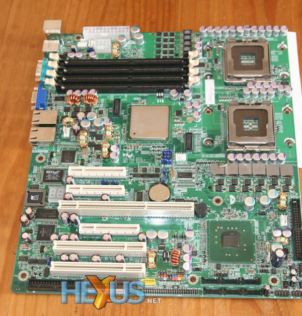

                                        lots of polymers on this board for dual dualcore xeons
