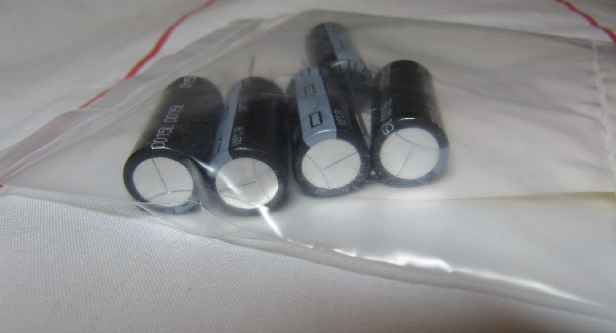

    Some days ago I received the caps I ordered including the brand new Panasonic FRs.
    It's the first time I get to see Panasonic capacitors without the M logo. I noticed also that the label is plain and gray, not like the Panasonic FM, FK and FC.
    Are they genuine?

    at first, i thought they definitely look like fakes (re-sleeved)..
    but on the other hand.. perfect T-vent (doesn't say much though) and the usual panny bung.. hmmmmm..
    strange
    edit: another thing.. i don't know much about the FR series, but all low-ESR caps from panasonic that i've seen so far always had gold letters/printing.
    on non-low-esr / general purpose pannys it's white or silver instead.

      odd.datestamp looks wrong too.

        That's right. FRs are hideous. I ordered a bunch before off Mouser and there is no Matsushita logo or anything else pretty on it. Pretty bland. They're funny because they don't even say Panasonic on them or anything...Just 105C FR

            Have similar cap.
            FC 16V and 3300uF. Marked with golden print (it is somewhat pale) on bluish plastic. Datestamp is pressed in and in red.
            Leads, rubber plug and stamp look fine to me.

              ^that's what all the pannys i know look like

                  what all the pannys i know look like (usually.. example of all 3 versions)
                  top left -> general purpose 105°C (silver markings)
                  top right -> datecode (etched (?) in the sleeve) of a low-esr panny FM with black sleeve
                  below that -> other side of the same cap ; gold markings
                  bottom left -> low esr panny FC ; gold markings, dark blue sleeve (looks a lot more blue-ish on the photo than in real life)
                  above that -> datecode of another FC .. also etched (?) in

                    FR are a brand new series.
                    No Matsushita logo probably just means not made for Panasonic by Matsushita,, made for Panasonic by Panasonic.
                    Matsushita owns Panasonic [or maybe it's the other way,, I don't remember..]
                    Changing the color on the date code is probably a cost cutting measure.

                                Push in the bunge. If it goes in too easily, then it is a fake.
                                There very good looking fakes of Panasonic FC coming out of China.
