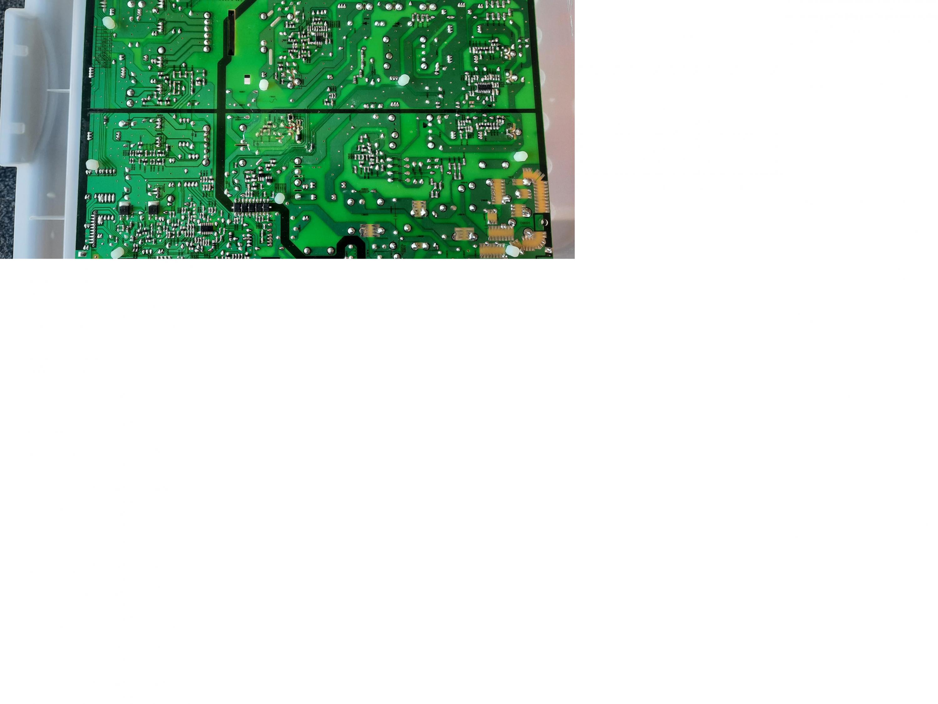

    hi i have bn44-00516a power supply out of a samsung ps64e8000 tv which transistor failures in the pfc circuit and the main switchmode supply ic failed taking some tracks with them and the tv has some missing smd caps which i do not know the value of cx814 and cx812 cx813
    and the smd cap cx826 which goes the across the switchmode ic is missing also but i need to know where the track that runs between it goes as it has partialiy missing peice where the red line is the track under cap to either one of those pins seen in the picture can anyone help

    Re: Ps64e8000 powersupply troubleshoot
    You have to take closer, and clearer pictures of the board. Yours are to blurry when we zoom in.

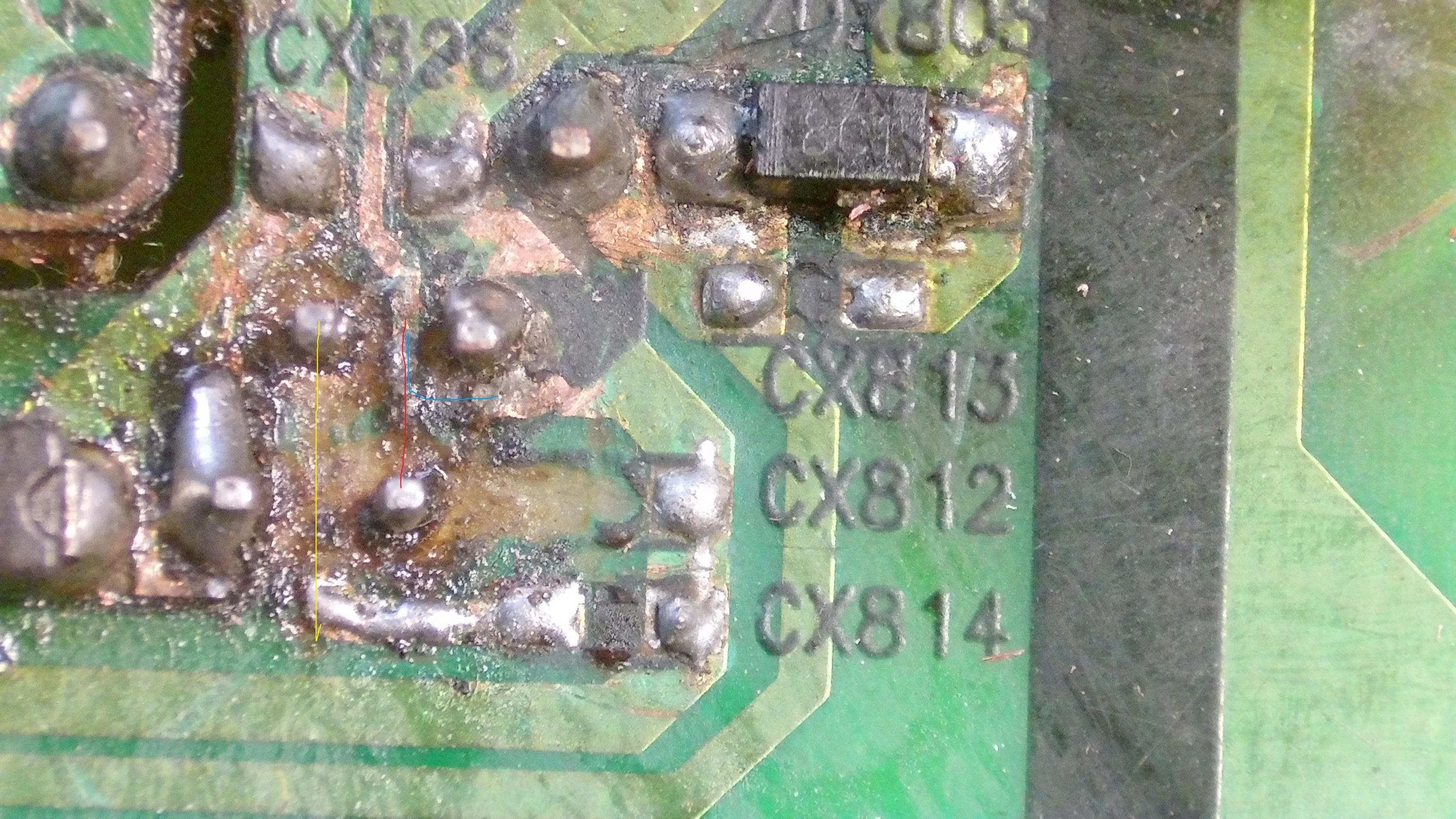

      in this image i know where yellow trace goes to but trace going underneath the missing cap i don't know if it take the path of the blue line or the red line
            The correct path is the red line, that is the vcc for pin4 of the ic

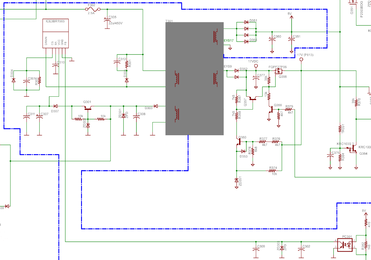

                  Based on a similar schematic BN44-00445C, that uses a ICE3BR1065JF
                  CX814 = 474/16v (1608) pin3
                  CX812 = 104/50v (1608) pin4
                  CX813 = 103/50v (1608) pin6
                  There is an electrolytic cap (CM802?) on the vcc line, it should be replaced as well, and CM801 could be also be weak.
