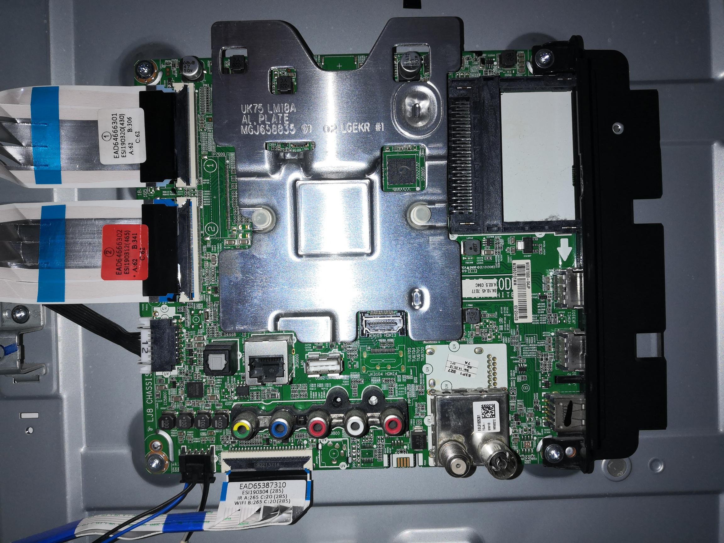

    Hi Guys.
    Probably something that have been seen before.
    Out of the blue the screen turned black but can still hear the audio.
    I can see the backlight on so that's something we can exclude.
    Now, i have found a video on youtube of this guy taping x amount of pins on the cable that goes from the mainboard to the screen. Tried that, i can see the screen now but the bottom of it still remains black with a lot of vertical distortions.
    I have been told that the Tcon board needs replacing. I can see that are different opinions on where tcon board is. Some say tcon board is attached to the screen (actually 2 boards, long and narrow) and some say the tcon board is integrated on the mainboard.
    I'm too inexperienced to find where the fault is, i'd love to know if there is a simple fix/replace i can perform to avoid buying a new tele.
    Thanks for you help

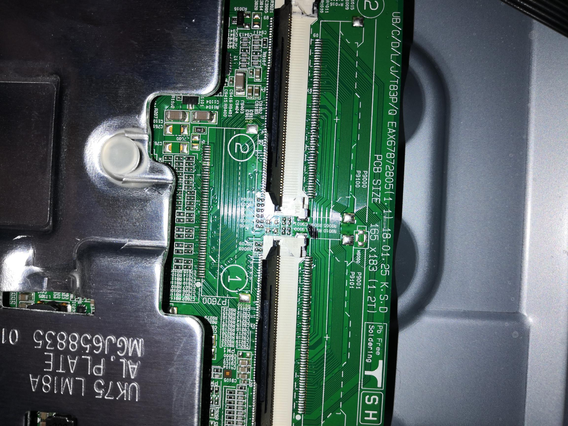

    Re: Black screen LG 43UK6300PLB
    Something i have missed to mention, it does not matter if i disconnect one of the cable that goes to the screen, i am not able to see any of the two halves of the screen working correctly.
      could be bad solder balls on the ic under the aliminium heat sink on the main board a lot of lgs suffer from it. If a replacement mainboard was available at a resonable price and came with a gaurantee i would certainly be trying a replacement board.
        Thanks. I have ordered one for £10 including shipping. hope for the best.
          Those are the panel boards that distribute the voltages and data out to the panel. Sometimes they are also incorporate the t-con on the panel boards.

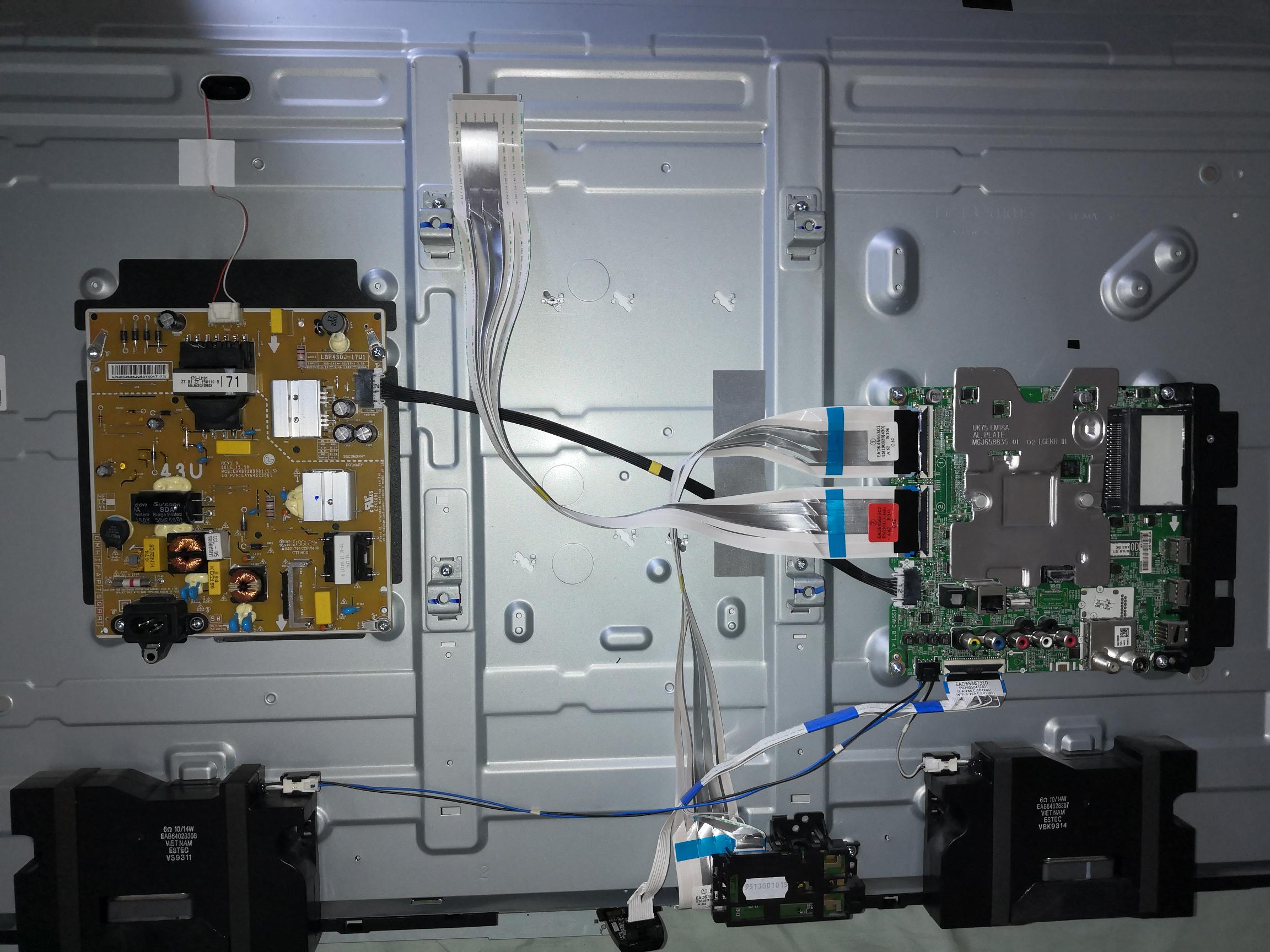

                HI. Unfortunately i tried again to do the trick with the tape but does not work anymore.
                I did not purchase anything yet and i'm tempted to put the tv in the skip.
                I'd like to be certain is the mainboard and not the lcd screen.
                  maybe tear it down and inspect the cofs, lots of times you find one that's obviously burnt.
