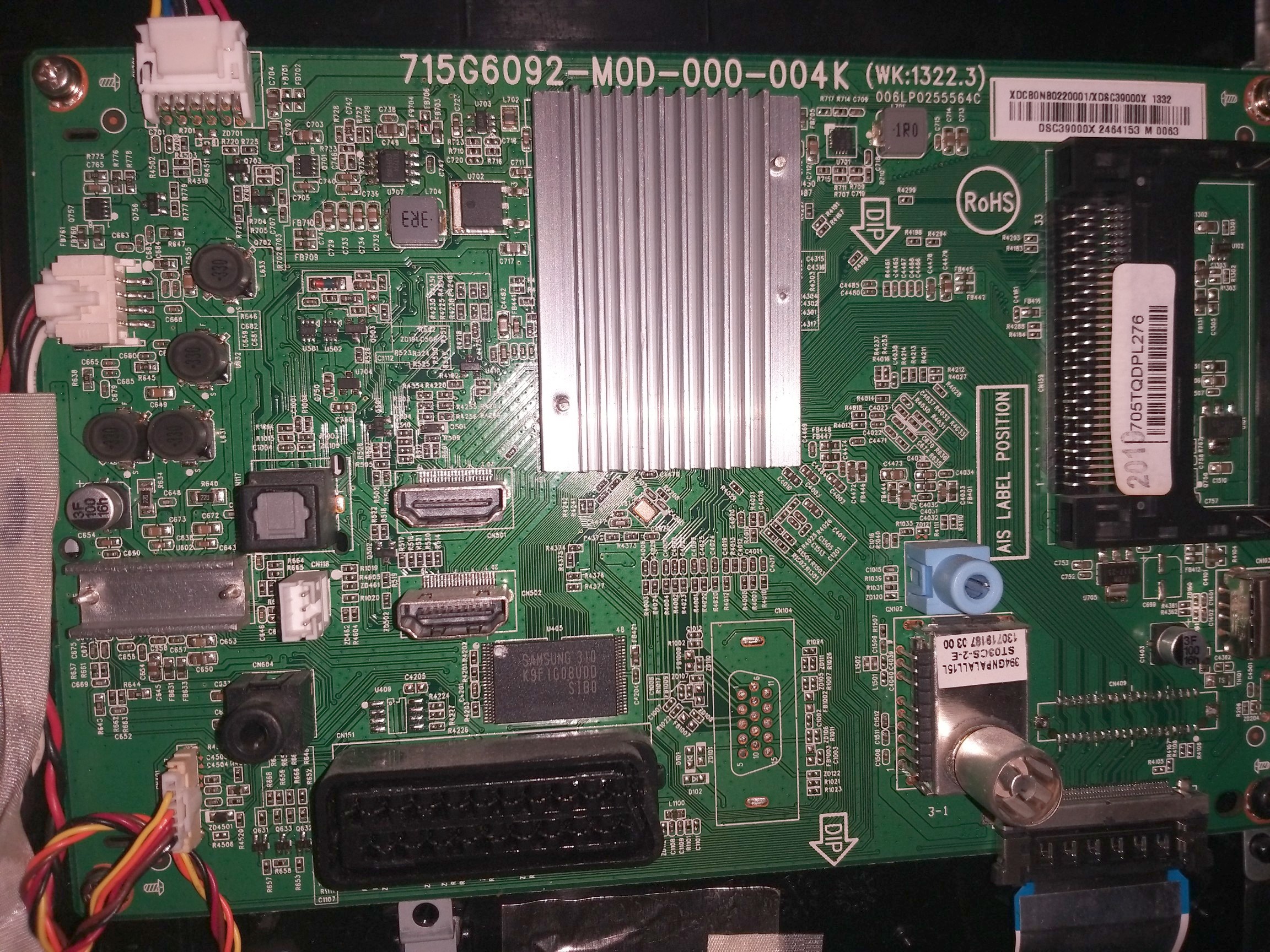

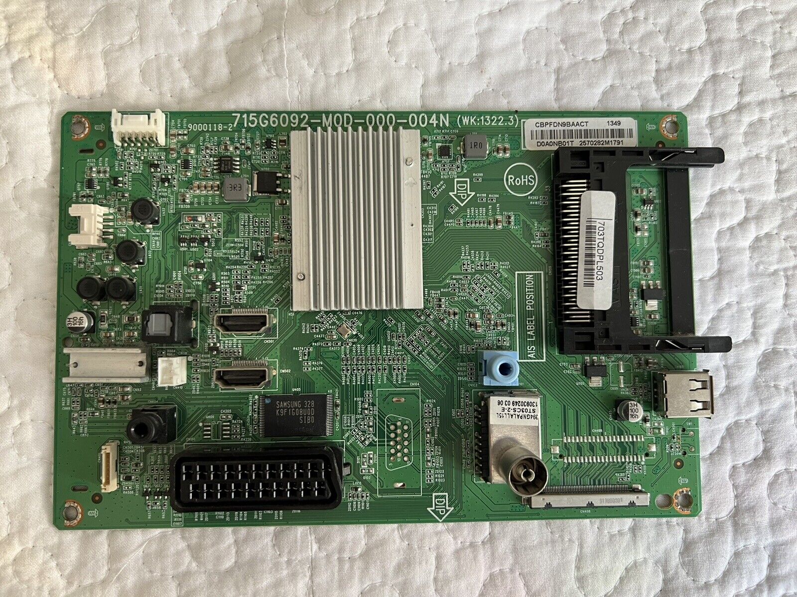

    So I found this motherboard:
    715G6092-MOD-000-004N (WK:1322.3 )
    Mine is :
    715G6092-MOD-000-004K (WK:1322.3 )
    The code is slightly different (one letter at the end) and I was wondering if it should work? Maybe it will just need the firmware of my tv to be reinstalled on this MB ?

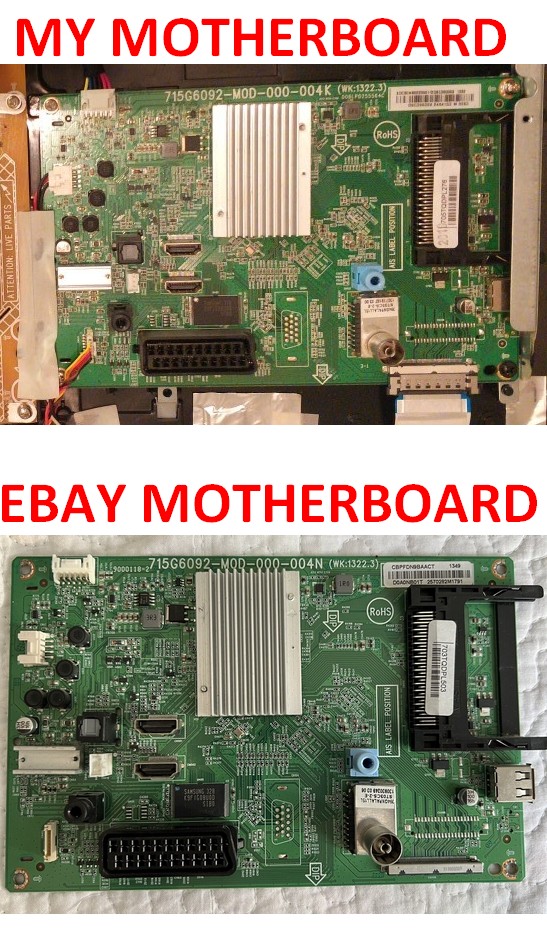

              I think we tried everything now.... I guess the motherboard is out.
              I can't find the same online (the one in my OP has been sold meanwhile). I found this one on ebay the ref is almost the same, only the last character is different maybe it's an update of my board...
              Do you think I could try it or it is useless ?

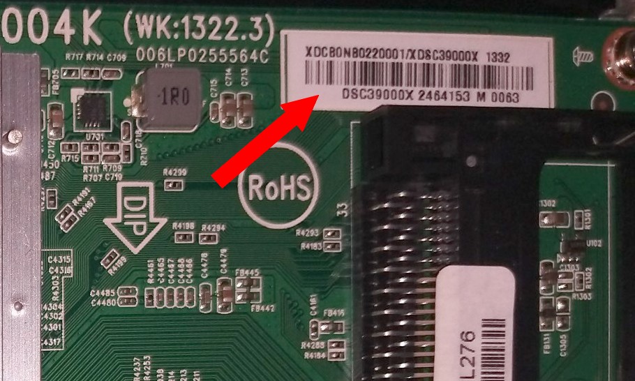

                Re: Philips TV keeps restarting, is this MB the same as mine please?
                you need to compare the white sticker on the ci module
                also post very clear high resolution photo of your MB. we may could bring it back to life.

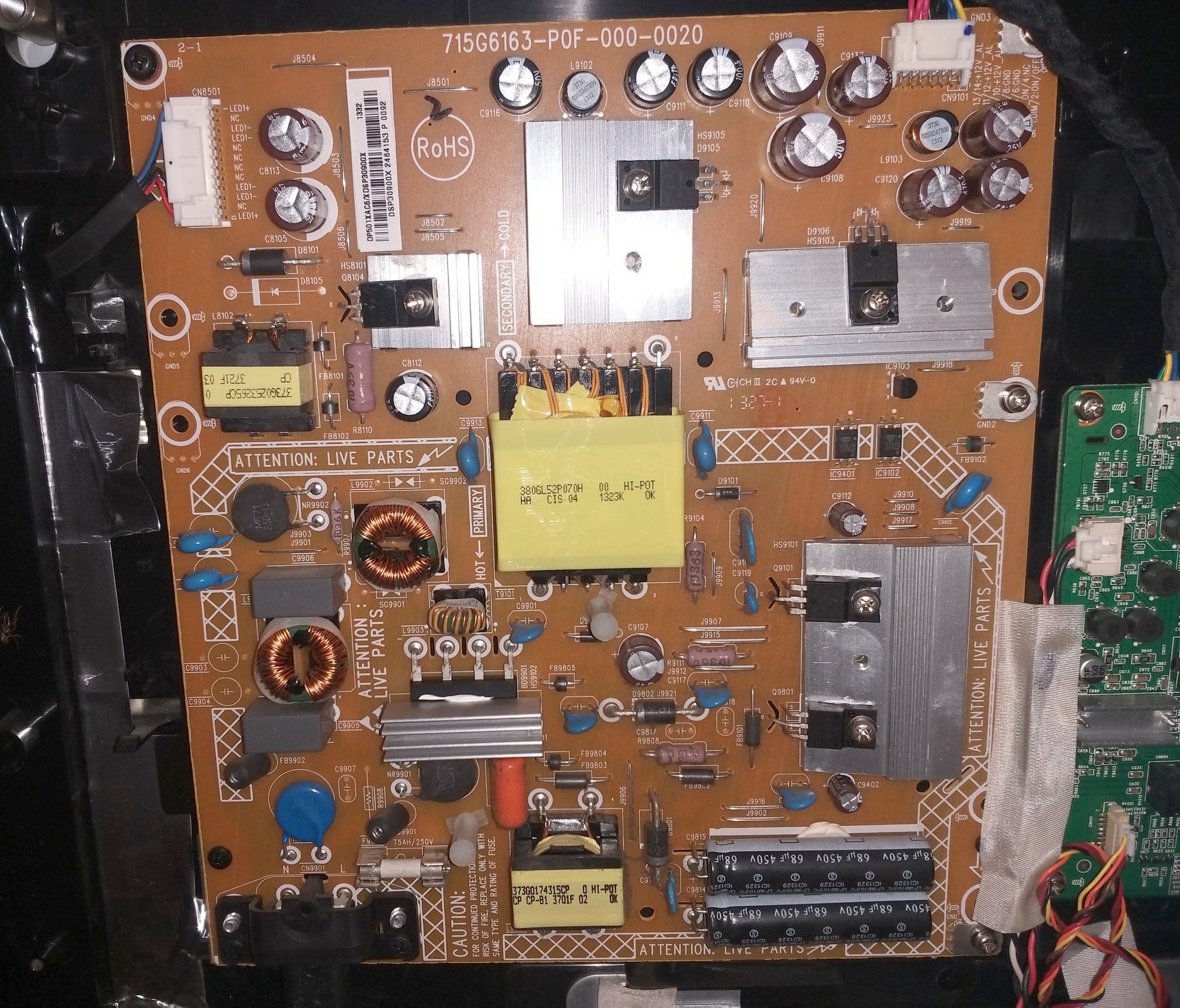

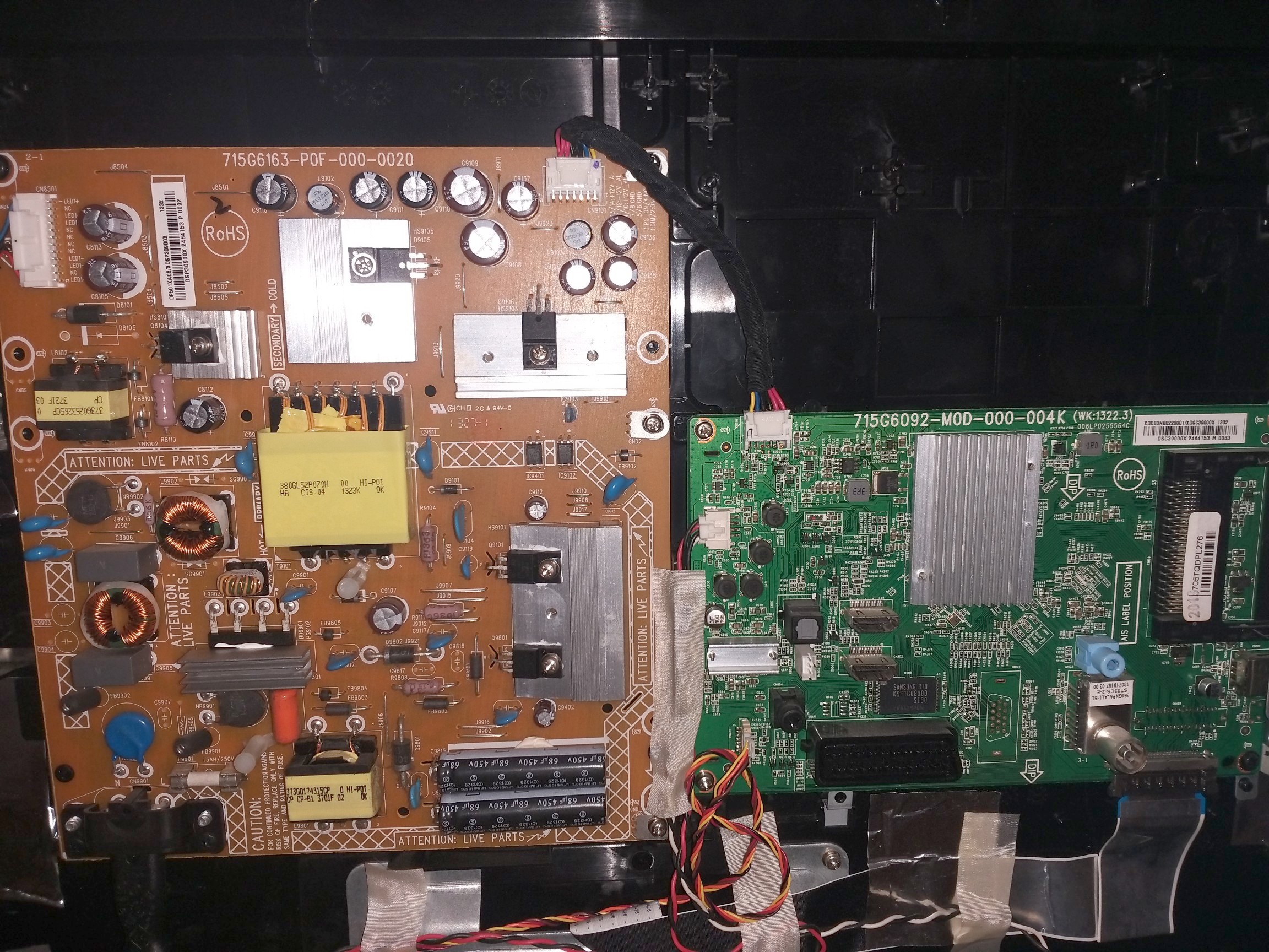

                  Here are some pics of the board, along with the power board (not sure if it's its name). And a video of the tv's behavior when I plug it:
                  https://streamable.com/8ixf1u
                    and the ebay card in case you need it too
                      okay... i cant see on the MB CSM point.. if other can see please located for us.
                      let do it proffisional trouble shotting.. yours TV 2013 and more old. it could be the restart from other reason.. because logo when it show on screen there are no protecting mode.. bur after logo finish start the protecting script.. this way we need to start from LED back light.
                      you have on the BL socket at PSU 2 channel you need to put yours probe of DM in DC V mode and put the red on LED1+ and the black on LED- then turn on... you need to do the same if you have one more at any channel Led- listed your reading over here please to compare if we do have one channel or line at channel read less or more.

                        So with the multimeter I measure the voltage on LED- and LED1+ ? but where are these points on the board I can't find them. Continuing searching right now

                          ok they are on the power board not the main board. I'm gonna measure them hold on
                            There are 4 points labelled "LED1-" and they are all at around 39V
                            (positive probe on the first LED1+, DC current)
                              there are error at your measurements.. let do this... yours black DM to TV chassis and the red probe one time at each LED+ let see yours measurement.
                                negative probe on the chassis, I find 46V for the two LED1+
                                  I'm not saying it's a mainboard problem, just answering your question. you need to match up the numbers on the white stickers, not the silkscreen on the board, from what I see on the white stickers, it looks way off.
                                    Thanks. You mean this sticker?
                                    And you think it's a power board problem?
                                    There is another board called TCON, don't know what it is and where it is exactly, but could it be the problem ? (I find one for my model on ebay)
                                        if this true its look good for 40 size TV.
                                        if you buy the ebay one you will have distroubted picture .. put you can inter yours panel code manuly so it become fine.
                                        other things still i cant see any point CSM on MB... can you show me the back side of the MB
