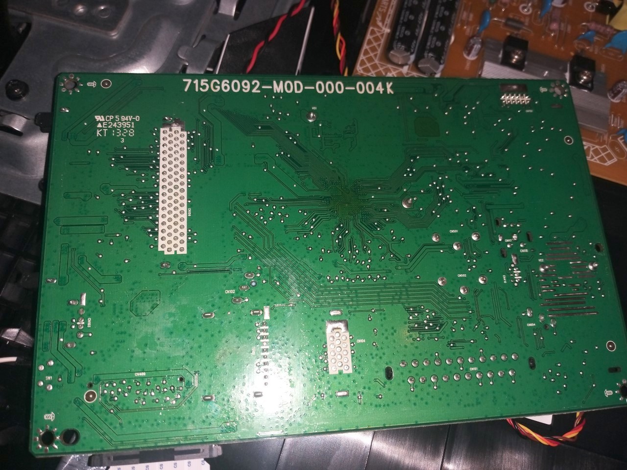

Philips TV keeps restarting, is this MB the same as mine please?
  • alfonzzo
    • Aug 2022
    • 55
    • fr
    Re: Philips TV keeps restarting, is this MB the same as mine please?
    Originally posted by Diah
    if this true its look good for 40 size TV.
    if you buy the ebay one you will have distroubted picture .. put you can inter yours panel code manuly so it become fine.
    other things still i cant see any point CSM on MB... can you show me the back side of the MB
    ok let me grab a screwdriver to unmount it.
    So the ebay one is okay if I put my firmware on it?
    Even if the white stickers dont match?
        here it is
          ok, Diah said you can enter your own code, I believe him, he hasn't lied to me yet.
            yes that one, some philips it can be the number on the bottom of the sticker, suppose it could be the top number as well on some, can be a 12 digit string, don't have to match every single digit on the whole sticker but there's about 12 in the string that should probably match.
            ok... so I have to look at all the cards I dismissed on ebay now, to see if the numbers on this sticker match. Lots of work in perspective...
                I'm never comfortable buying a mainboard til I have proven the backlights and powerboard when possible, usually by starting powerboard as stand alone, by using jumper wires or can use resistors for safety, that's WITH cable from powerboard to mainboard UNPLUGGED. not familiar with this board, so I don't know which ones would need to be jumpered.
                  I'm never comfortable buying a mainboard til I have proven the backlights and powerboard, usually by starting powerboard as stand alone, by using jumper wires or can use resistors for safety, that's WITH cable from powerboard to mainboard UNPLUGGED.
                  Seems a bit complicated for me but a few days ago I unplugged the cables that link the MB to the powerboard and nothing happened.
                    hahaha.. i never lei and here too the issue its not MB.. dont buy.. only mistake i did about csm.. it should be test point on MB SDM... realy i hate philips.. but 40 size as his TV from 2013 the LED BL will be edge not direct.. if they are edge the messuremnts he did not enough to drive 6V double LED as philips used and as i know.
                    so the questiones to OP yours tV used edege BL or direct.. edge mean the LED strips at the buttom of the screen.. direct BL mean the LED direct behind the screen as many strips.

                      #30
                      I'm glad I didnt buy the MB then, thanks !
                      Let me make a picture of the bottom of the screen. I'm going to try to open it too to photograph the inside, wait a bit please thank youuuuu
