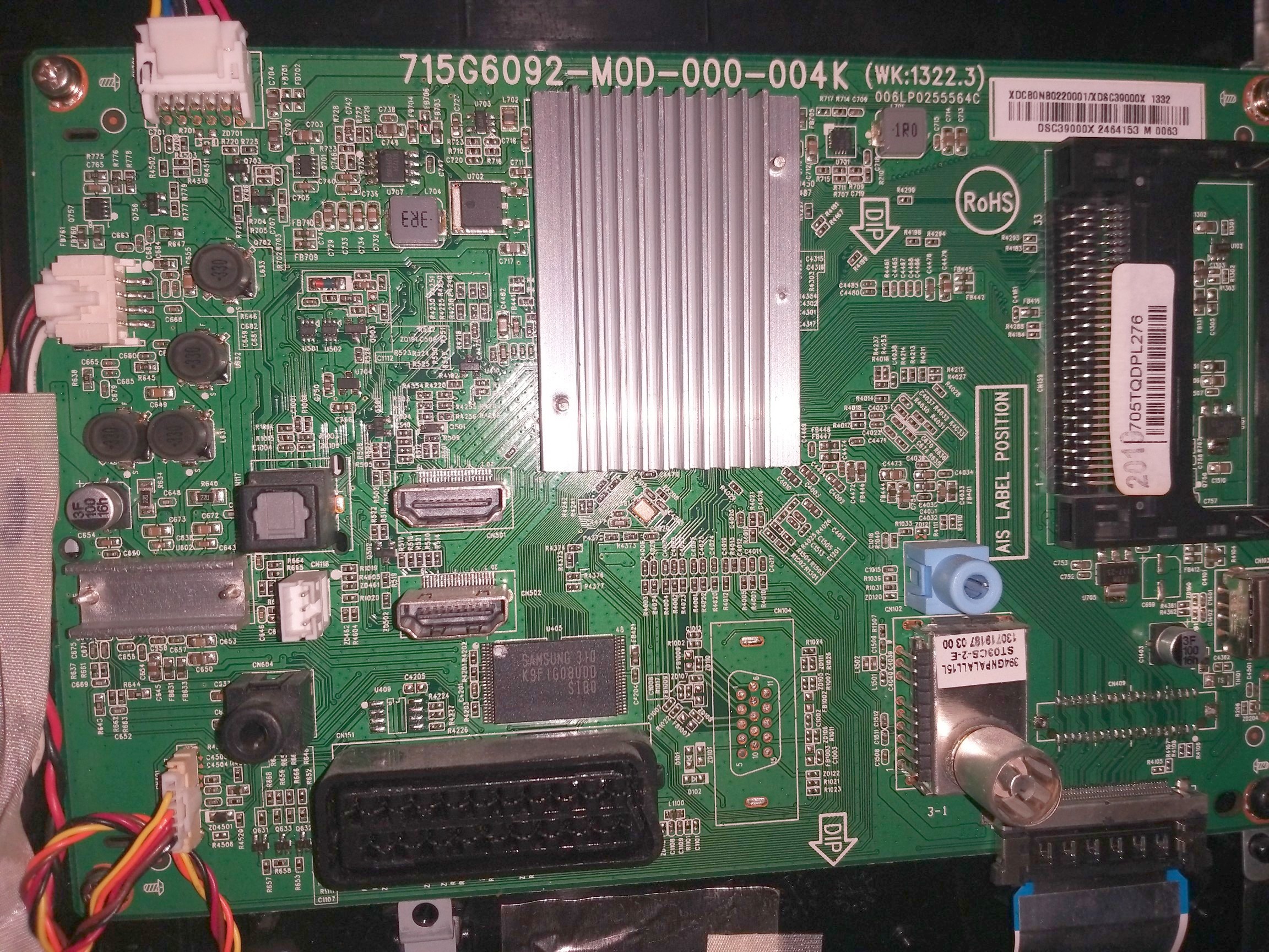

    My Philips TV 40PFL3148H/12 keeps restarting as soon as the Philips logo is displayed, as soon as I plug it. The remote doesnt have any effect on it anymore, plus no red light on the tv panel as usual.
    After contacting their support, they sent me a file to update the firmware from usb but without success (8gb 2.0 drive formatted in fat32).
    Then they told me that it was a hardware problem.
    Here is a video of the problem : https://streamable.com/8ixf1u
    Thanks for your help

            Re: Philips TV 40PFL3148H/12 keeps restarting on the logo
            Rebooting after the logo suggests faulty NAND.
              thanks, I read some threads about this too so maybe it's the case yes.
              Do you know what this nand looks like on my motherboard please, or maybe its reference? so I can try to find one online. Thank you
                Just above the scart socket.

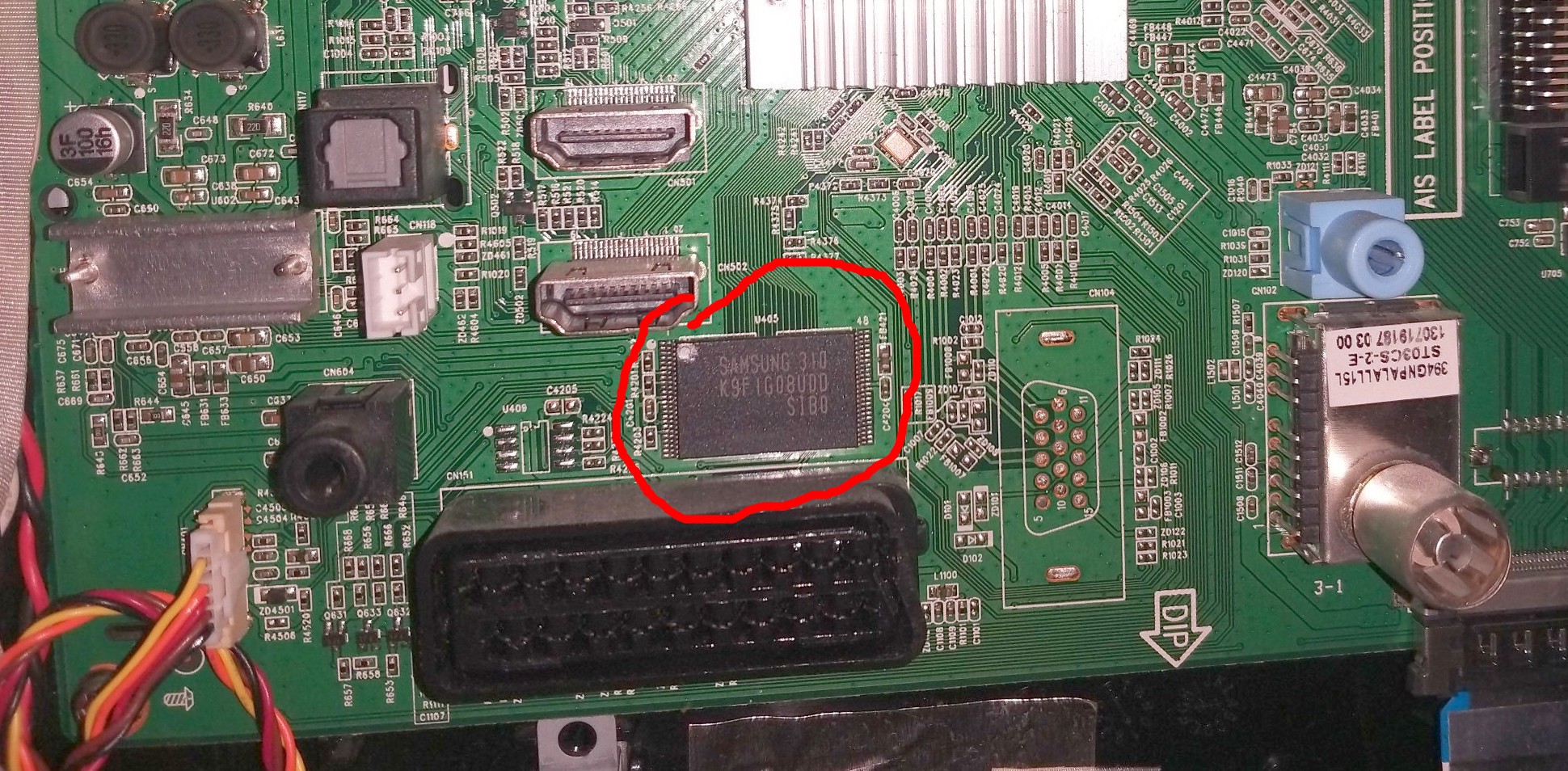

                  This one?
                  If it's the one, I think I won't be able to solder a new one it require too much precision. I can solder mosfets or like, but this kind of chips require an equipment I don't have (microscope...). Isn't there a way to program it without removing it?
                    I would think it's failed physically with to many bad blocks.
                    You have tried the only way to repair it without replacing it.
                          You have K9F1G08U0D, look carefully.
