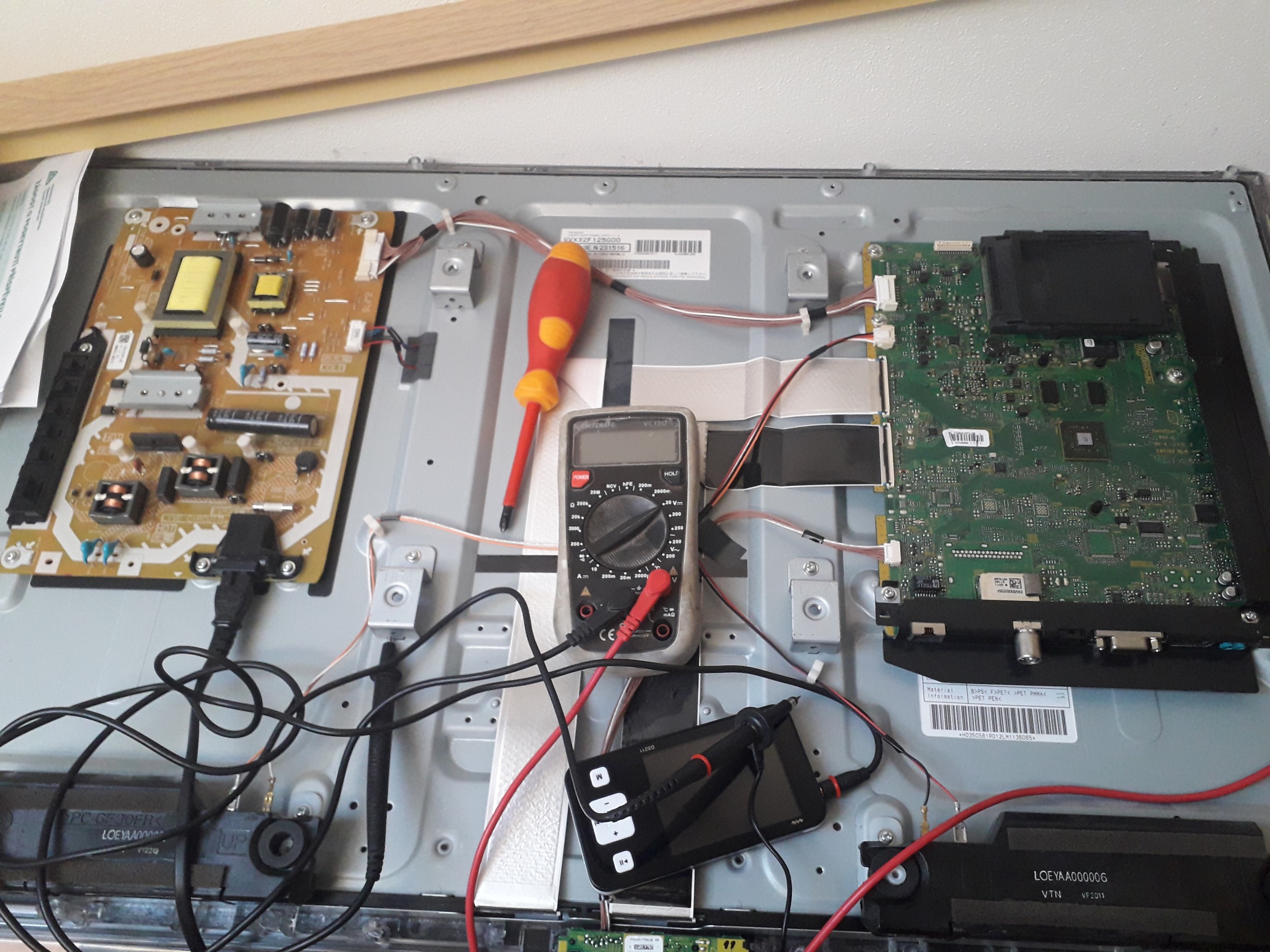

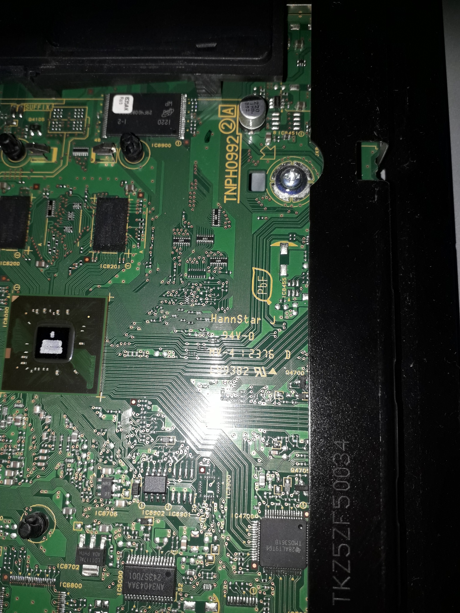

    I'm coming to you for advice. On my desk I have this TV that does not turn on. When the TV is plugged into the network and the POWER ON button is pressed, only the red LED is lit.
    I checked all the voltage on the P-BOARD:
    6V - stynd by
    16V
    40v backlight
    I found out that I can't get a voltage of 12V on the T-CON. Power supply 16V to the circuit IC4101 goes, I just do not know if this circuit controls the processor IC8000. Do you happen to know anyone ?

    On pin 14 of IC4101 is 5V so it is OK ( no fault ), but I dont have PANEL_VCC_ON and BL_ON why :-( :-( :-(

      Re: Panasonic TX-L32E5E doesnt turn on.

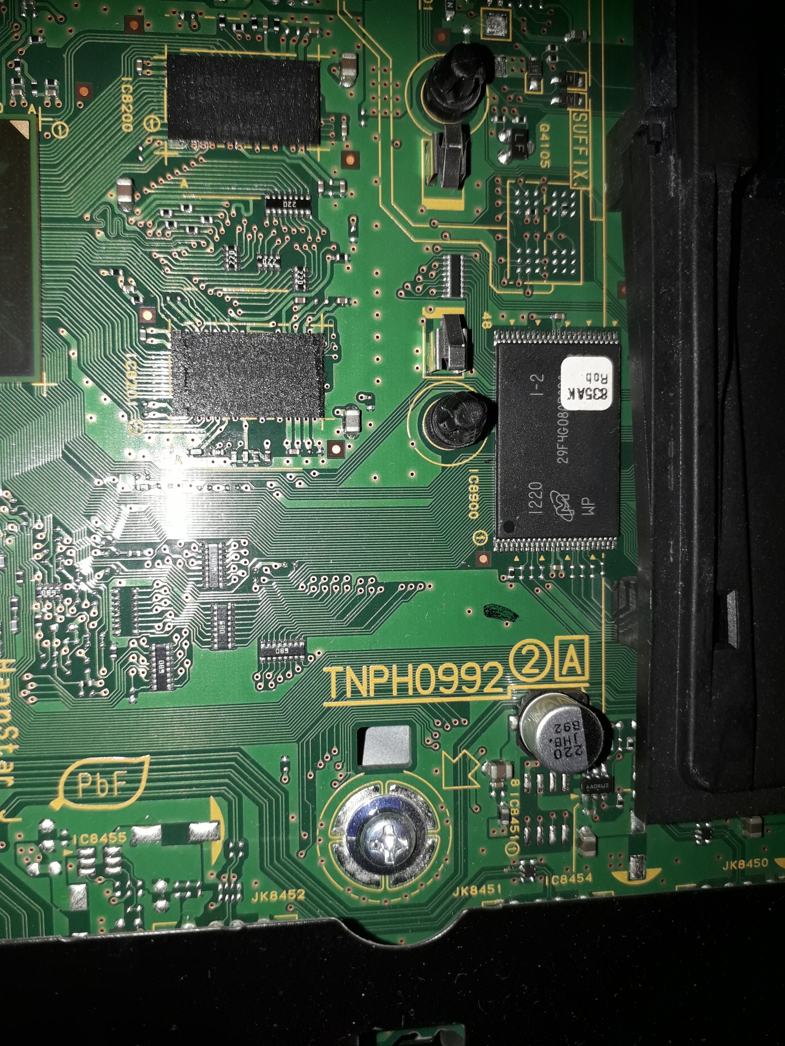

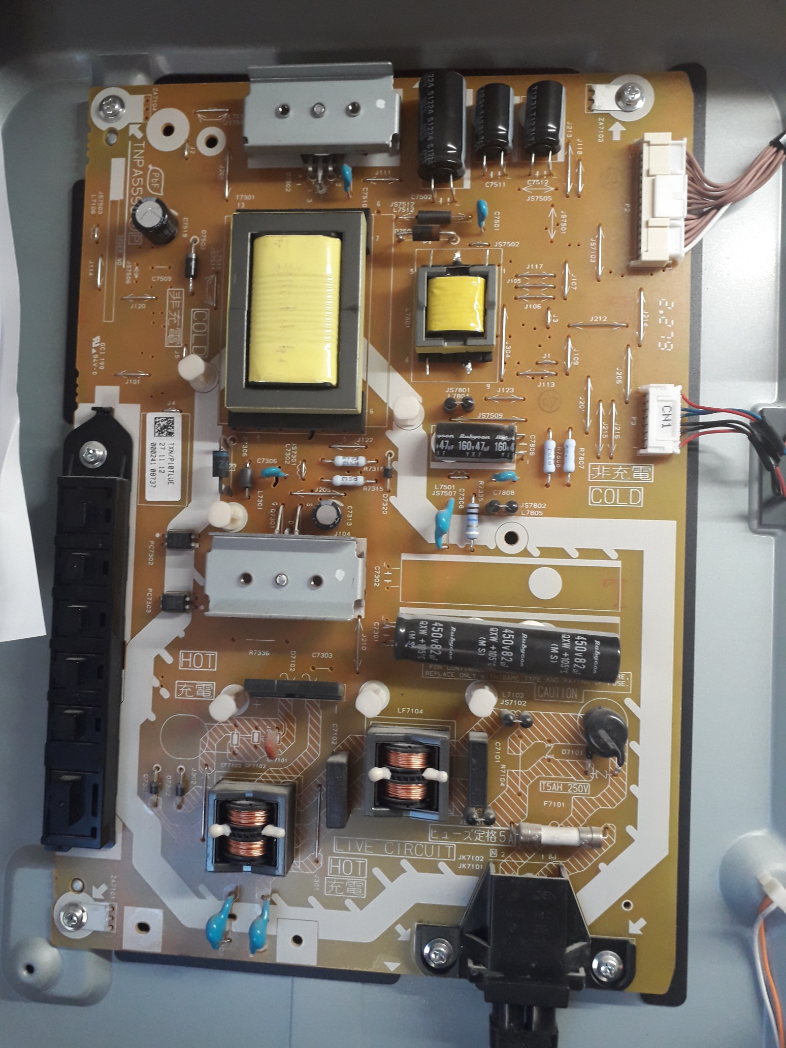

      Some good pictures of boards and connectors would help.
      • romisek1990
        • Jun 2022
        • 11
        • Česka Republika

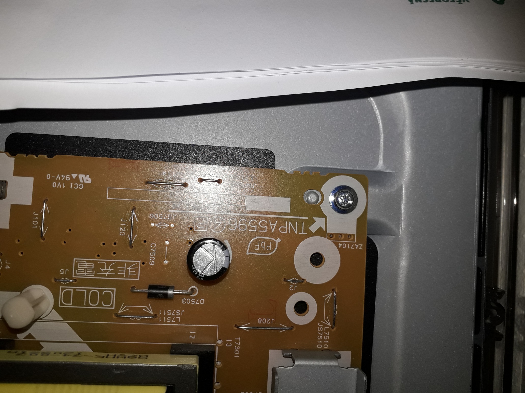

        A- bord is TNPH0992
        P-bord is TNPA5596
        pictures I will supply
          Some pictures

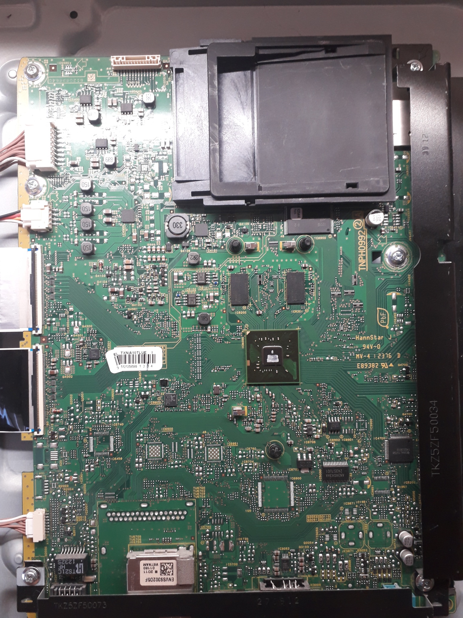

              Is your processor chip intact?
                No only light
                • romisek1990
                  • Jun 2022
                  • 11
                  • Česka Republika
                  procesor is visually fine
                    Does your led come on in standby? Does it blink when you operate remote?
                      Do you have data sheet for IC4101. Looks like processor enables it. Maybe heat up processor and try and turn tv on.
                        Yes, LED light and blinking on using remote. Firmware problem ? TV doesnt boot system?

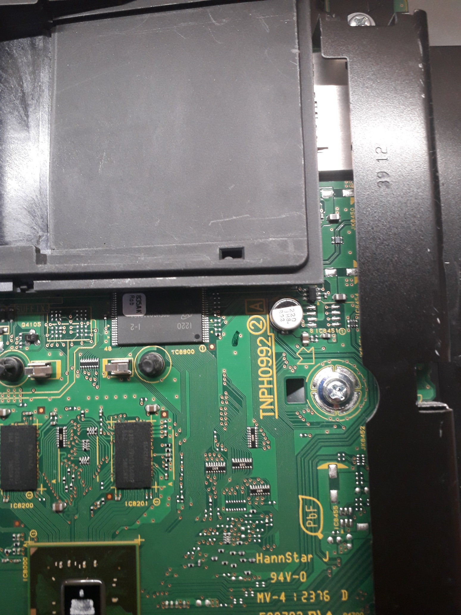

                          Is it problem change memory?
                          • romisek1990
                            • Jun 2022
                            • 11
                            • Česka Republika
                            Hello, I find that on TV is bad ROM memory. Is a problem to exchnage it ?
                              Do you have a programmer that can read and write Nand MT29F4G08ABADA?
                              • romisek1990
                                • Jun 2022
                                • 11
                                • Česka Republika
                                Unfortunately not. When I get someone, how do I know that the memory content is OK?
