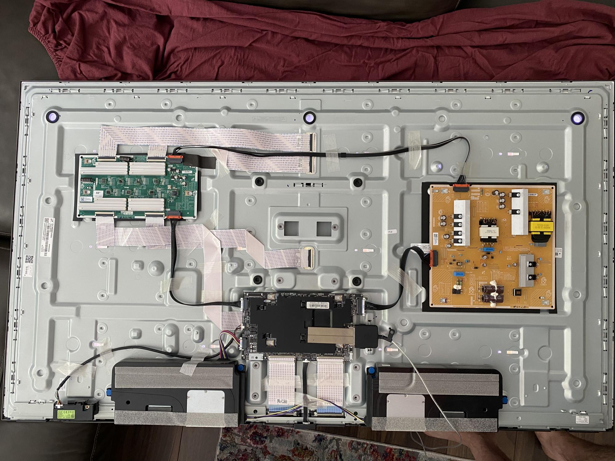

    Hi, I got this Samsung with One Connect box Q7, start to reboot after show on display the logo. I tried with another One connect box and still has bootloop.
    Now I took of the back cover of tv and inspected the boards and connectors.
    I did a reheat of the processor with hot air but still has same problem.
    What can I do to test the backlight ? It is a way to remove the protection?

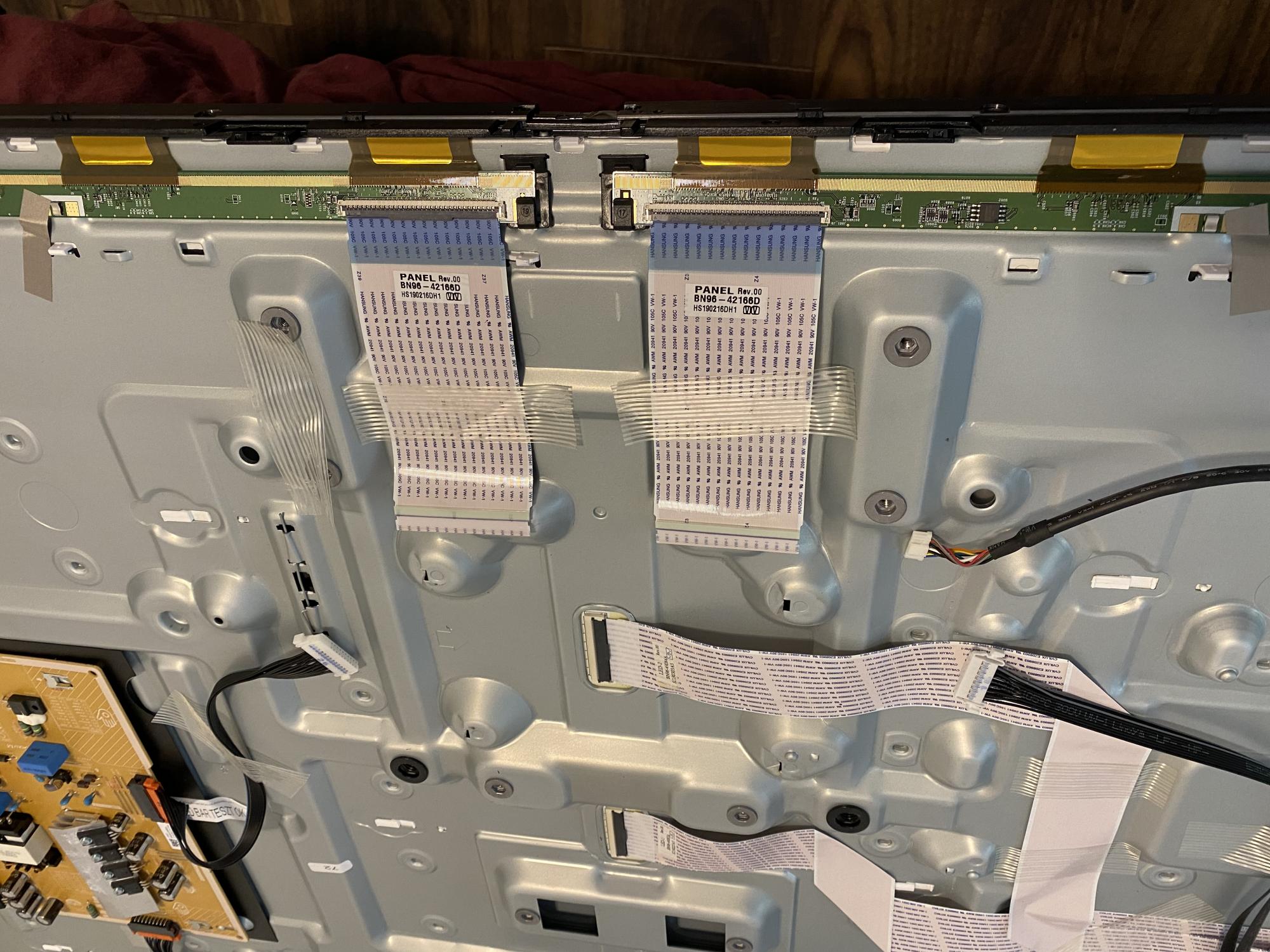

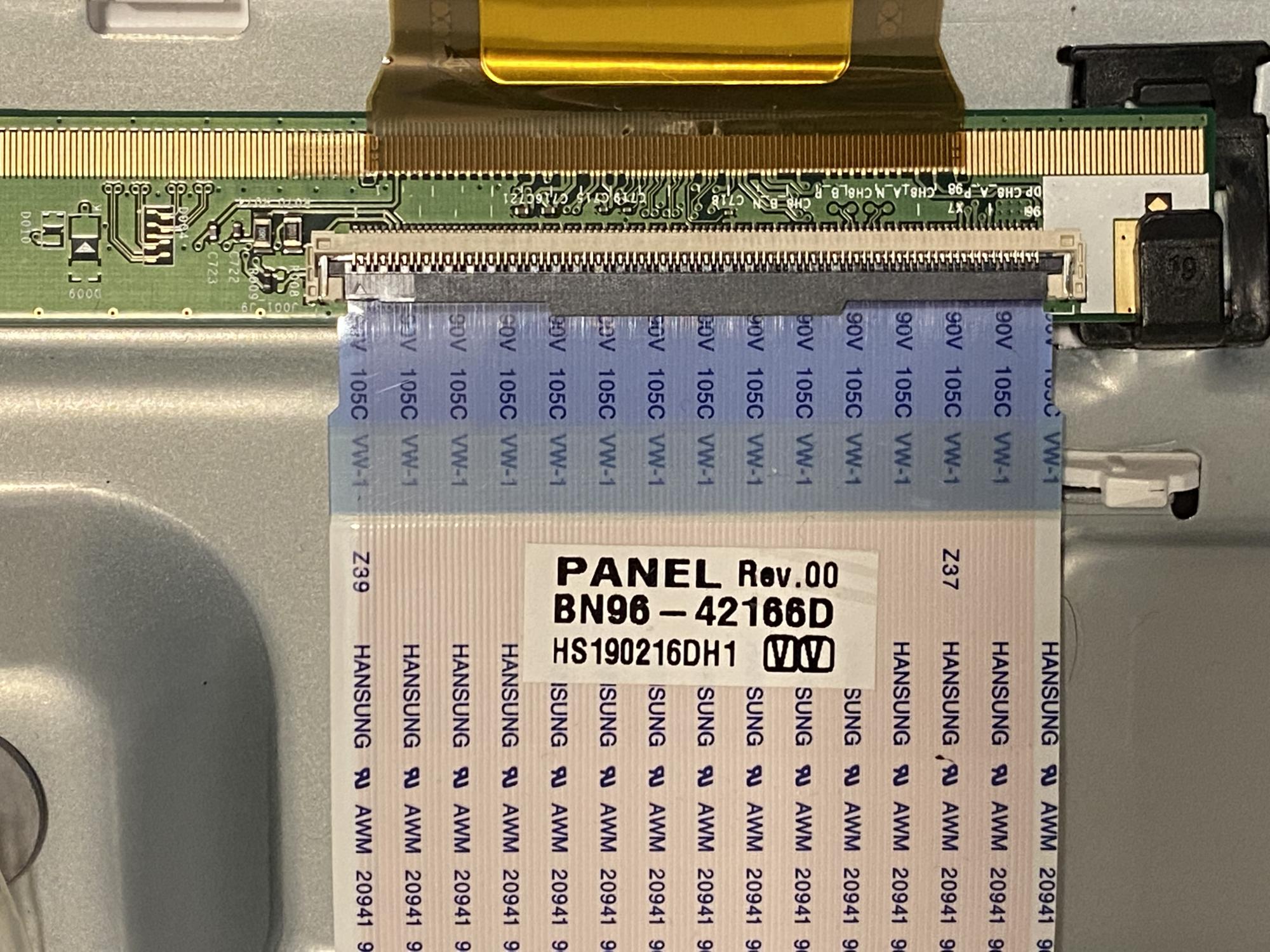

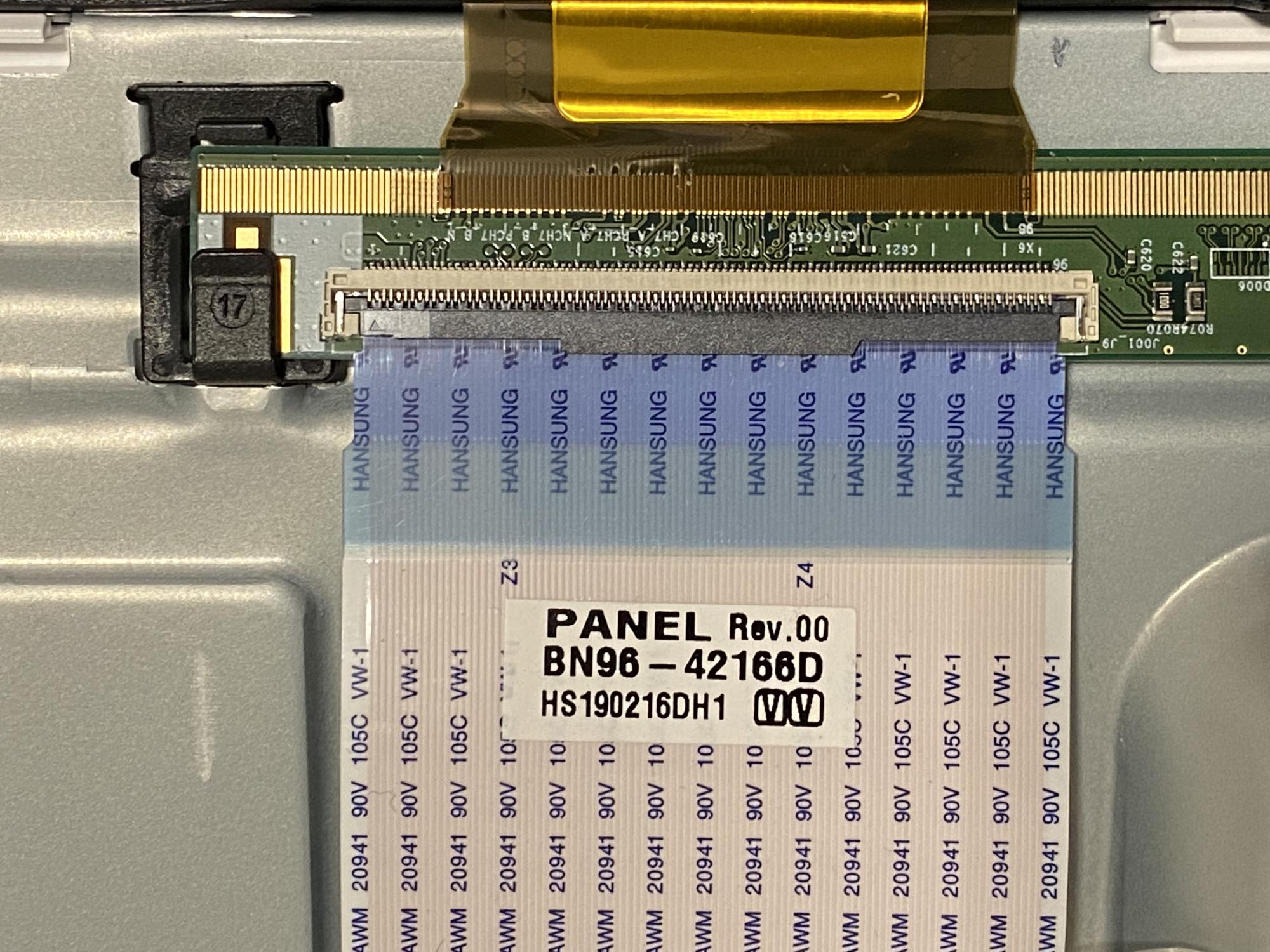

              Re: Samsung QE55Q85RAT bootloop
              Tv is on when half of panel is connected, no matter which ribbon cable , left or right, is connected with mainboard . When both ribbons are attached to the mainboard the tv is on bootloop and a strange sound, like a “buzzz” it's coming from the mainboard.

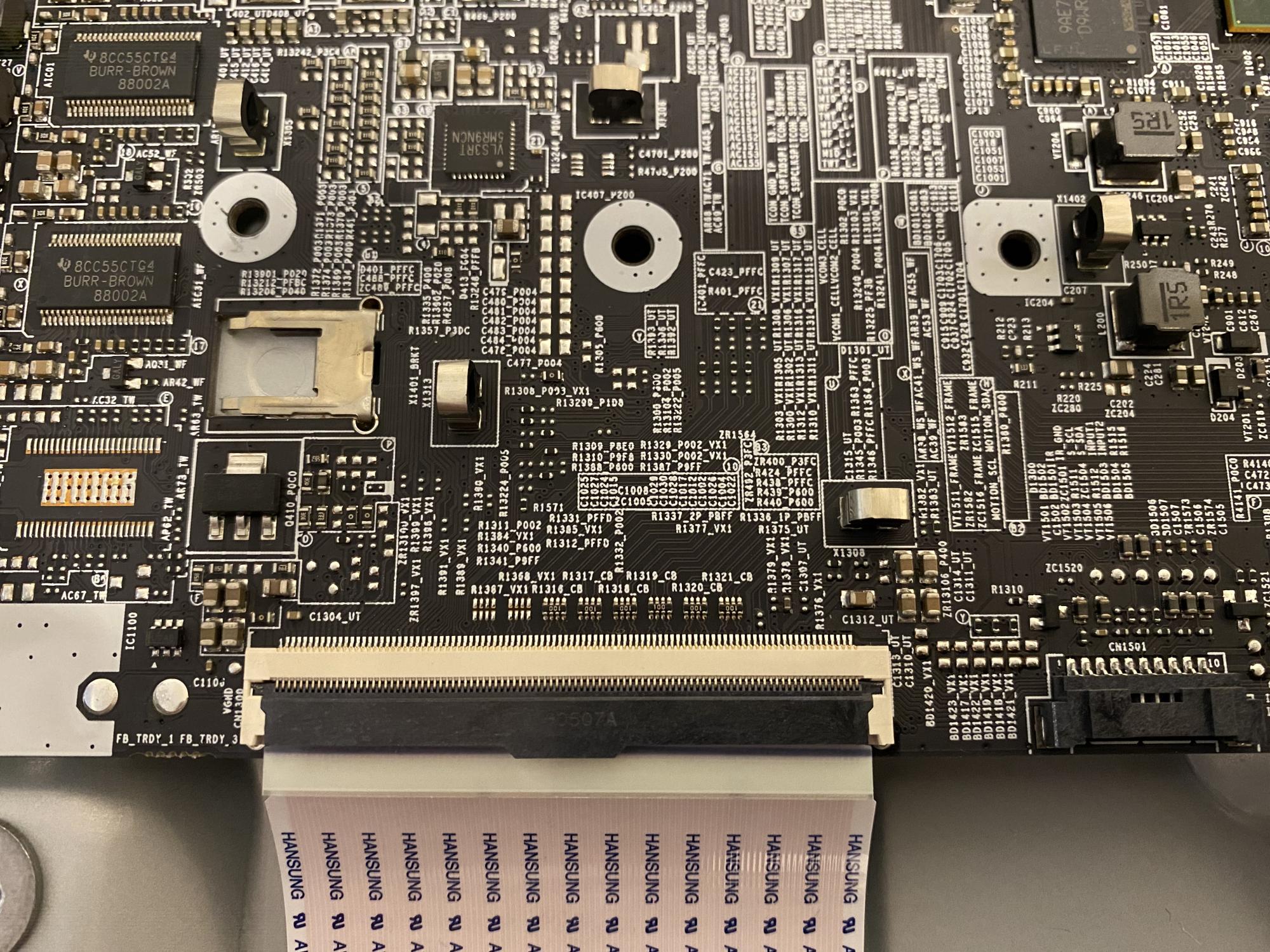

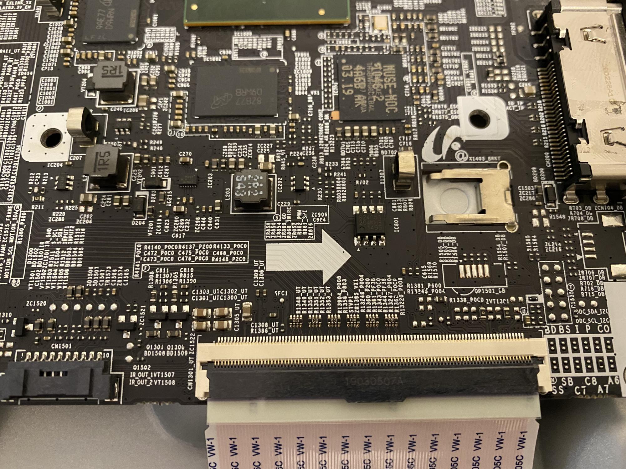

                  upload please high resolution focused photos of the LVDS socket left and right side on the Mainboards to reed to assignment of the pins
                  • Storyteller12
                    • Jun 2020
                    • 624
                    Can we get good clear pictures of the buffer boards.
                    • tehmatix
                      • Nov 2012
                      • 174
                      Pictures
                      • Diah
                        • Feb 2013
                        • 6397

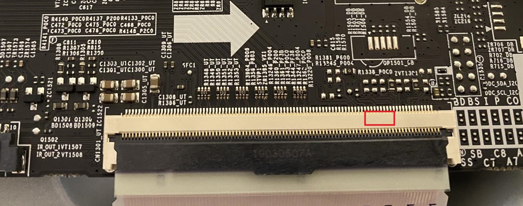

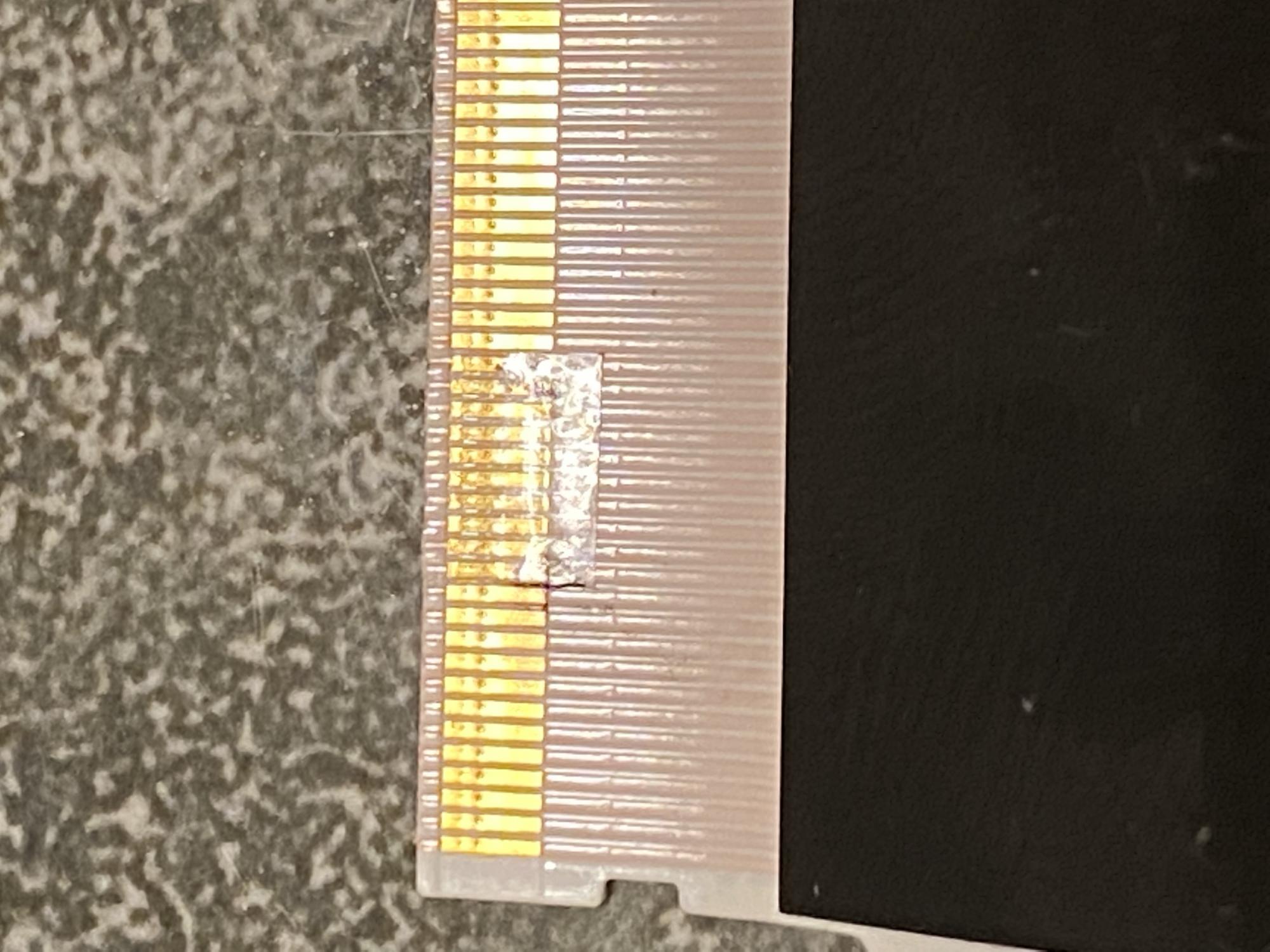

                        try to mask the exact pins on this socket and turn on.. notice if it stay on and display picture... if yes.. you have panel fault... if no result your issue on Main boards. good luck
                        • tehmatix
                          • Nov 2012
                          • 174
                          Thank you Diah , I managed to mask the pins. Nothing is changed, still making the problem, restarting after displaying the logo
