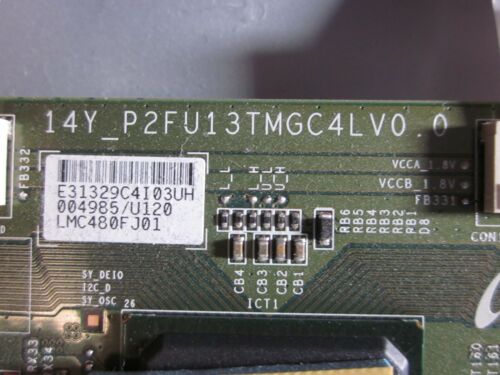

    I'll go ahead and order a new t-con, as nomoresonys said it's not worth the headache of component level, could I buy a t-con with the same model number that came from a different brand TV? as the cheapest I found on ebay came from a panasonic not a grundig.. Thank you all for helping me

      was looking at something like this:

        Re: Grundig 48 VLX 8582 BP, Possible T-CON issue?
        you want to match up the numbers on the white stickers.
          Closest I was able to find was this after searching eBay and aliexpress:
          pic1 is my board.
            some info there on part matching, can also check and see if it's match for your panel number, meaning compatible, not that the panel # and board # will be the same: https://www.shopjimmy.com/finding-the-right-tv-part/
              Hi..
              News of this tv ???
              You buy a new T-Con ?
              You need exactli same T-Con whit sam model
              Because firmware of tcon of Aliexpress not compatible of your TV
