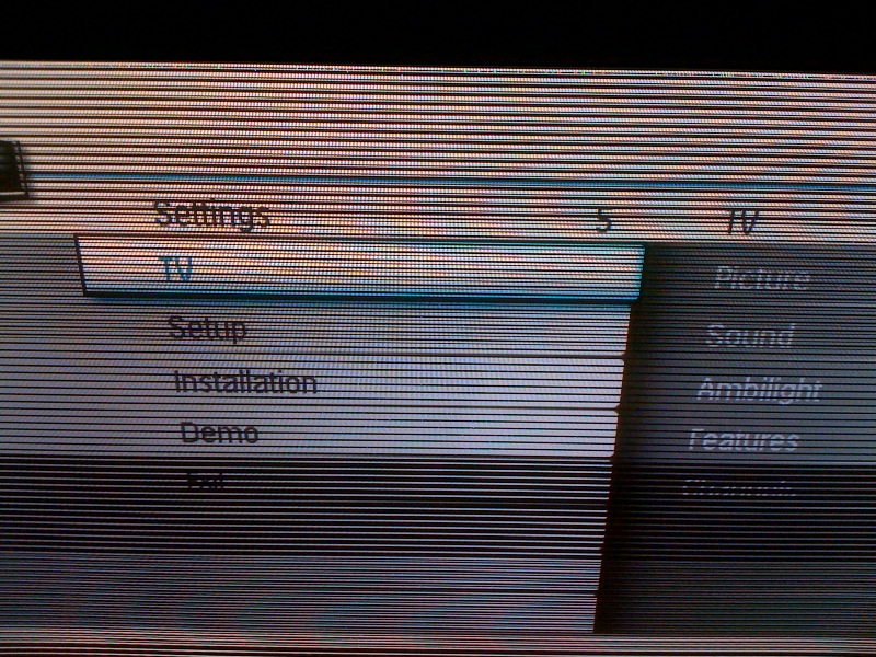

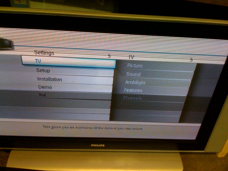

    I have two of these plasmas. One only the top of the screen has these horizontal lines and the other plasma both the top and bottom of the screen has the horizontal lines. The lines seem to be red, green, blue and black. I have done alot of research and this seems to be a buffer board failure. My question is what specifically on these buffer boards are failing and can these be repaired to the component level? I would like to repair the boards rather than swapping. I read somewhere that these might be cold solder joint connection issues but we all know that would be just to easy. I believe I can check the buffer chips one by one for shorting but I think if they shorted to ground the plasma wouldn't even startup. If it is a chip failure can they be removed and replaced? Below are the pics of the plasma that shows the worst signs of the issue. Any help would be much appreciated. Thank You.

                    So after way too long I finally ordered an upper buffer board. I put the board in and the picture looked great. So I put on a dvd with the back of the TV off and let it run for an hour burn in. No problems.
                    So I installed the back cover of the TV and let it run for about 20 min. and the lines on the upper half of the display started to reappear.
                    I quickly shut off the TV to avoid damaging the upper buffer board that I just put in. Let it rest for about 15min. and turned it back on. No more lines seen.
                    So do you think the buffer board is being driven to hard causing the lines or is it heat related?
                    The bottom half of the screen is fine all the time.
                    Should I compare the voltage being sent to the lower buffer board vs. the upper buffer board voltage or is this maybe a component on the Y sus board being heated up and causing the anomally.

                          With the old upper buffer board in the horizontal lines are always present. With the new upper buffer board in the lines are now gone but after about 15min of the set warming up with the cover on the lines started to slowly fade in, which is when I turned the set off.
                          The lines are there regardless of input and are also there with the menu up when the old board is installed (the original upper buffer board).
                          Wizard,
                          If the problem is the logic board like you suggest from your hint (because the horizontal lines are present when the menu is up) then why does the new upper buffer board at least temporarily cure the problem?
                          I am thoroughly confused. I have read several forums where several people have had the same problems with the same philips chasis and it seems the fix was always bad buffer boards. I am wondering now if this was a temporary fix as in my case.
                          What do you think the problem components on the logic board would be? I will now be taking a closer look at that. Anything to point me in the right direction would be appreciated. Thanks.

                            Buffer boards decodes the address lines bus and put one line up for each bus cycle and inject how much brightness after one trigger by the X drive to get plasma cell to light up. Y and Z buffers works together on brightness. The X drive get that pixel to light. Y buffers addresses one line at a time, Z strobes other lines at same time, they are driven just enough to have little precharge all the pixels and just a little trigger by the X (columns) get that cell to alight and sustain, amount of brightness depends on how much voltage applied to that cell by both Y and Z circuits.
                            Y and X are addressed one pixel at a time with two addresses to place where given line is and a pixel is lit by the X address last. One stuck bit on either Y or X adddress repeats across the screen like you see. The bad address is on the Y bus address bus. That can be either generated bad data from mainboard or the logic board.
                            Buffer board when defective, it will show up in one IC as noisy lines in one band or blank or IC physically blown out. X buffers is integral to panel itself. If X buffer is bad, panel is junk instantly.
                            This fault repeats across whole panel, cannot be the Y-buffer boards (the long thin vertical boards on left side, not the YSUS board (that one with heatsinks attached to the Y buffer boards).
                            Ohh, I see you had menu displayed, that means fault lies with the logic board, not the Y buffer or mainboard itself. It can happen rarely with mainboard, do the logic board first.

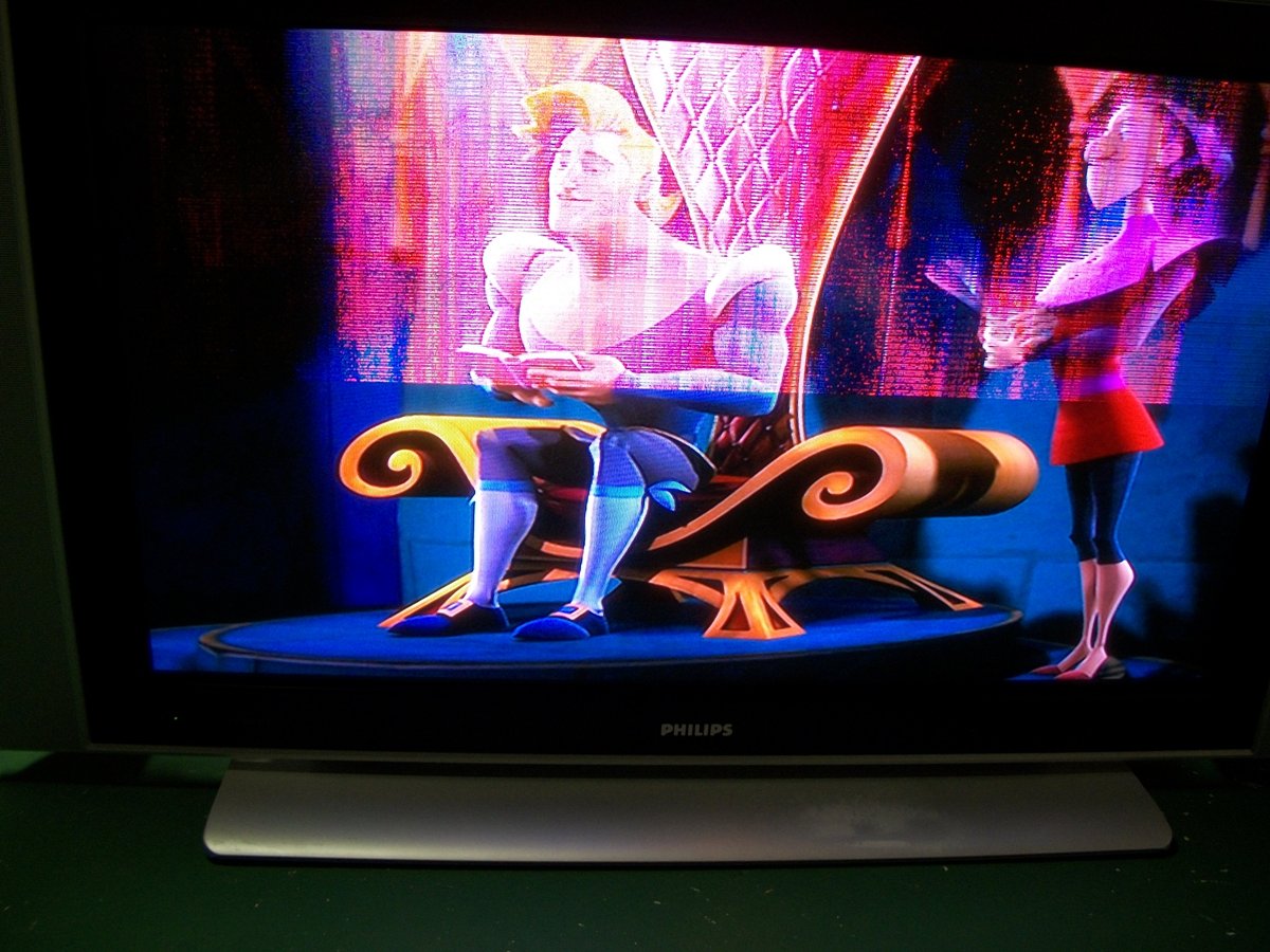

                                post the pic on that tv with panel half with lines.
                                Cheers, Wizard

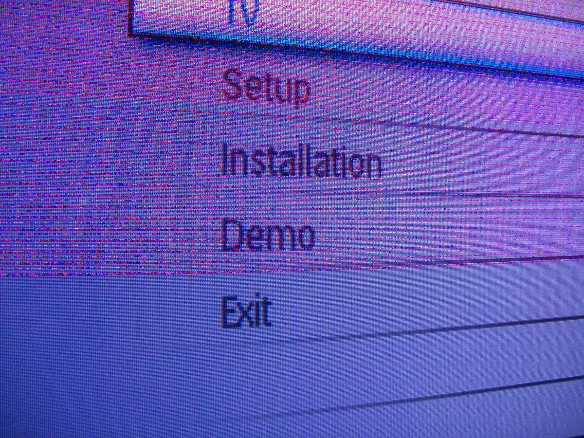

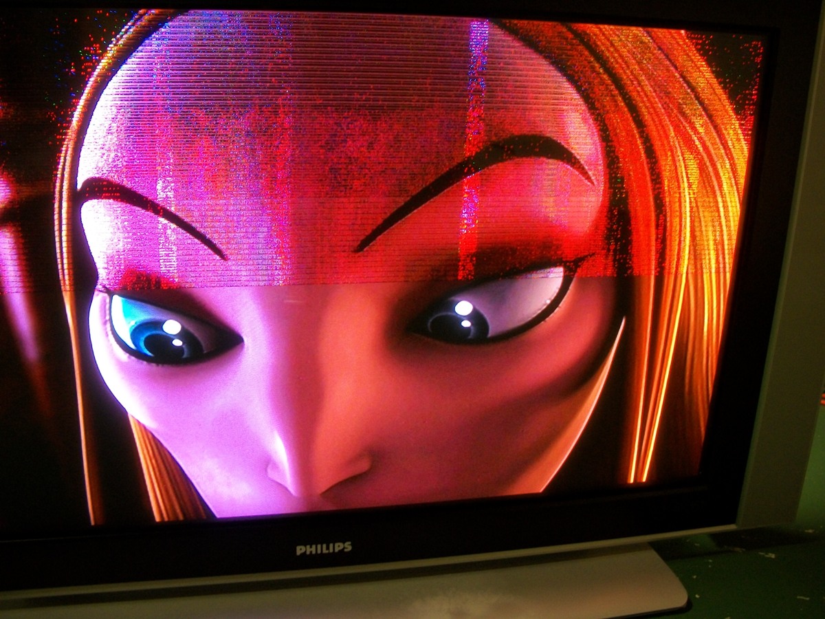

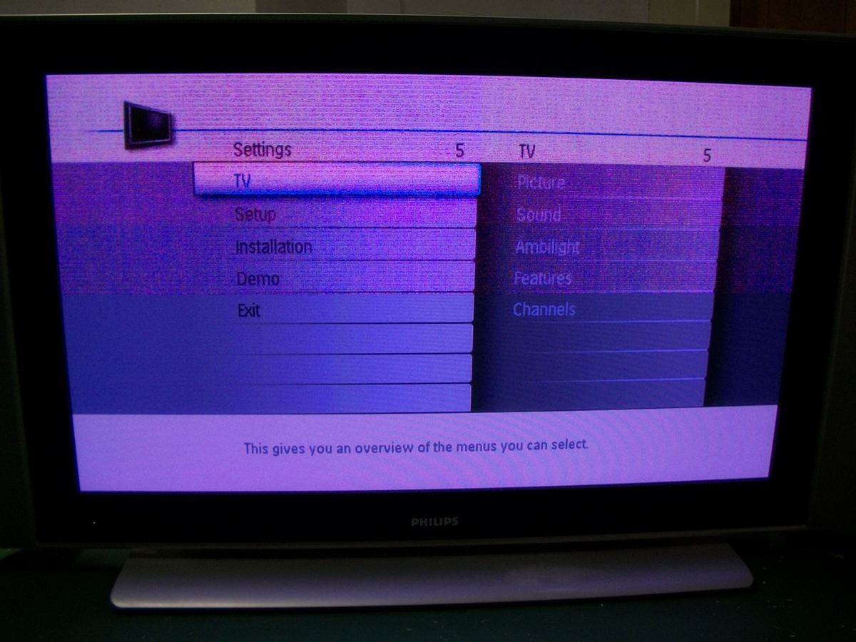

                                    Here are pictures from the set where half the screen is good. I have checked the buffer board for shorts with the method described by coppell tv repair and the board has no shorts and seems OK. Although the heat sinks on the buffer chips get quite hot. Could this be connector solder joints not making good contact on the buffer board?
                                    For a test I put the new upper buffer board back in. With the back cover off I let it run for two hours. No problems. After the two hour mark the buffer chips on the new board start to heat up and the upper half of the screen has lines jumping in and out of the picture. I took a hefty fan and cooled down the upper buffer board while it is still running. The lines disappear for 10 or 15 minutes and then start to come back till I cool it back down.
                                    Like I said I don't want to damage the upper buffer but I do want to figure out what is going on. Thanks to all involved for the help.

                                      I still think best to try with different logic board as well.

                                        If you put a fan on the one that starts doing it with the cover on does it still do it?
