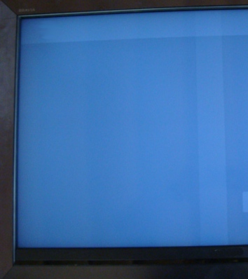

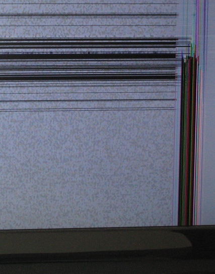

    If a screen does this...
    Here are two images of screens and what they are doing. What commonly causes these two types of things? They are both LCDs.
    The one with the white vertical line works fine otherwise.
    I don't own either of these TVs, just doing research on common problems people are reporting.
    Seems to me the one with vertical and horizontal lines is going to be main board, tcon, or panel?
    And the vertical white line will be...?
    Thanks!

    I'm attempting to channel Wizard, but I recall he said the vertical line indicates a dead driver on the panel. These are bonded to the panel ribbon cables, and unreplaceable.
      You mean the vertical white line, right? That's a pity.

        and the one on the right is busted.

          Busted how? Broken panel? Is that what LCDs often do when broken?

            see the blotch at the top on the heavy vertical bar?that is where it was hit.

              These photos shown here is bad drivers or something hit the LCD panel and damaged it. Unfortunately.
