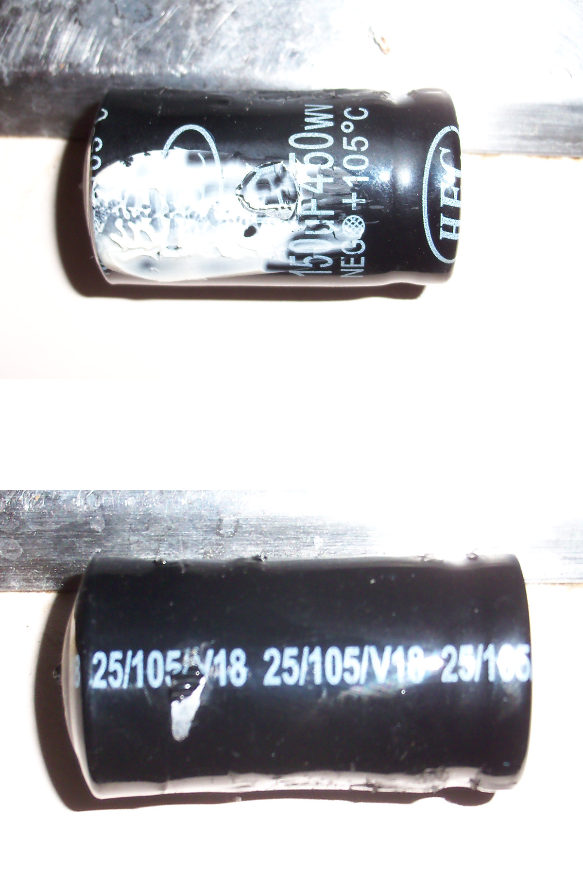

                                        ok, so i got the information for the two small caps here, but I still need information on a replacement for the big filtercap (photos shown)

                                          Re: polaroid tv capacitor identification
                                          Anything that high in voltage is a general purpose cap.
                                          Panasonic TS-HA, TS-HB, TS-HC, or TS-ED. Look at the data sheets for those series and find your cap value in the right size.
                                          Chemicon would have the proper cap too but I can't remember the series. Just search for the value and voltage and they'll come up.
