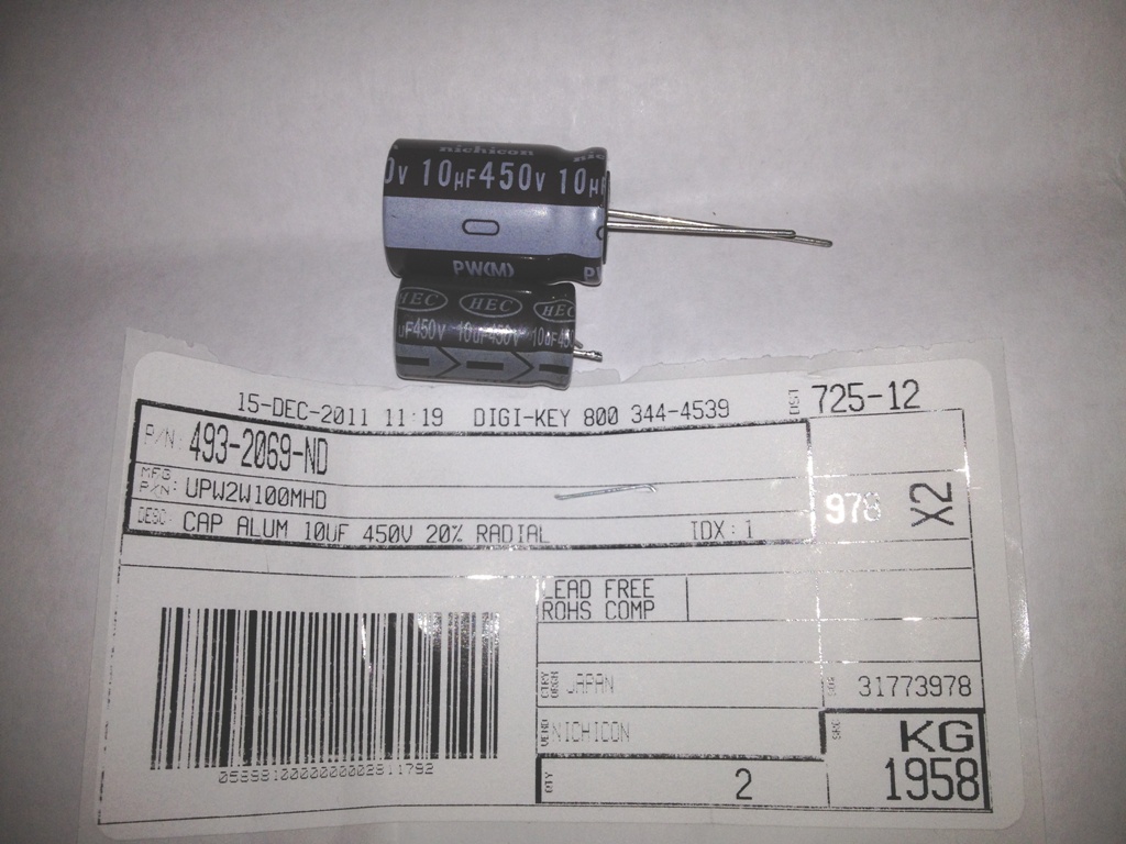

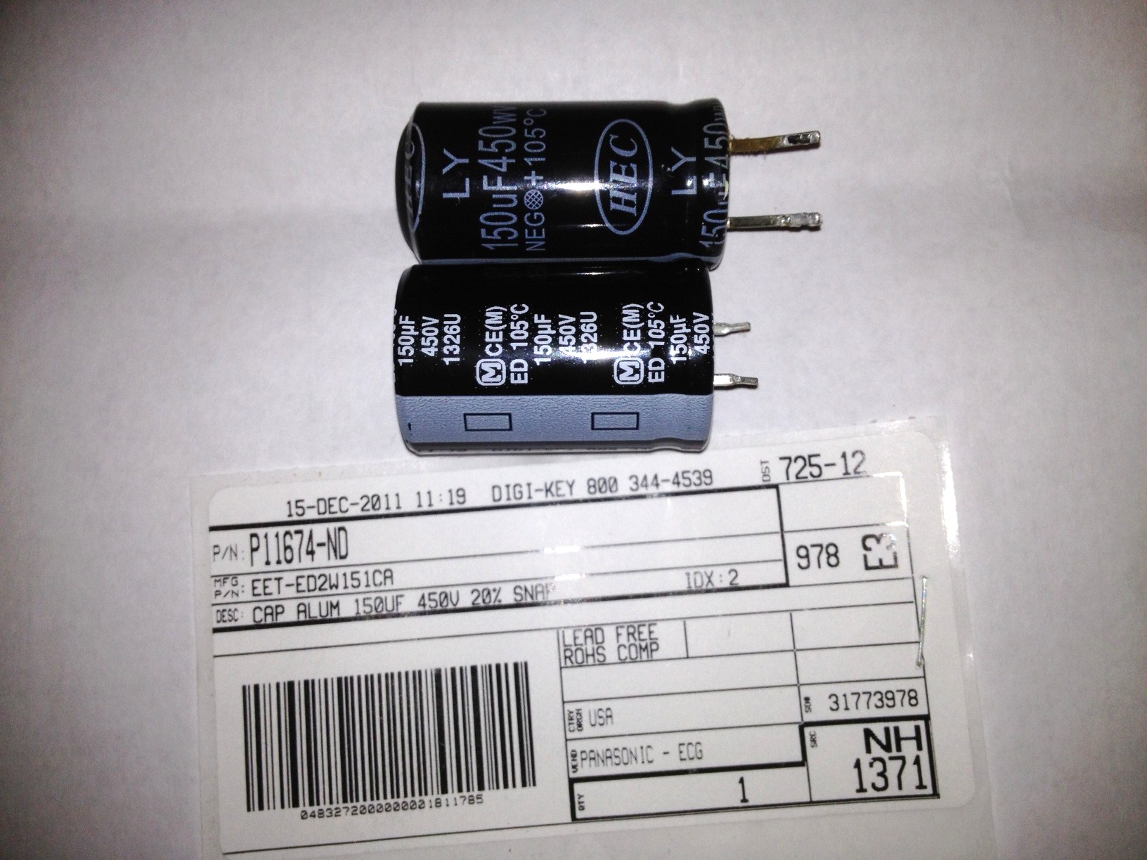

        I got my caps in today. I ordered the two brown ones and the big one suggested in post #94. The big one looks to have leads that are too short. It is also bigger around and a tad shorter. Anyone have a better suggestion for a part replacement or will this one work? It says 105C 150uf 450v 1326U on the one I received.
          Re: polaroid tv capacitor identification
          Ok. Now I'm looking at the browns ones and they look different too. I guess I wasn't carefully enough in getting the same parts. Do they have to be the same size as the originals? I will post pics.

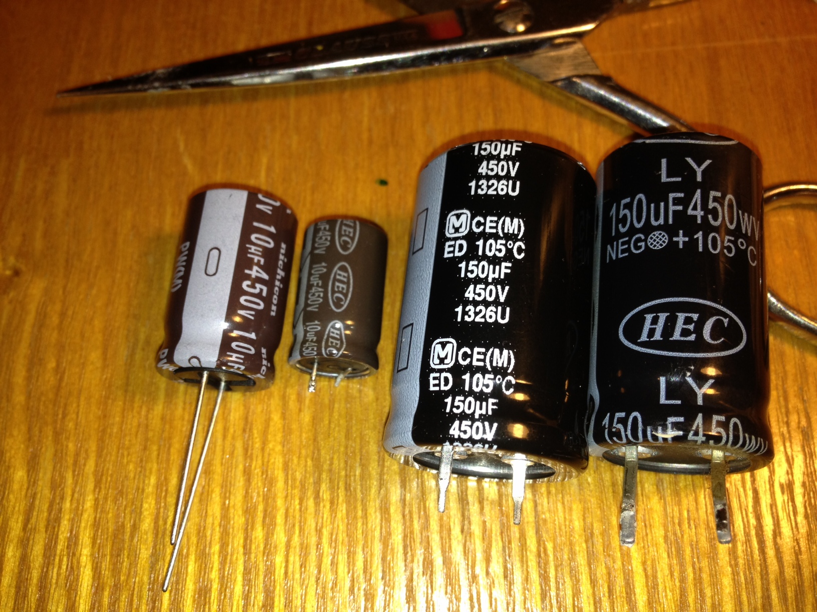

            Here is a picture of the original caps along with the replacements. I think they are the wrong ones for my TV. I am looking for the parts for the TDA-03211C. The large one on the right is the old one. and the small brown one on the right is the old one.

              More photos of the caps
                The critical parameters for replacement is to use a good quality (name brand) low ESR cap with the same capacity and voltage that will fit in the available space. As long as it will fit, it's fine to use it.
                As far as the cap whose leads are too short, cut the leads of the old cap as close to the case as possible. Wrap the ends of the original leads around the leads of the new cap and solder.

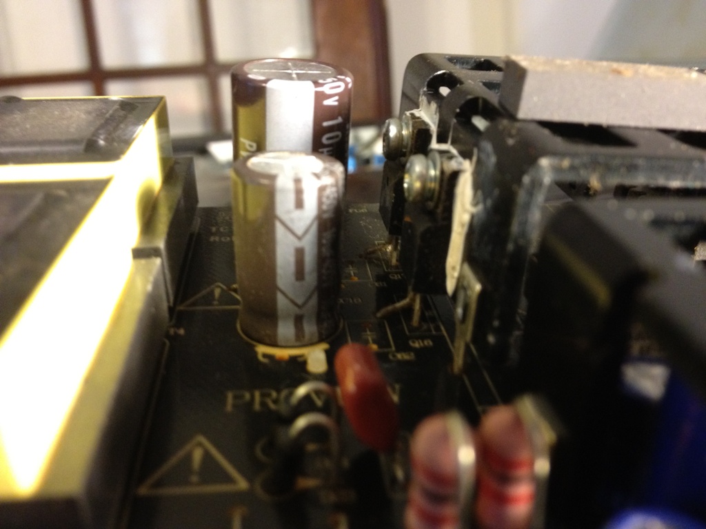

                  The 150uf is Panasonic and the 10uf is Nichicon. Are they good quality name brand? I can get them to fit. The 150uf should be fine after I extend the leads as you suggested. The 10uf will fit but is it a good idea for it to be so tall? Here is a pic of how it would look once installed. I just sat it in there to see. I am also attaching a doc of caps compared on Mouser's site. One is the one I received and the other is Panasonic. I would rather order the better ones for the job if the ones I have are not a good idea. Any suggestions?

                    The height should not be a problem.
                    I am concerned that you are only discussing the brand. Both the brand and series are important. Digi-Key carries 9 different series of Panasonic caps, Only three of them are suitable for use in an SMPS.

                            It's a little like asking "Who makes a better truck - Ford or Dodge?" Each will handle the jobs they are designed for and last a long time with proper care. Problems will occur if the task (towing a heavy 'fifth wheel' trailer) requires a Ford F450 series truck or equivalent and the buyer instead purchases a Ford F150 (little more than an open bed station wagon).
                            Nichicon, Panasonic, and United Chemicon all make excellent capacitors, and several series suitable for use as output filters in Switch Mode Power Supplies. They also make many other series that are not intended for that application.
                            The caps you purchased are being used in the input filter, and are suitable for that task.
                            PlainBill
                              Thanks so much for your help. I replaced the caps and it works great!
