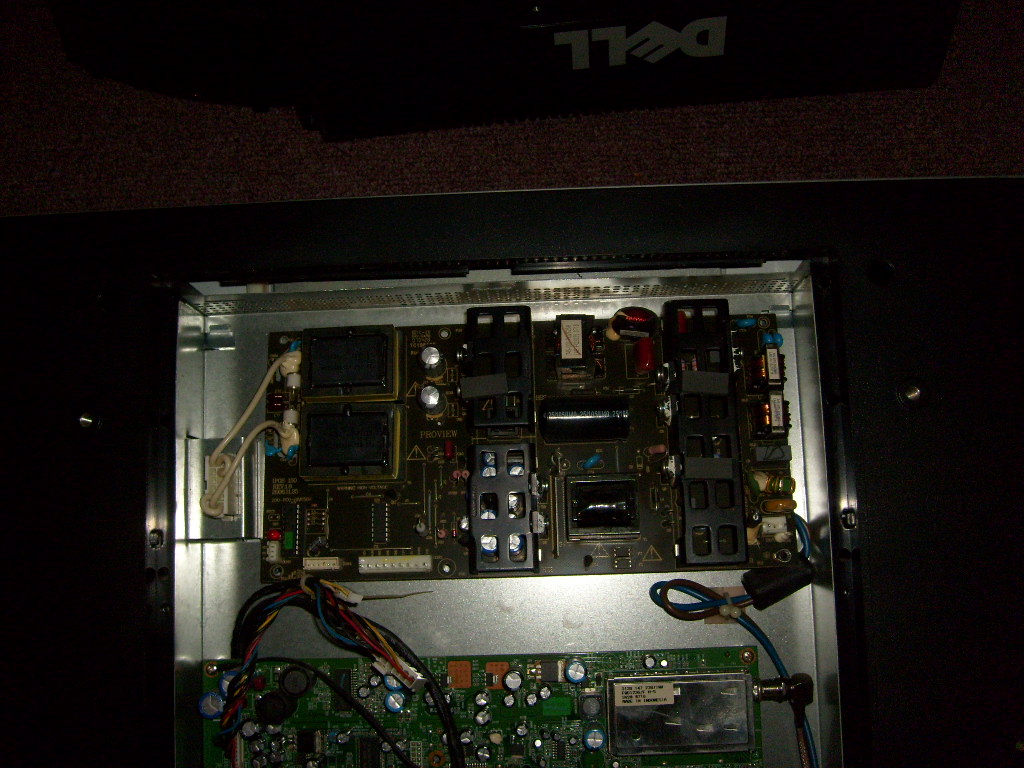

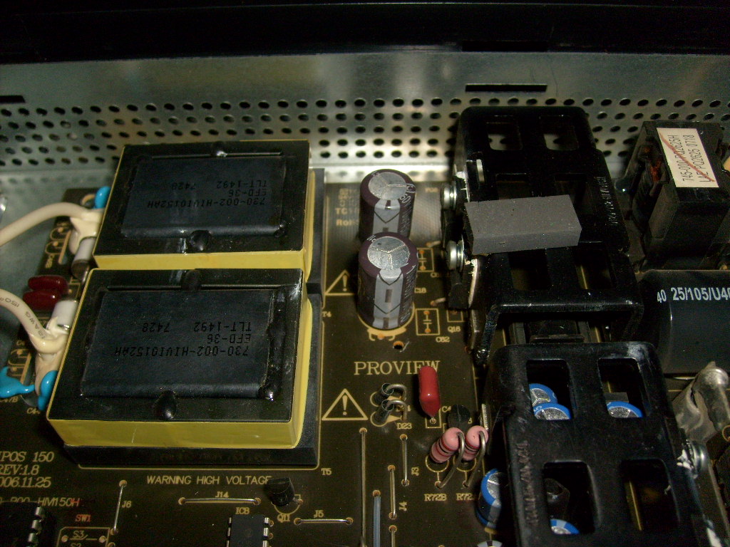

        This is a pic of the tv with the back open
        the arrow is pointing to the 2 caps the repair guy replaced. the top one that is missing is the one that popped and i pulled it off.
        I just have a hard time believing he used the correctly rated caps, the ones that he installed are 10uf 450V which seems kind of high. I found a few other sites where people have replaced their caps (same brand tv, maybe slightly older model) their original ones were 1000uf 10V. here are the threads

                  By location those caps are decoupling the inverter power line. 10 volts seems very low. I also see this power supply seems to have caps under the heat sinks - a horrible design. 'Designed to fail' comes to mind.
                  Looking at the pictures, it appears this power supply does not have a PFC front end.
                  Agreed before ordering new caps we have to know what the originals were.

                      How about a pic of the replaced/pulled cap so we can see the manufacturer, series, date code, and what damage was done to it?
                      The series will tell us the ripple, ESR, temp specs, etc. The date code will tell us how old the cap is.

                        this is all thats left of the cap. this is the one that the repair guy replaced.....so im pretty certain its not the correct rating

                            Is there any other writing on the other side on the cap? If yes, post pics again.
                            When you pulled the cap, was the negative side of the cap on the negative side of the board? Is the other replacement cap in the TV installed with the correct polarity? It looks like the negative on the board is pointing down. Do you see the cap stripe on the negative side?

                              yes, they were both installed correctly. I checked that first before pulling it off. there was nothing else on that cap, except for the dashes which indicated the negative lead.

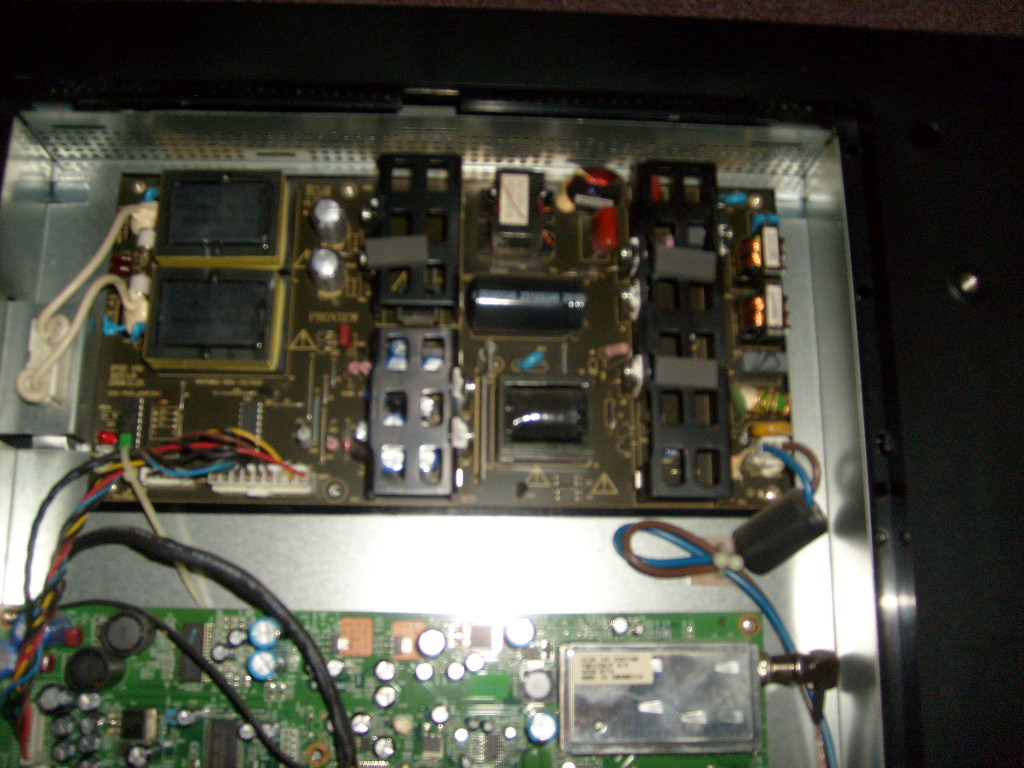

                                    Re: polaroid tv capacitor identification
                                    Rube,
                                    Here are some pics of the guts of the tv. They are not great but you will see the two psu are very similar...
