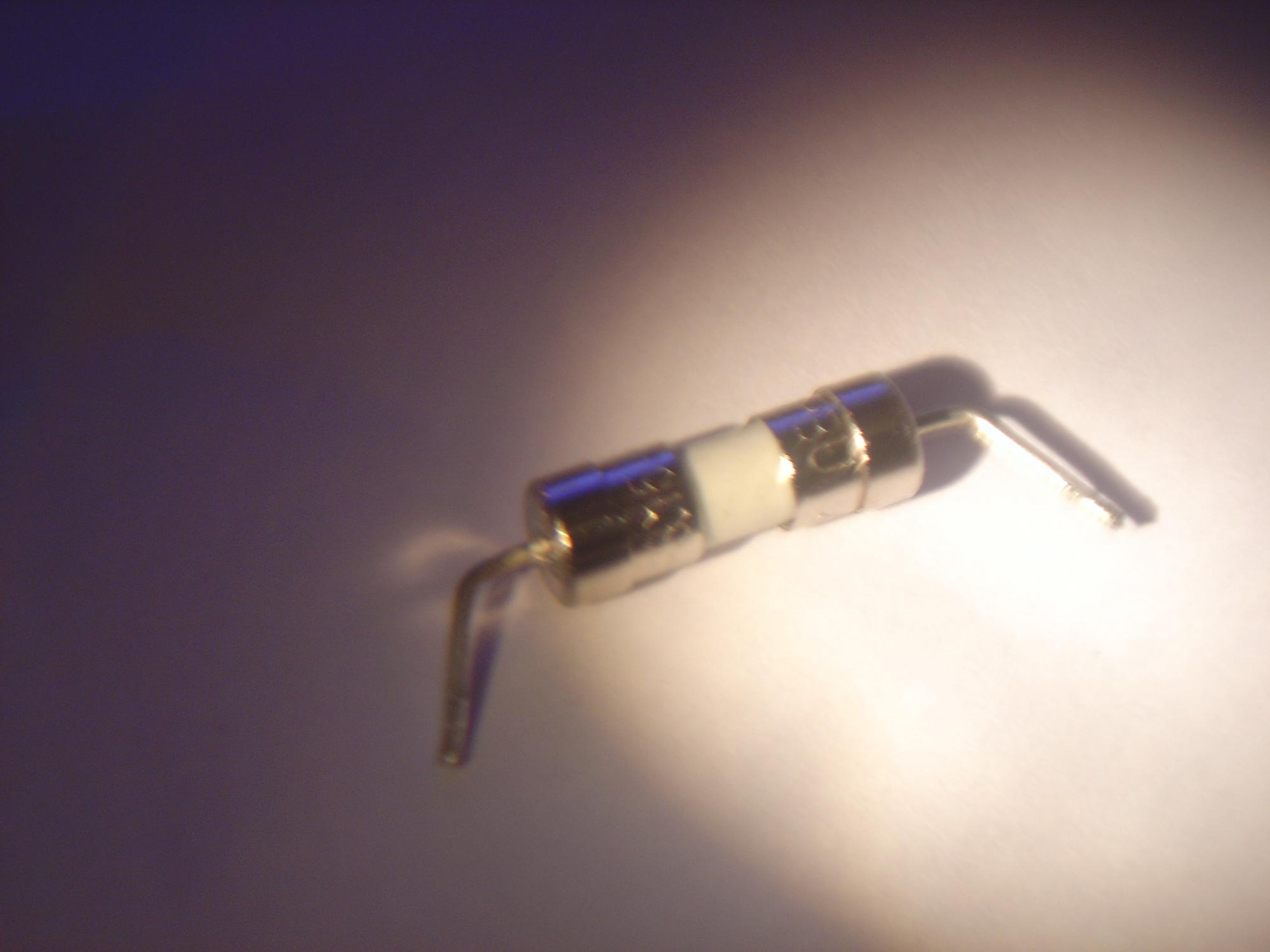

                                  Ok back from work. I received my 2 caps today waiting on some transistors, and now looking for this fuse. I looked it up on digikey by typing 3.15a 250v and get alot to choose from. I think its these S505-3.15-R. I hate to ask but any links to the correct ones??
                                    A clear focused picture (using manage attachments and not posted inline) of the old fuse would help. Also, measure the dimensions of the fuse.

                                    • LUCKY19

                                      #78
                                      Re: polaroid tv capacitor identification
                                      This is the best I can do with out the pic getting out of focus.

                                        #79
                                        Srry I have only a regular measuring tape, it measures 7/16

                                          #80
                                          It looks like Digikey F3298-ND would be a good replacement; this is a time delay fuse.
