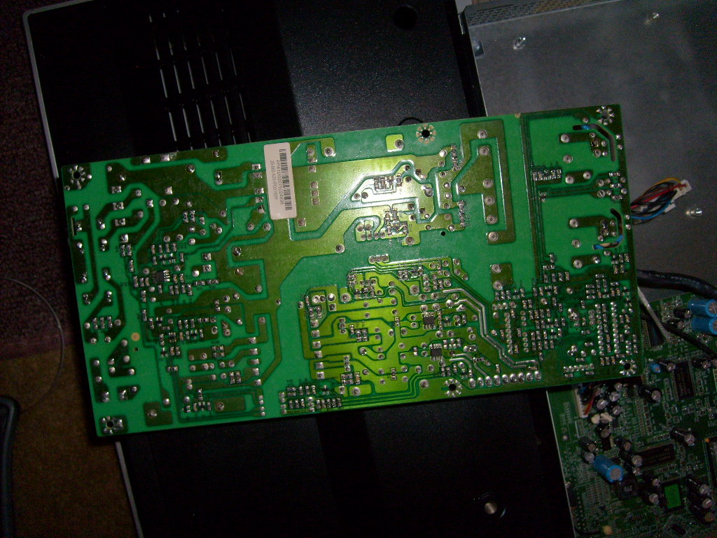

      Originally posted by elbtax
      Rube,
      Here are some pics of the guts of the tv. They are not great but you will see the two psu are very similar...

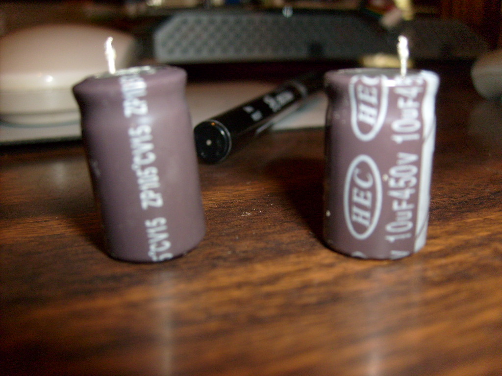

      Nothing wrong with the quality of those pictures, What is the information on the caps themselves (voltage, value, brand and series)?
      PlainBill
        Re: polaroid tv capacitor identification
        PlainBill
        maybe im crazy, but I can make out 10uf 450V on those caps lol.but in any case elbtax pm'ed me with the specs. they are rated at 10uf 450V

                I have the same TV with the same problem, but my caps are originals. HEC brand, 10μF 450V. Printed on the other side is ZP105°CU42. What caps will be good to replace these?

                    They are about 7/8" by 1/2".

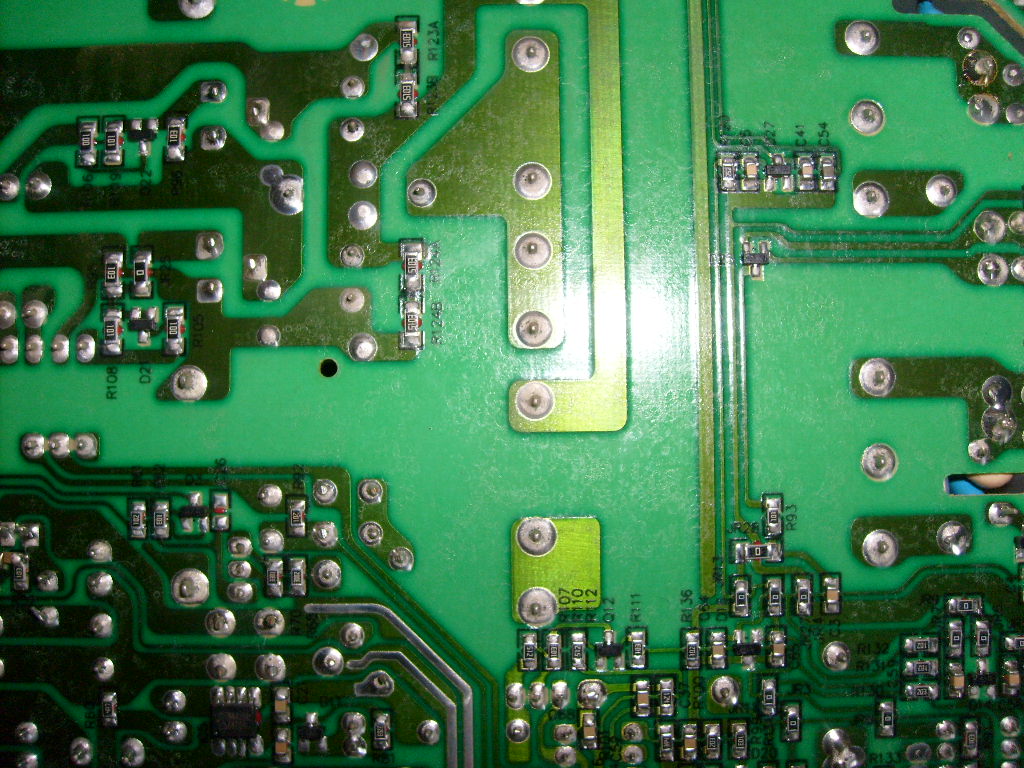

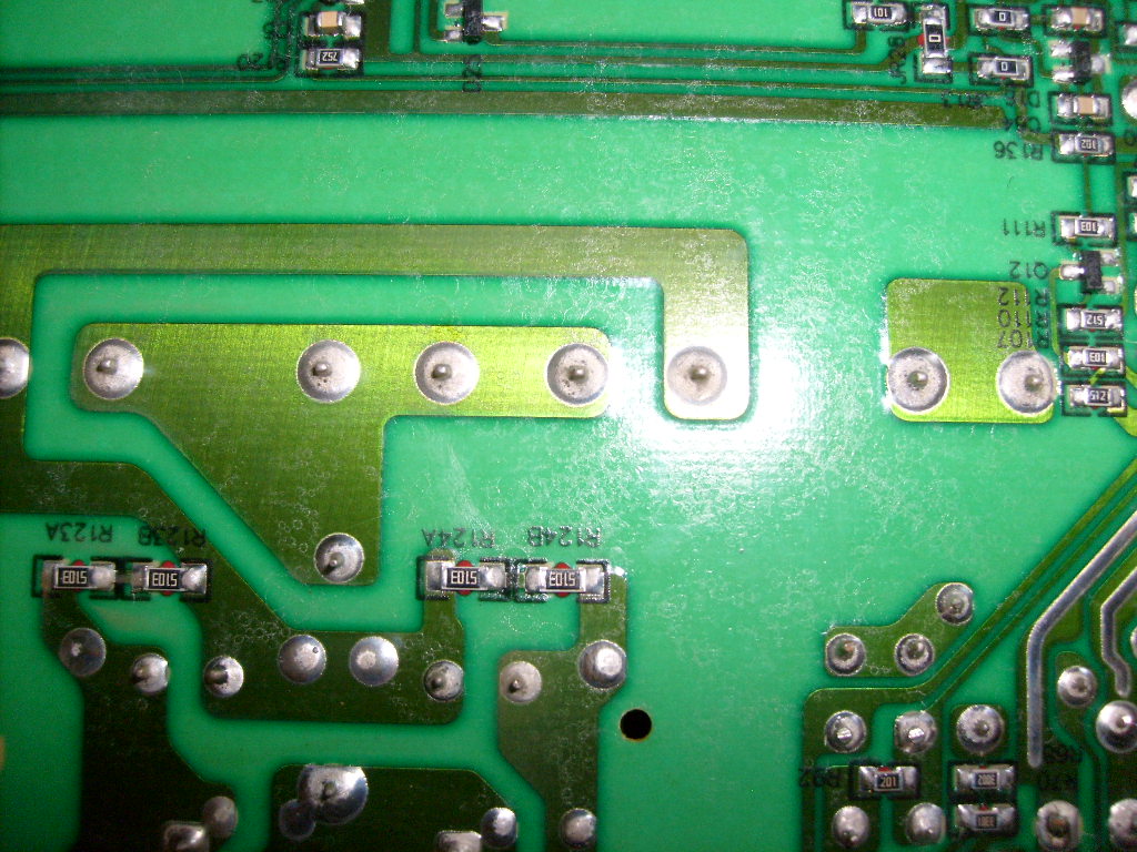

                            I ordered the panasonics. Here are pics of the solder side. Notice the grey looking solder joints. (Pic3) I haven't reflowed yet, Probably today cause parts should be in on the morrow.

                              The originals::
                              SONJIU ELECTRONIC ENTERPRISE CO., LTD.
                              KM Series
                              http://www.sonjiu.com.tw/style/conte...0095&id=223991
                              The ripple shown is is 87 on those.

                                    is it just me or does the primary filter cap in the 2nd pic of post #4 look like it's about to blow out the top?
                                    could be the photo, but i doubt it with that much of a dent outwards.
                                    may also explain why the other caps failed.. (?)

                                          I replaced those 2 caps today, took like 5 minutes....TV works fine again. no strange noises or anything either!
