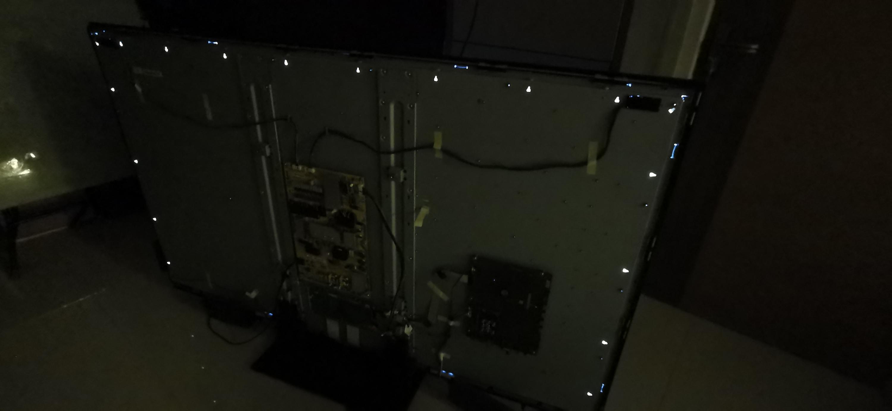

    With jumper wires on:
    PD-15 (BU5V) ----- 14 PS_ON ( turn on UR13.2V )
    PD-15 (BU5V) ----- 16 PNL_POW (turn on PNL12V )
    PD-15 (BU5V) ----- 24 (STB) ( turn on BL_ on ) IC7700
    PD-15 (BU5V) ----- 21 OFL
    *PD-15 (BU5V) ----- 19 Dimmer (983ohm resistor)
    PD Connector:
    PD-1 (PNL12V) : 11.92V
    PD-2 (PNL12V) : 11.92V
    PD-3 (SGRN) : 0V
    PD-4 (SGRN) : 0V
    PD-5 (UR13.2V) : 13.05V
    PD-6 (UR13.2V) : 13.05V
    PD-7 (UR13.2V) : 13.05V
    PD-8 (UR13.2V) : 13.05V
    PD-9 (SGRN) : 0V
    PD-10 (SGRN) : 0V
    PD-11 (SGRN) : 0V
    PD-12 (SGRN) : 0V
    PD-13 (AC_DET) : 3.27V
    PD-14 (PS_ON) : 4.95V
    PD-15 (BU5V) : 4.95V
    PD-16 (PNL_POW) : 4.58V
    PD-17 (NC) : 0.04V
    PD-18 (NC) : 0.04V
    **PD-19 (DIMMER) : 4.55V**
    PD-20 (NC) : 0.04V
    *PD-21 (OFL) : 1.74V*
    PD-22 (ERROR) : 0V
    PD-23 (NC) : 0.04V
    PD-24 (SBY) : 4.3V
    Added PD-15 to PD-19 with 983ohm resistor and read 4.55V, and value of PD21 changed from 0V to 1.74V.
    Still the same - screen flashes for a split second then off.

      These SHAPRs have bad contacts (connectors) on the LED strips (you need to solder them)

              So I re-soldered all the pins of L1 and L2 connectors.
              Some of the pins has got tiny bubbles when heated up, not sure if those are signs of bad contact?
              But now it doesn't flash at all... Value of OFL changed from 1.74V to 0.8V, all others remain the same.

                check again yours soldering work that no short between pins...
                remove the dimmer jumper they will flash again

                  Cleaned up my shoddy act on L1 & L2, and Tada - BL ON!! Such a beautiful sights!!!
                  Thank you every one - your guys are magicians to me
                  And yes sir - waiting for my MB.

                                After a good night sleep rejoicing the romantic backlight, we thought of summarizing which PD pins must be jumped in turn on the BL. So a created a matrix, and start testing each combination.
                                To my horror - none of the combinations work and no more BL!!!
                                After several trial and errors - all jump wires are with 850ohm resistor, and only one with 983ohm, and it turns out, PD-21 OFL on only work with this 983ohm resistor, not the 850ohm ones!
                                Also, PD-19 Dimmer is not necessary for this work on also.
