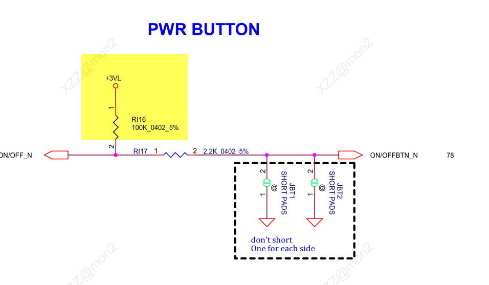

                          mon2 i found out tha if i connect the daughter board the chargere is getting to 20v but the laptop powers on and shutting down
                          i found that if i press the SW1 whih is the novo n switch on the board the laptop turns on but if i stop holding the laptop shuts down, any advise?
                          • mon2
                            • Dec 2019
                            • 14522
                            Review the pull-up resistor and its voltage on the power button. This on/off line should be parked to a logic '1' state when the button is OPEN / not pressed. When pressed, this line should go to logic '0' to enable the logic board (ie. active low signal).
                            • koby058
                              • Jan 2017
                              • 387
                              • israel
                              On the power button i see 3.26v and go to zero when button pressed
                              just to make the current status clear: when i connect the laptop to AC without battery, the KB light and caps lock light is on, after a minute the laptop is going down and back up (probably it is the bios init process), when it turns on i can see the lenovo screen with some message that it is "finishing update do not power off" and immediately it shuts down.
                              when it is in this bios init process (without pressing the novo N button) i see the voltage on the power button fluctuating
                              but if i short the internal switch (novo_N) it is starting to work and trying to boot OS but the original power button does not work .
                              what do you think ?
                              • mon2
                                • Dec 2019
                                • 14522
                                Ok - did not know this. Appears to me to be a corrupt bios image where the power was lost / removed during a critical time of the reflash process. You may have to remove and reflash the target device out of circuit and then test again.
                                • koby058
                                  • Jan 2017
                                  • 387
                                  • israel
                                  I have rewrite a new bios (two chips) and also rewrite the EC image using i2c with SUCCESSOR
                                  My opinion is that the fact that the laptop working while the novo button is pressed (or shorted) maybe means it is not related to bios or EC firmware.
                                  what do you think?
                                  • mon2
                                    • Dec 2019
                                    • 14522
                                    But do you see the same message upon when it turns on?
                                    • koby058
                                      • Jan 2017
                                      • 387
                                      • israel
                                      Yes, same message, using the normal power button or the novo N without holding it, will show it for a sec and turn off.
                                      holding novo will show it for 20 sec and then try to boot or asking for boot device
                                      https://drive.google.com/file/d/1pdT...ew?usp=sharing
