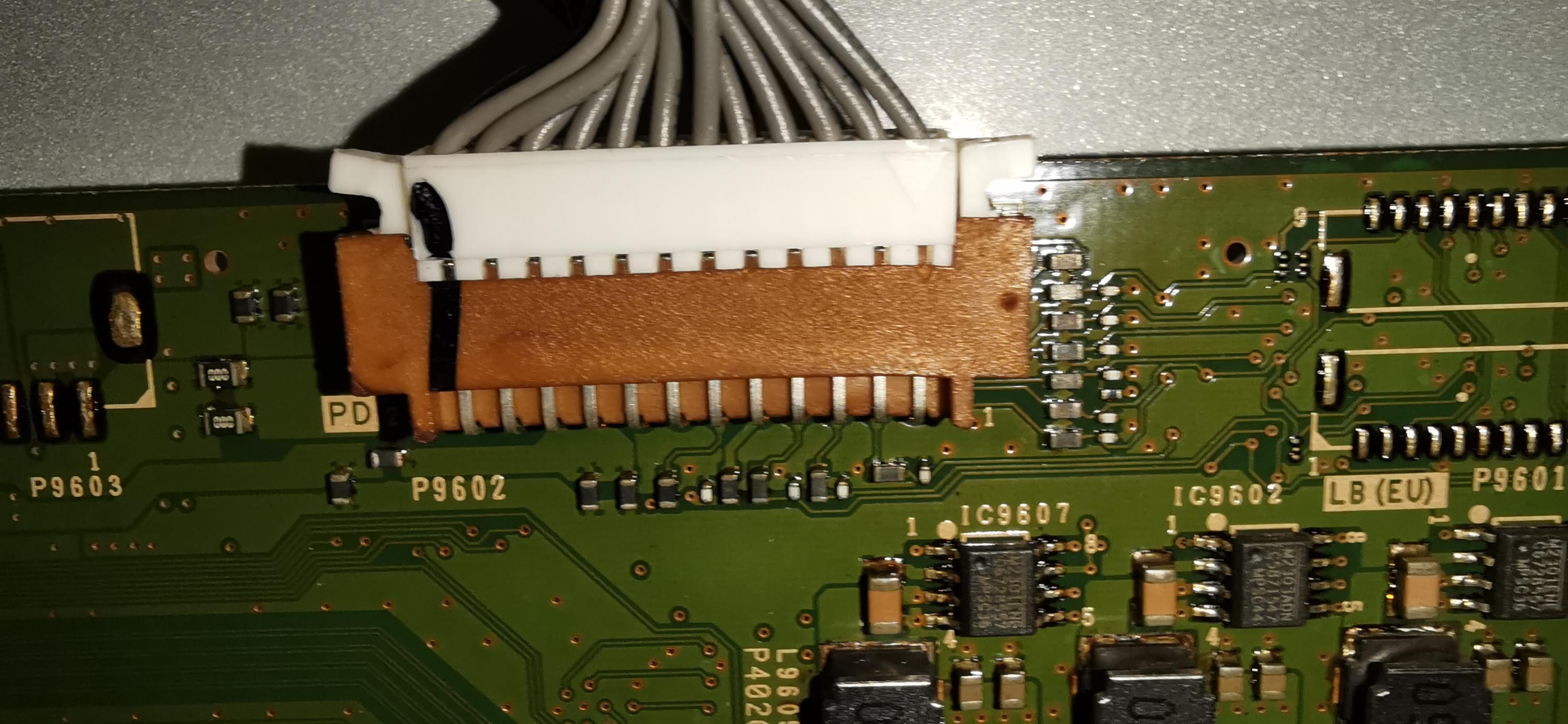

          1) Screen ribbon cable unplugged from T-Con, power on normal - no change flashing 2x red flight
          2) While screen ribbon cable unplugged, pressed Vol- & Chn-, powered up: no change flashing 2x red light.
          Will do the oven bake tomorrow morning, then redo these various procedures.
          Thank you, and good night.
          Baking in oven at 250C 12min, off oven open door slight to cool for 20min, took out and cooled to room temperature. Man, it stink!!
          All the white plastic connector turned brown... I think the PD connector deformed and not able to get a tight-fit clicked connection anymore.
          Seems like intermittently connection problem now. On powered up -the power indicator 2x flashing sometime there sometime not. After a few hard reseat, it eventually failed and not able to get power up indicator anymore...
          And when able to get power up 2x flashing red light, did all the reset procedures: Vol- & Chn-, Vol+ & Chn-, etc. all the results are no difference from those before back, including those voltages when reset to green led light.
          So, I guess the MB is truly toasted, time to move on the get a replacement MB now.

            Re: Sharp LED TV flashing green 2x per second - LC-70LE735X, DPS-222BP, RUNTKA857WJQZ
            so the BGA issue at main IC became more.. use hotair gun to toast the mediateck chip only... who knows could catch solder point.

                              Shopping for a replacement MB:
                              This one from TaoBao is the closes I can find:
                              Model: LCD-70LX732A MB: QPWBXF733WJN2 Panel: LK695D3GW30C
                              Original:
                              LC-70LE735X MB: QPWBXF733WJN2 Panel: LK695D3GW3AD
                              You think this will work?
                                what are the 5 letter numbers on the white sticker on the original mainboard?

                                  #76
                                  This white sticker?

                                    #77

                                      #78
                                      yes, that must be it, if you can match those f733wek6 or f733k6, you should have a match, as far as other boards working, I don't know.

                                          #80
                                          https://www.bukalapak.com/p/elektron...35x-lc70le735x
                                          This part link provided by Diah looks like identical to my original MB, but it's 10x more expensive the the close-look from China.
                                          I think I will try my luck with this cheap one.
