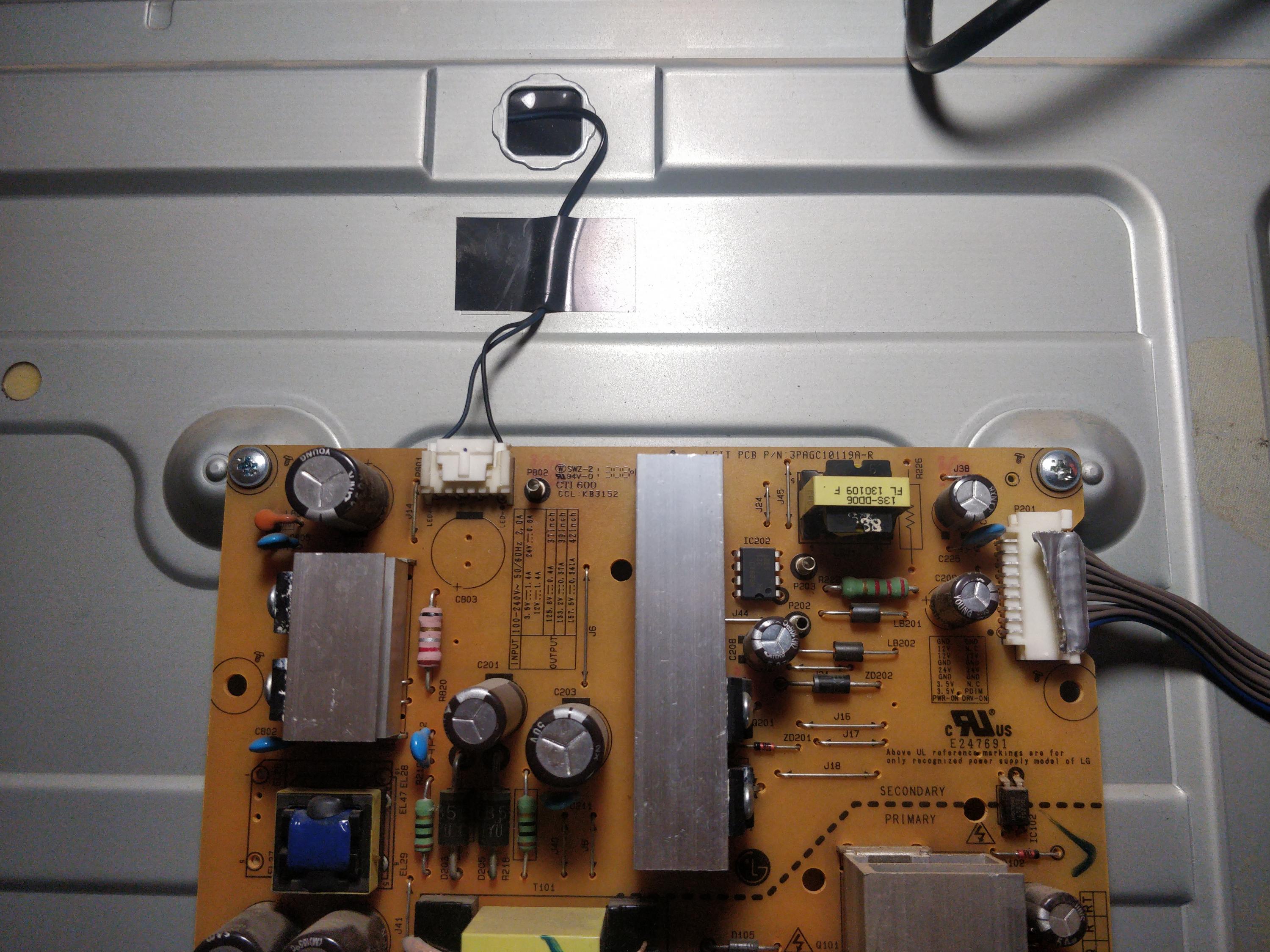

    Hello everyone, I have an LG 39LN5400 with a no power problem.
    I plug in the TV and the power led flashes twice. No screen, no sound. Also no reaction to power button/remote.
    I checked the PSU output values and while the output towards the mainboard is OK the output to the LED backlight looks weird.
    The output table shows 133.2V for the 39inch version.
    I measure 107V on the + and -42V on the - side of the connector.
    What should I check next?
    Is the backlight faulty and I should dissassemble the screen or is it the PSU?
    Thanks in advance!

    unplug the connector and measure the pins, see what you get.

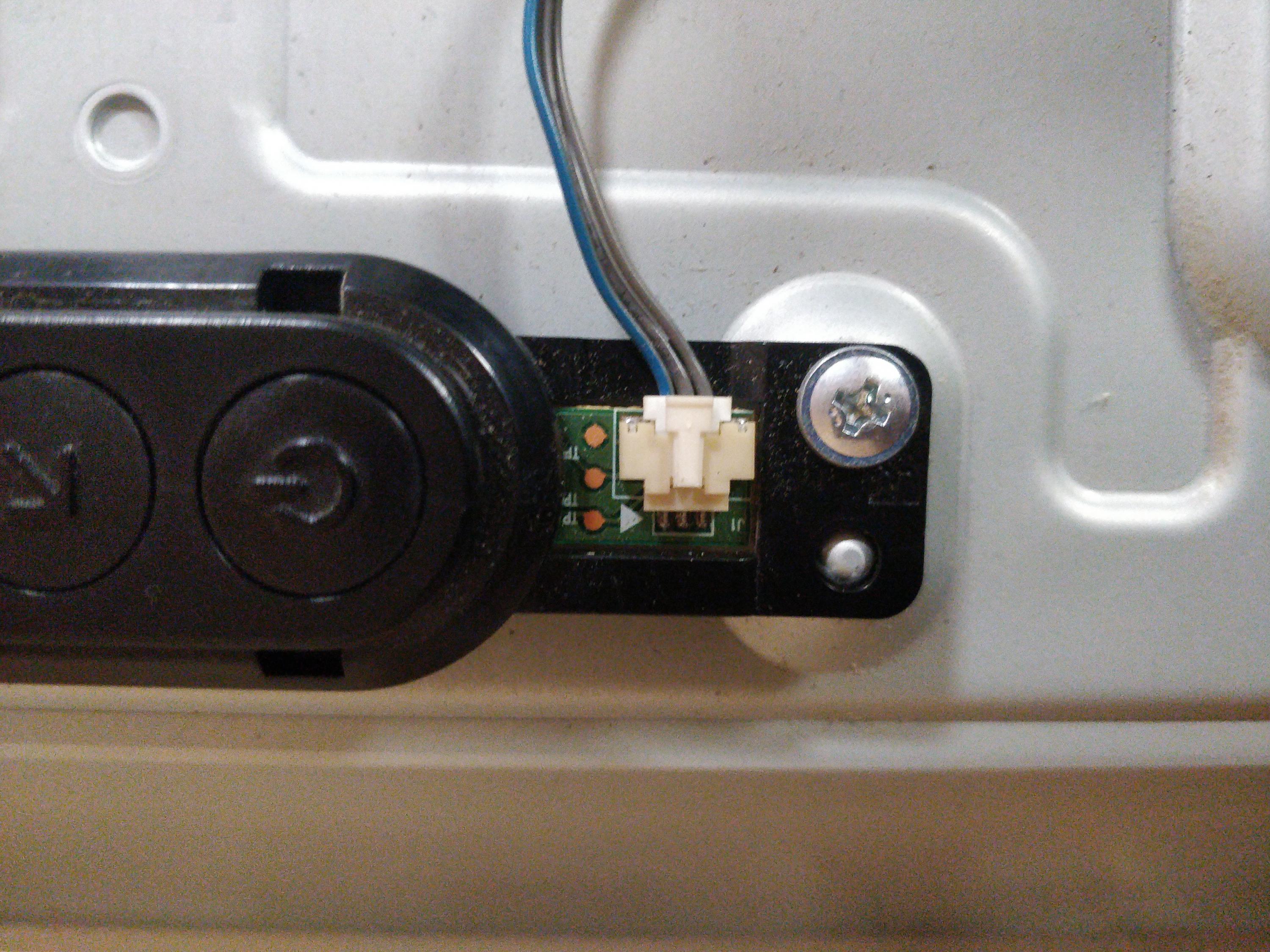

      What do you get on your pwr-on pin when up press the power button? Are you getting backlights?
      • unimatrix93
        • Oct 2021
        • 347
        • Magyarország
        Re: LG 39LN5400 no power
        I get 0v on the left pin (blue wire). 3V on the middle and the bottom one and the right one drops to 0.5V when I press the power button.
        I have no backlight at all.
          I get 109V on the + pin and 0V on the - pin with the backlight disconnected.

                What is voltage on pow-on pin on the power board when in standby and after you push power on.

                      By Pwr-on pin you mean the AC connector's pin or something else? Sorry for the confusion.
                                Sorry, I found the PWR-ON pin.
                                It's always 3V, doesn't change even If I press the power button.

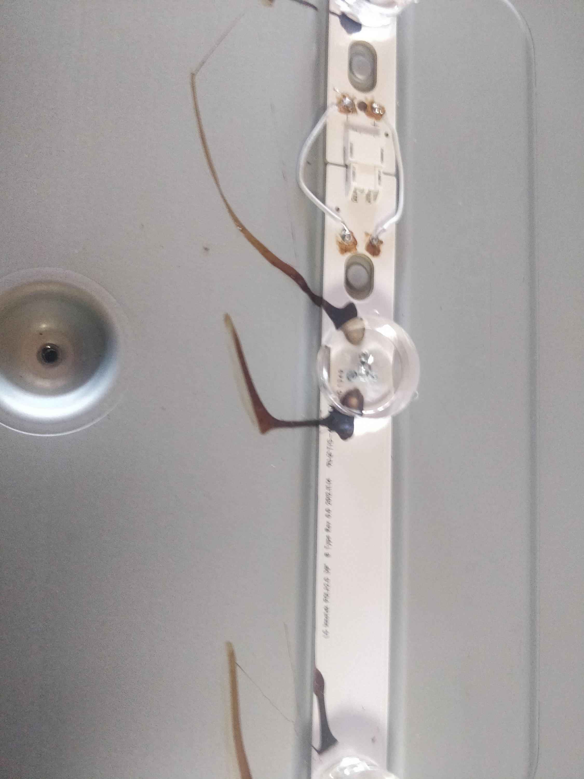

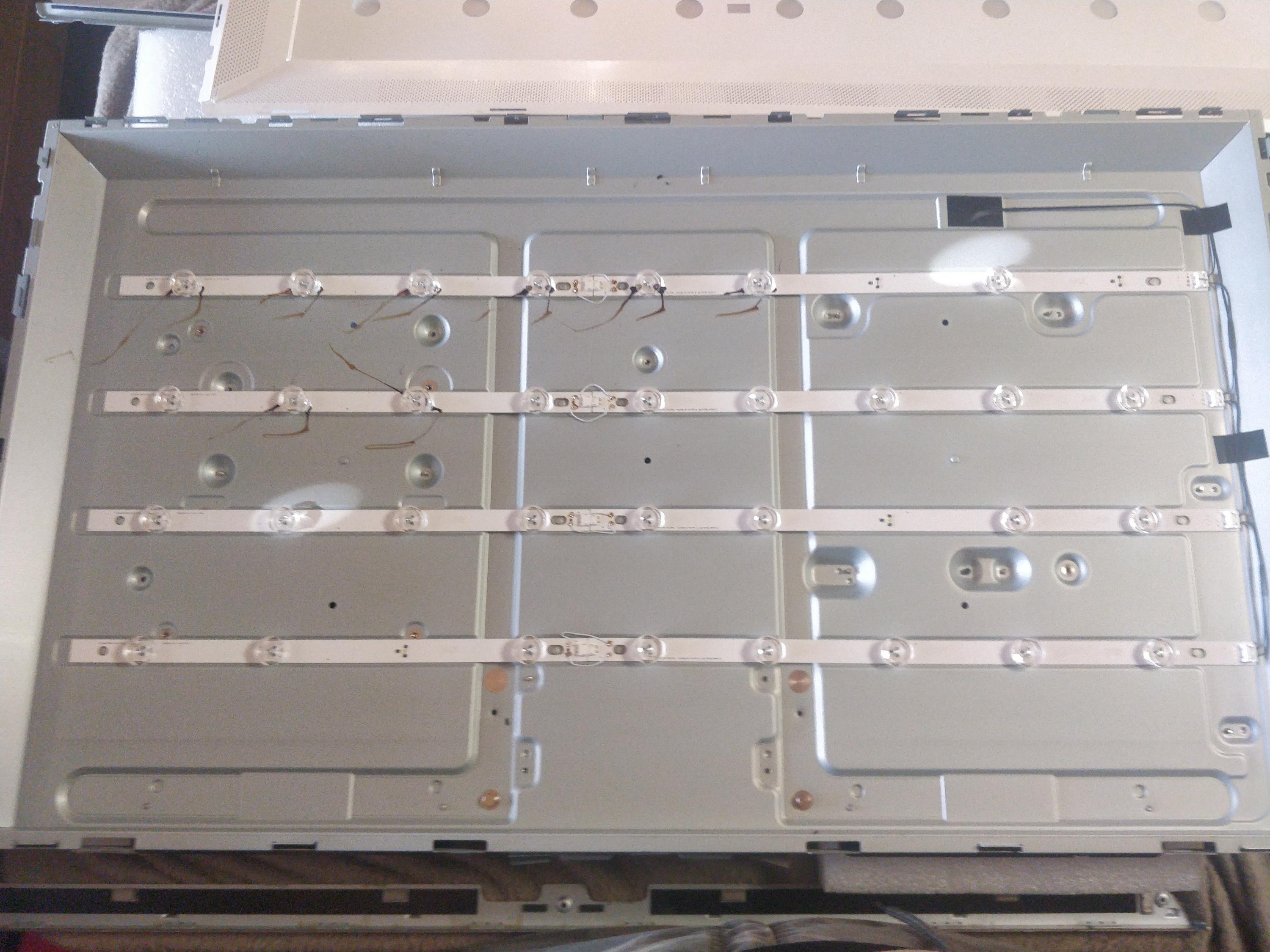

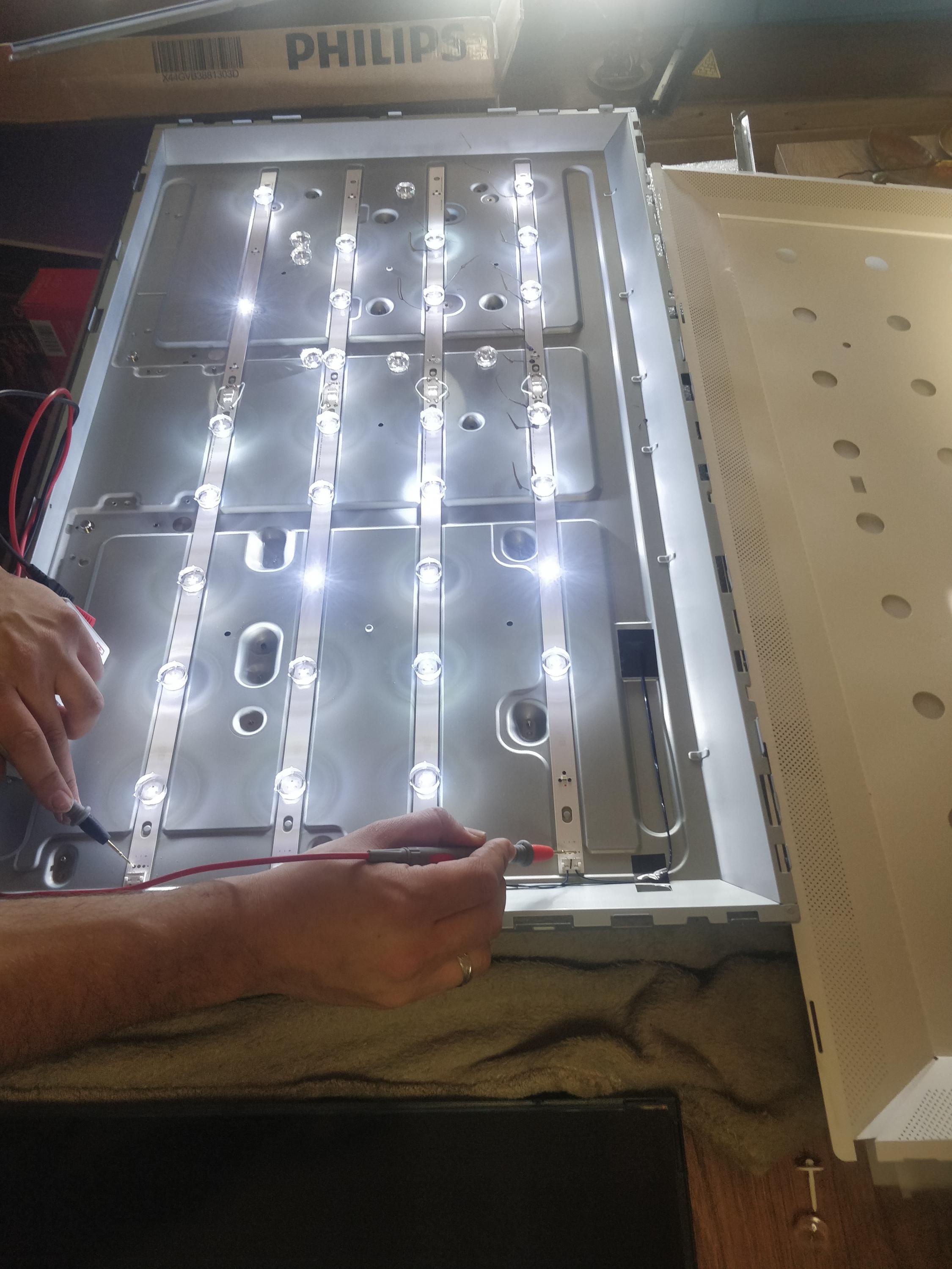

                                  So I took apart the screen and the first thing I saw was the brown/burnt like residue around some LEDs:
                                  After using my tester I found multiple dead LED beads.
                                  Now I'm searching for new 2835 3V LEDs beads locally, hope I can find some.
                                  What do you guys think?
                                  Is this the cause of the problem or the MB?
                                  • nomoresonys
                                    • Jan 2013
                                    • 12206
                                    • U.S.
                                    i think so, you should probably replace all of the leds, because they are all the same age and its just a matter of time and probably sooner than later, before more go out/fail.

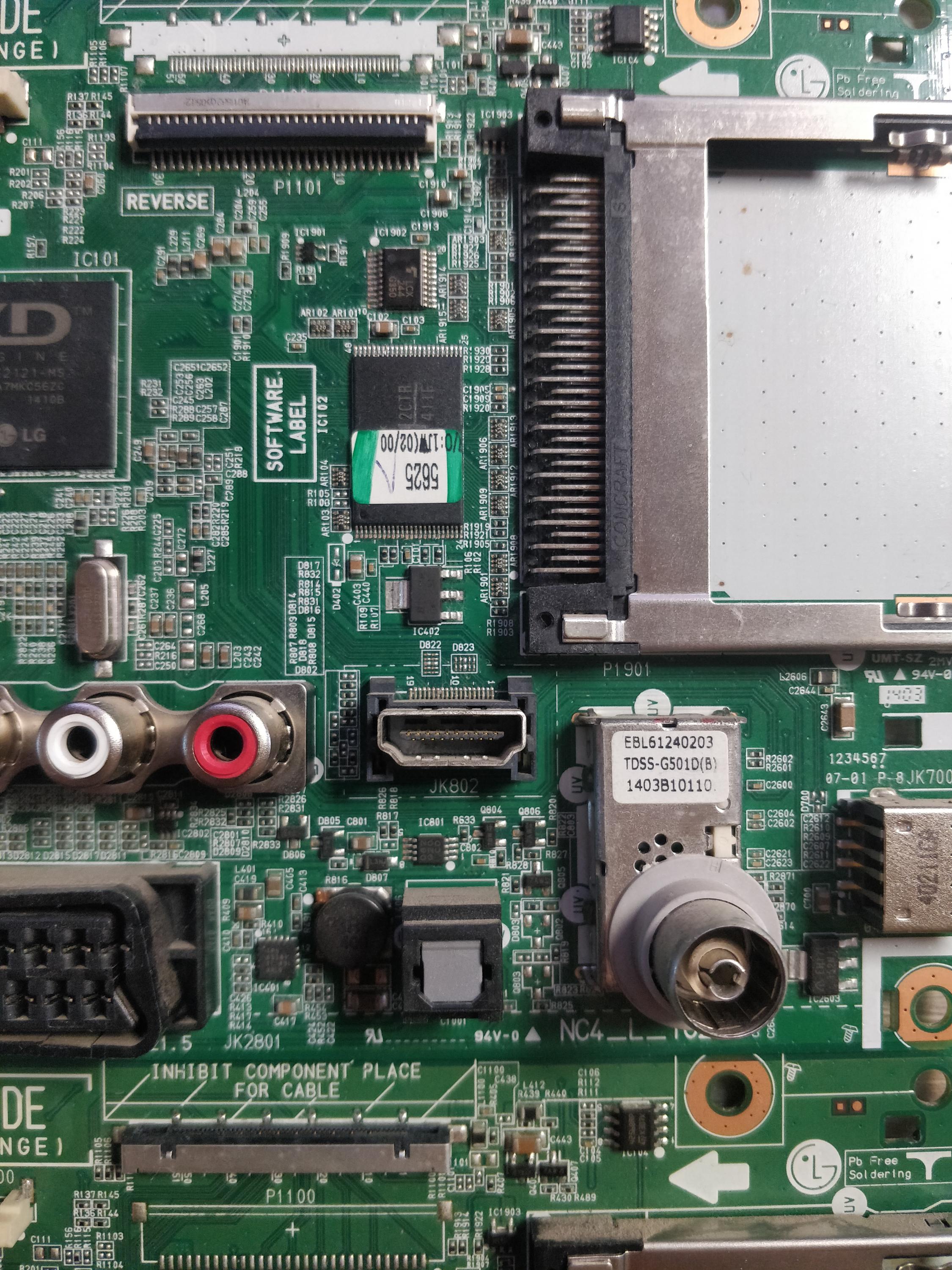

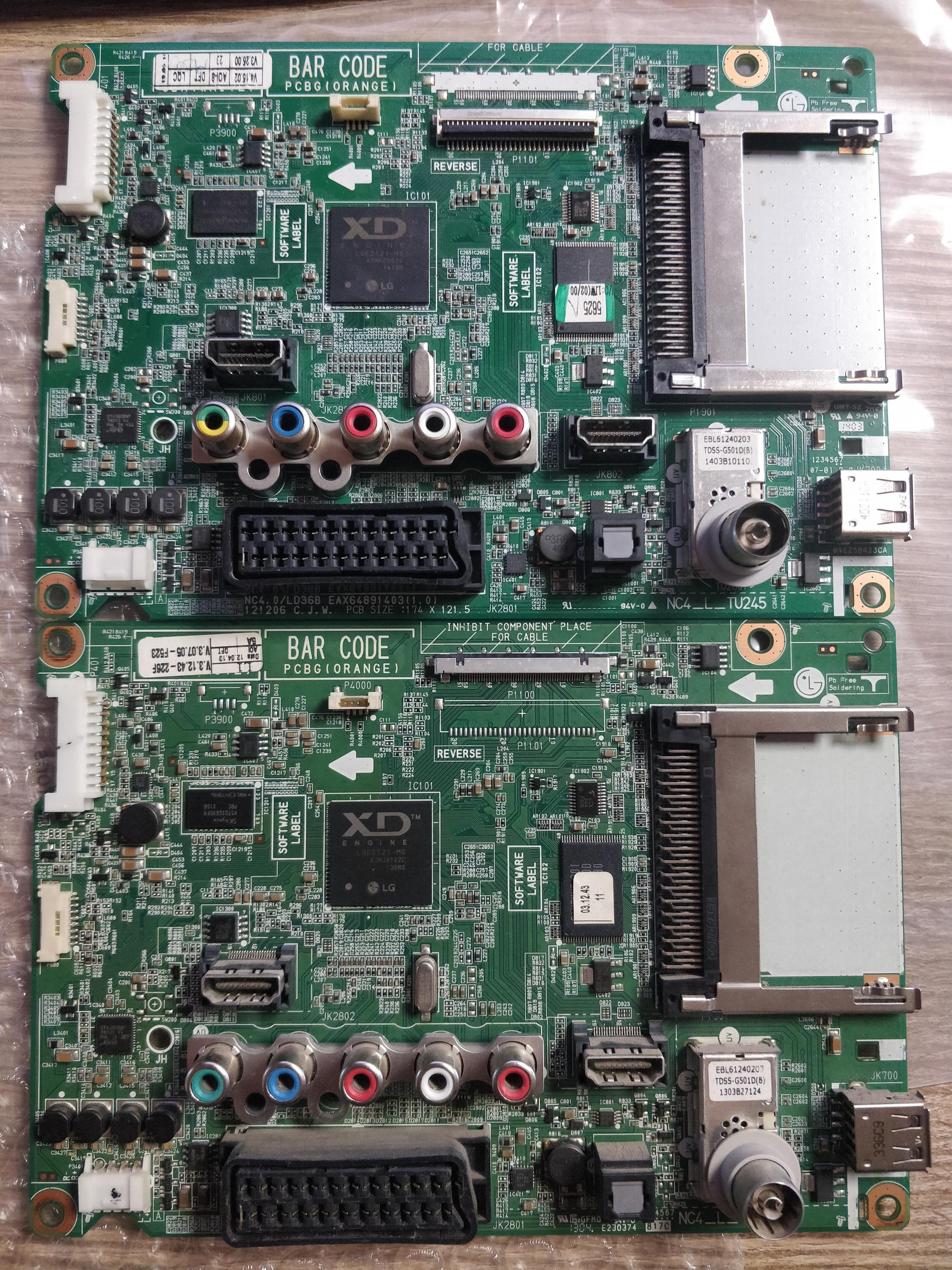

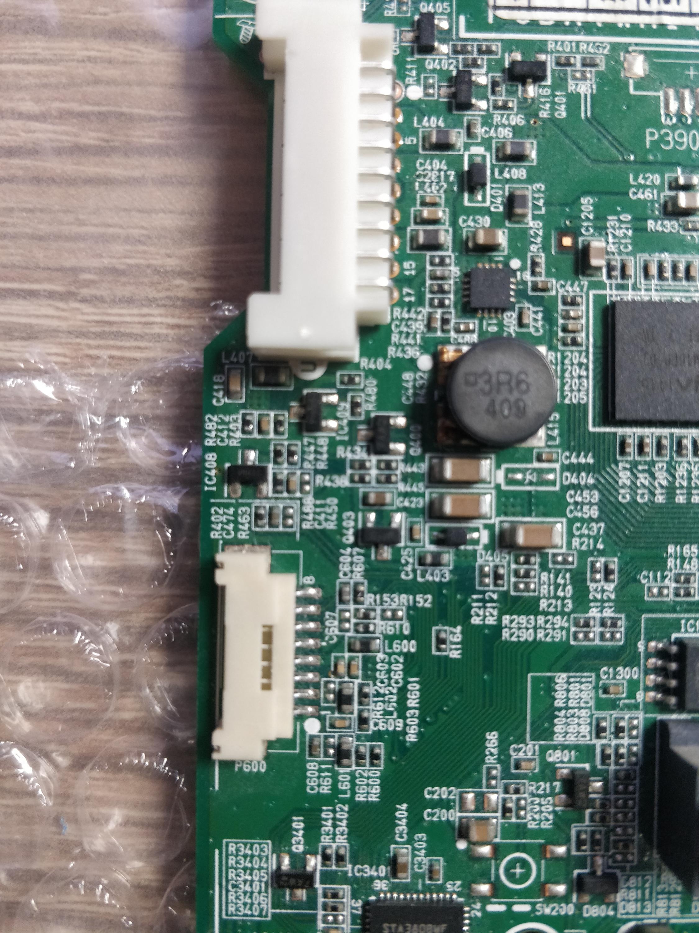

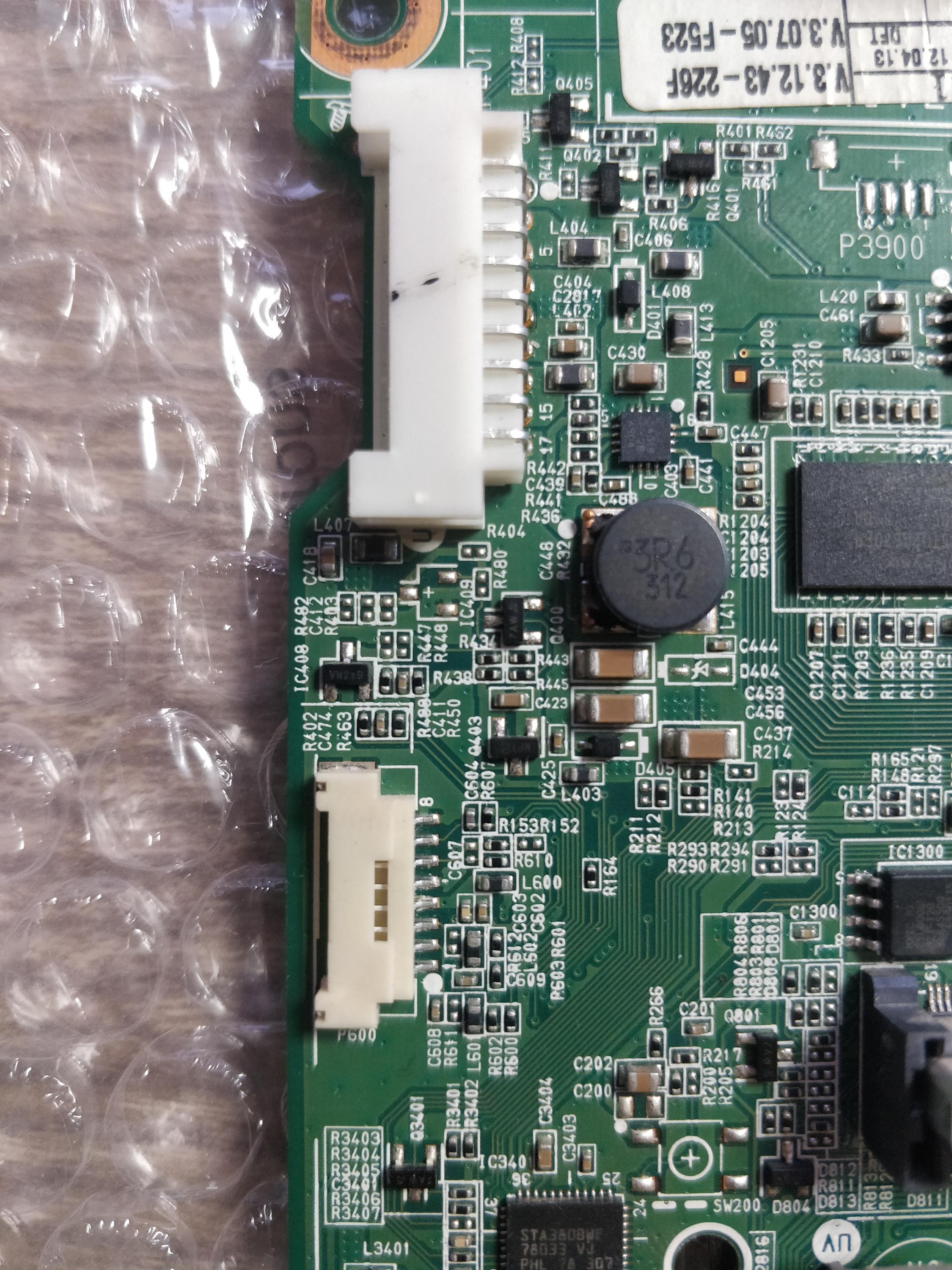

                                        I ordered a new mainboard with the same specs, but the LVSD connector and some caps/resistors are placed differently.
                                        I ordered one, because the LG CPU is most probably shorted, it gets blazing hot as soons as I turn on the TV and also the PCB is yellowish under it.
                                        As far as I can see, everything else is the same (CPU, ICs, etc).
                                        What should I do now?
                                        Transfer the LG CPU from the new board to mine, its a BGA chip.
                                        Or transfer the LVSD cable and the caps/resistors to the new board?
