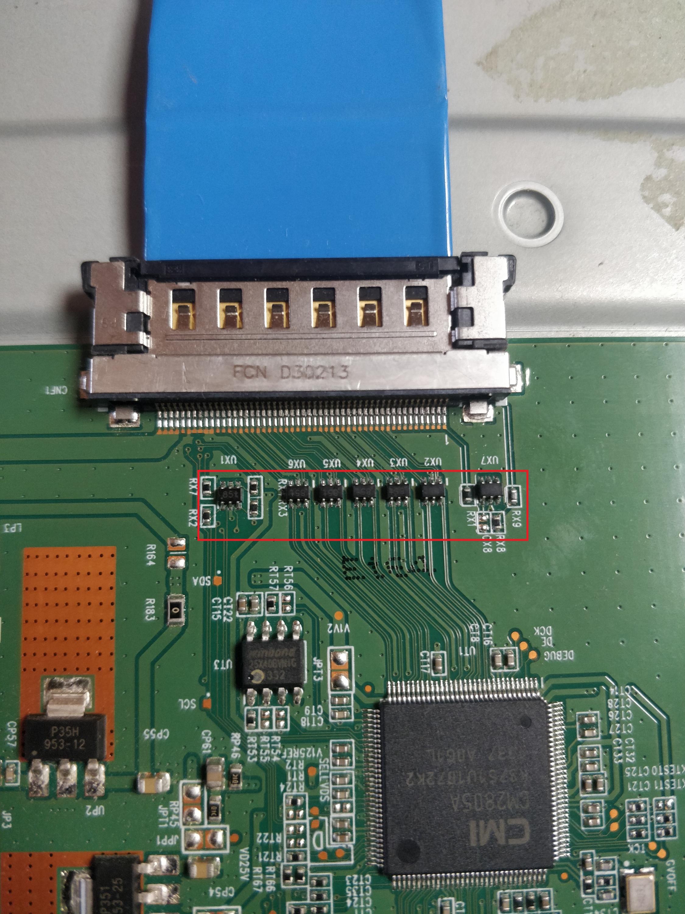

            I succesfully transfered the connector and the other components to the new mainboard.
            The TV is now turning on, backlight works but I have a black screen.
            I measured 12v, vgh 30 and lgv -8V on the TCON and when I disconnect the left/right side of the LCD they turn white according to the disconnected sides.
            What could be the problem?

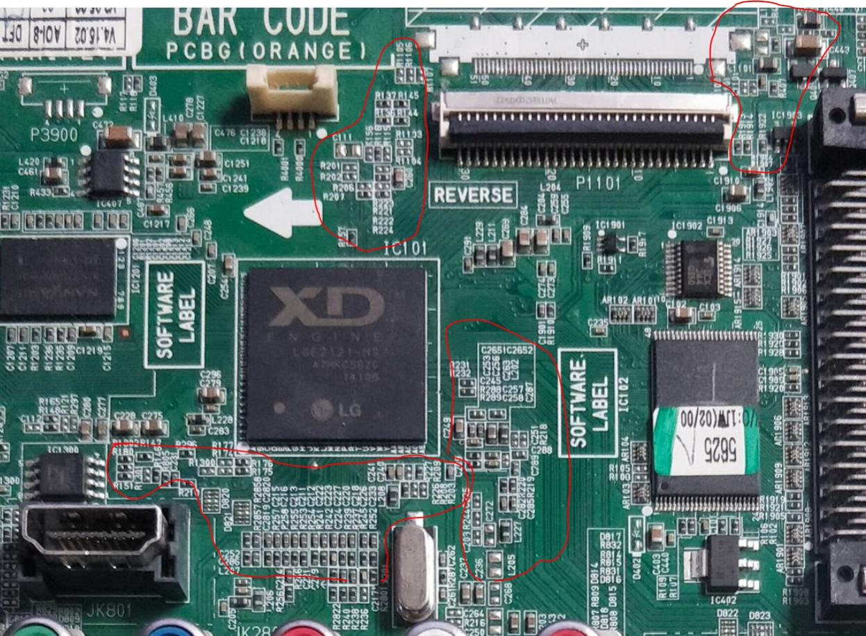

                              I fixed the backlight, which did not help. After that I narrowed it down to the main board as other guys suggested. The SOC is burned on the original mb so i ordered a new one which turned out to be for the same series of LGs just a smaller one.
                              I transferred the LSVD connector, so I transferred the lvsd connector and some caps and resistors to match the og board. Everything else is 100% same on the new mobo. ICs, markings, everything. I even checked if the vias are leading to the same points with a DMM and my microscope...
                              After that the TV turned on successfully but with black screen. Backlight works too. I couldn't find a short on the TCON/Riser either... I was thinking about transferring only the SOC but I never done BGA before and I'm afraid a screw it up

                                #35
                                Re: LG 39LN5400 no power
                                Compare these places and rearrange the resistors, as it was on the native board.
                                • lotas
                                  • Jan 2016
                                  • 4880
                                  • Russia
                                  #36
                                  But first, you should find out if your T-con is working (check the voltage at the test points), and there are no short circuits on the matrix bars, some T-cons can be driven into test mode.

                                    #37
                                    I found a few differences:
                                    IC1903
                                    OG: HD38D
                                    NEW: HS40C
                                    Should I replace them?
                                    Also there is no resistor on R176 on the OG board.
                                    R226 is on R227 on the OG.
                                    The Tcon panel and the matrix should be okay, voltages were there and the I couldn't find any short either.
                                    • lotas
                                      • Jan 2016
                                      • 4880
                                      • Russia
                                      #38
                                      I don’t know about IC1903, I need to compare datasheets, what’s the difference. Look at the resistors where it should be, solder it where it should not be, then remove them.
                                      • lotas
                                        • Jan 2016
                                        • 4880
                                        • Russia
                                        #39
                                        T-CON has its own dc-dc converters for powering the matrix and they must match their rating.

                                          #40
                                          I don't know about IC1903, I need to compare datasheets, what's the difference. Look at the resistors where it should be, solder it where it should not be, then remove them.
                                          I replaced the resistors, still no luck.
