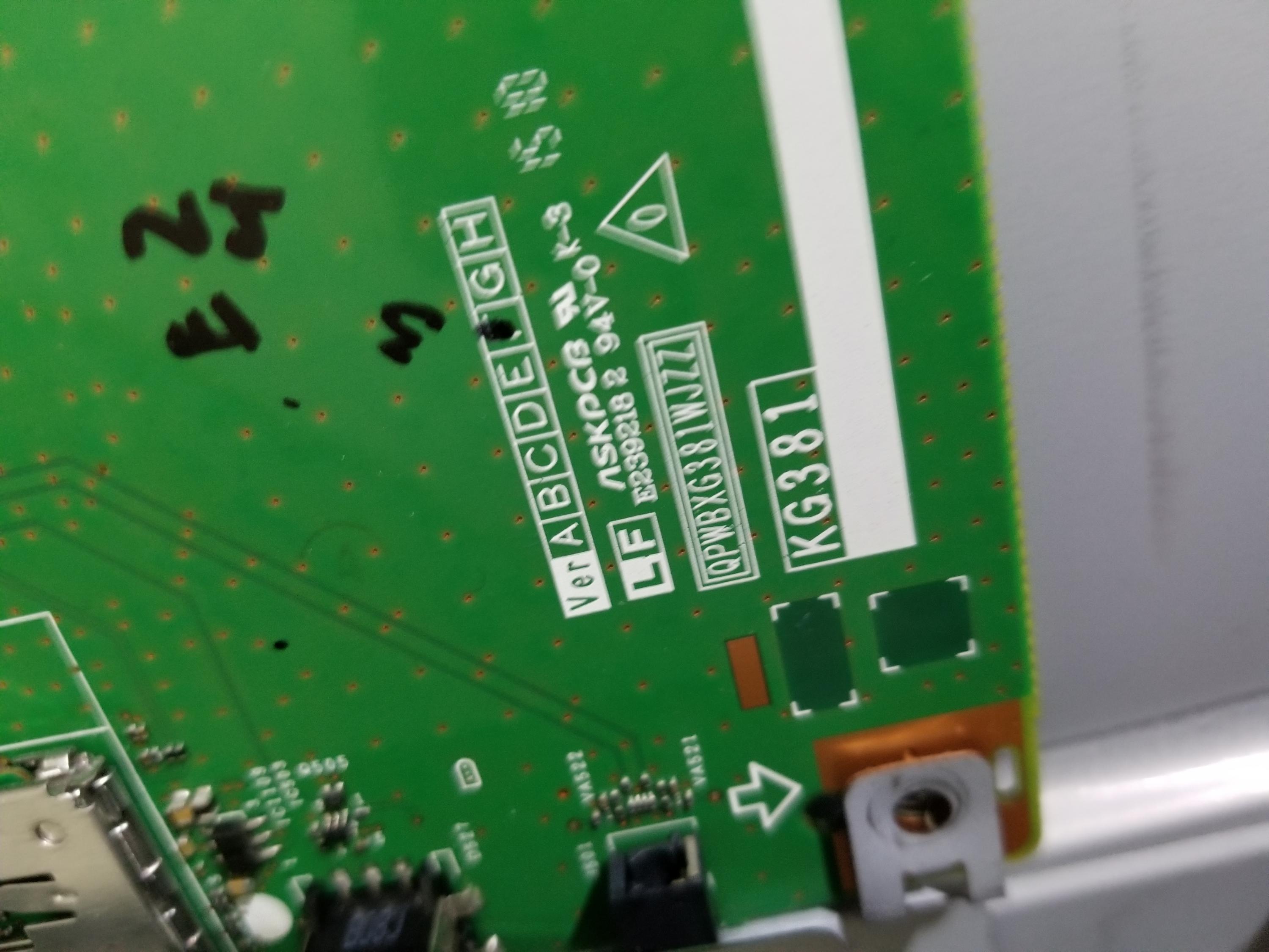

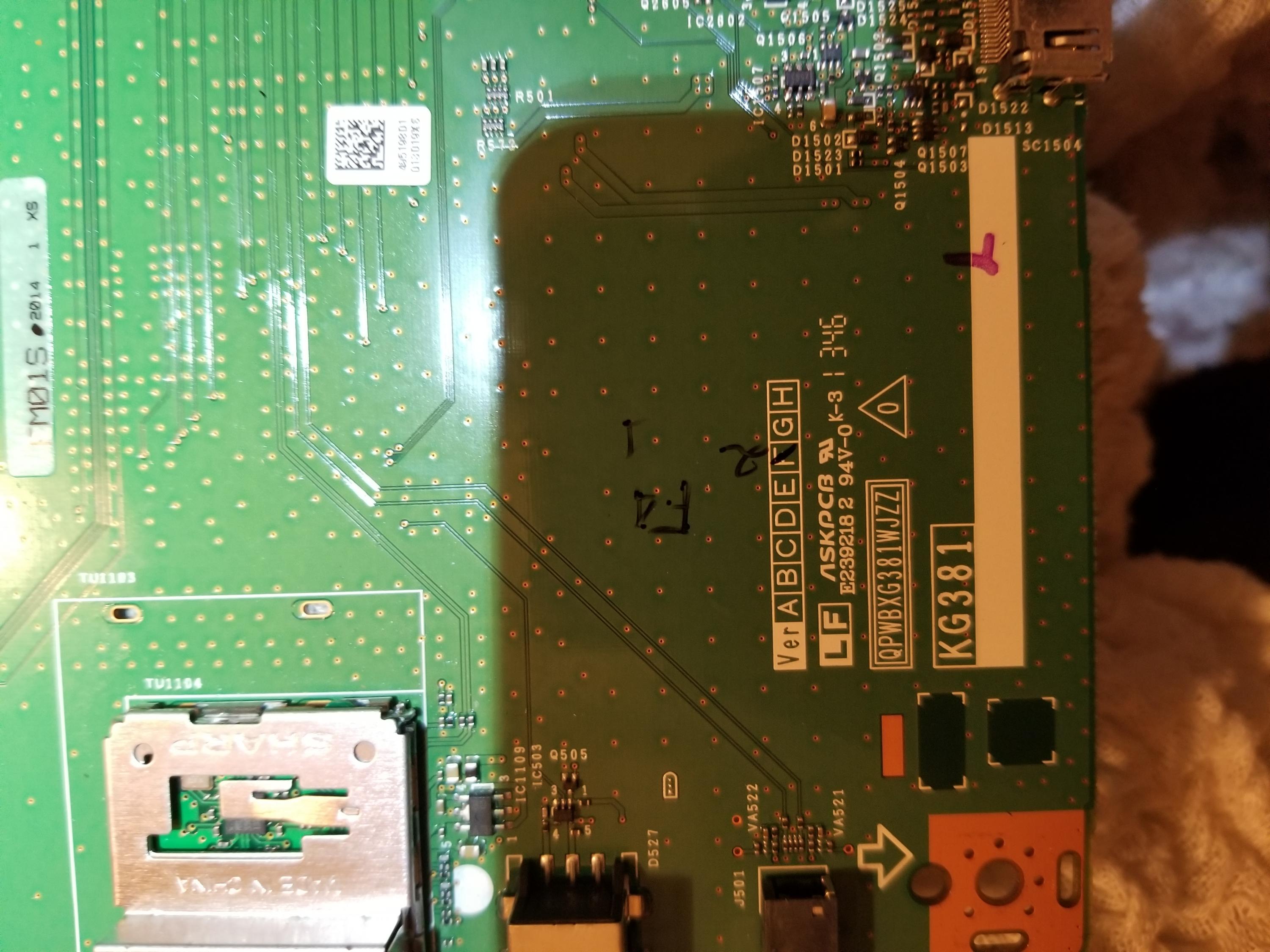

                Hello again y'all.
                I traveled for a few days so have been away from the monster...
                To Diah... I have the MB with it's brackets all back on the TV and to get photos of the OE board part numbers I would have to disassemble again. Now, tonight, I just don't have the energy for that. Worked all day and weekend.
                Q: Is there anyway to KNOW which individual/single LEDs would be the correct replacements BEFORE taking the screen off the TV? I communicated with Shop Jimmy and they said complete sets were never made.
                I ask because I would absolutely prefer to have the screen off the chassis for as short a time as possible. I would like to repair (if I can even do this) and replace the LEDs and replace the screen in one shot, if you know what I mean...? I don't want to have to wait a week between having the screen off and laying around while I wait for the replacement parts.
                Neeeerve wracking, this thing is.

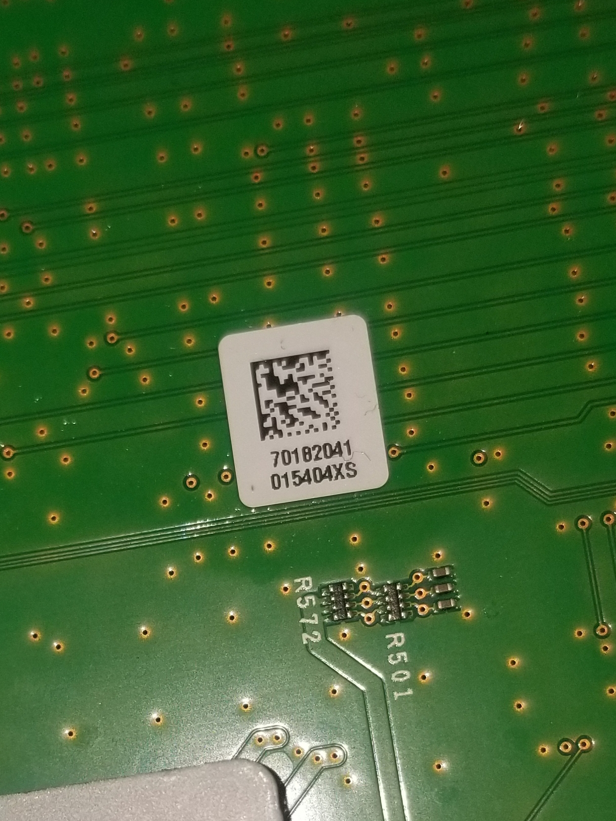

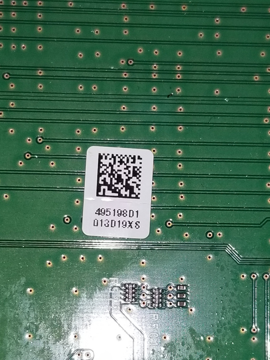

                  Here is the info off the 2 boards.
                  They're identical, unless I'm missing something.

                    #29
                    Re: Sharp 70' LEDs Spike 260v at start up?
                    That info does not tell the whole story, you pretty much MUST go by the info on the white sticker, that printed board info is what they start with, then they populate acording to need.
                      Might very well have a mismatch.
