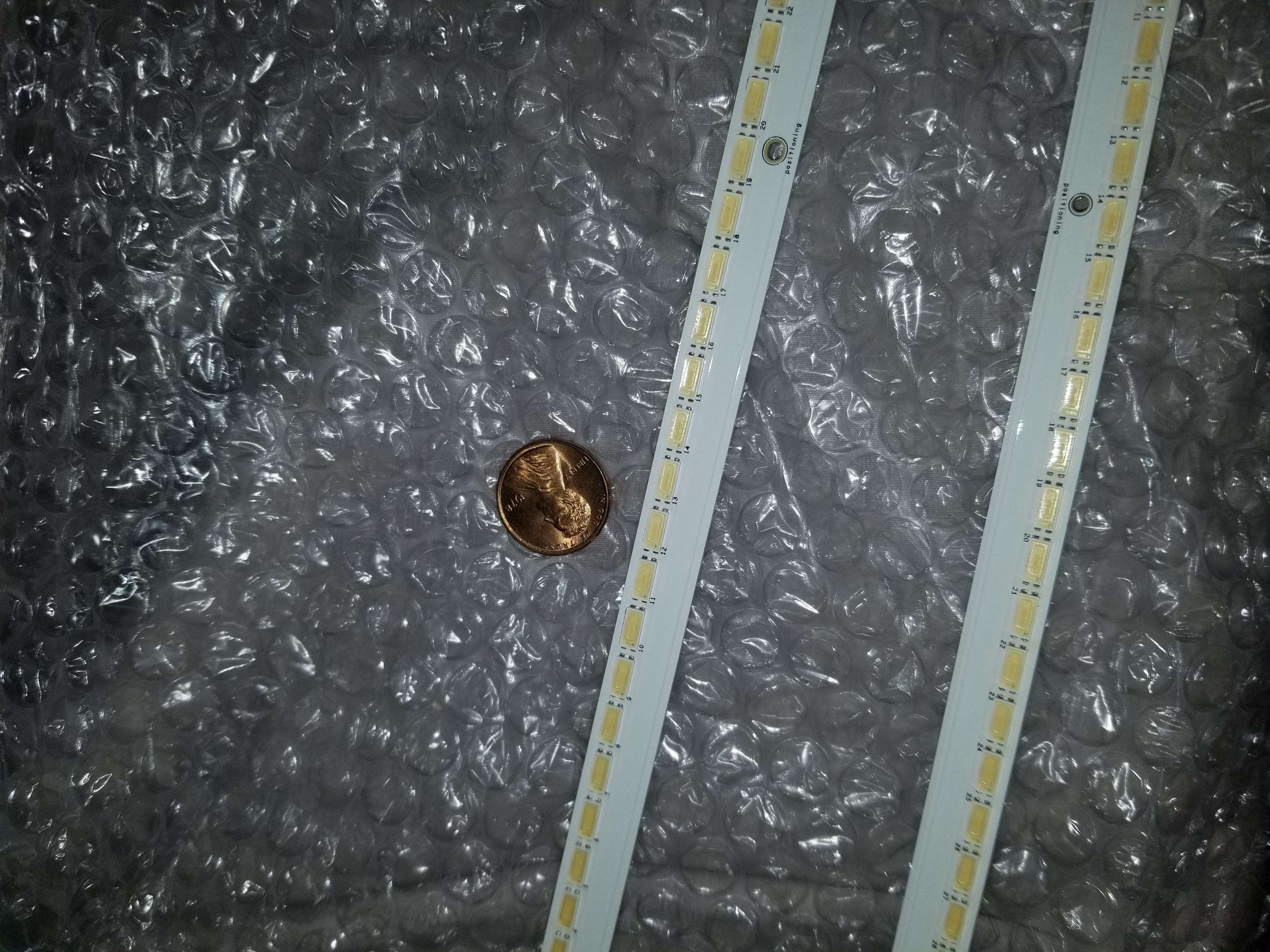

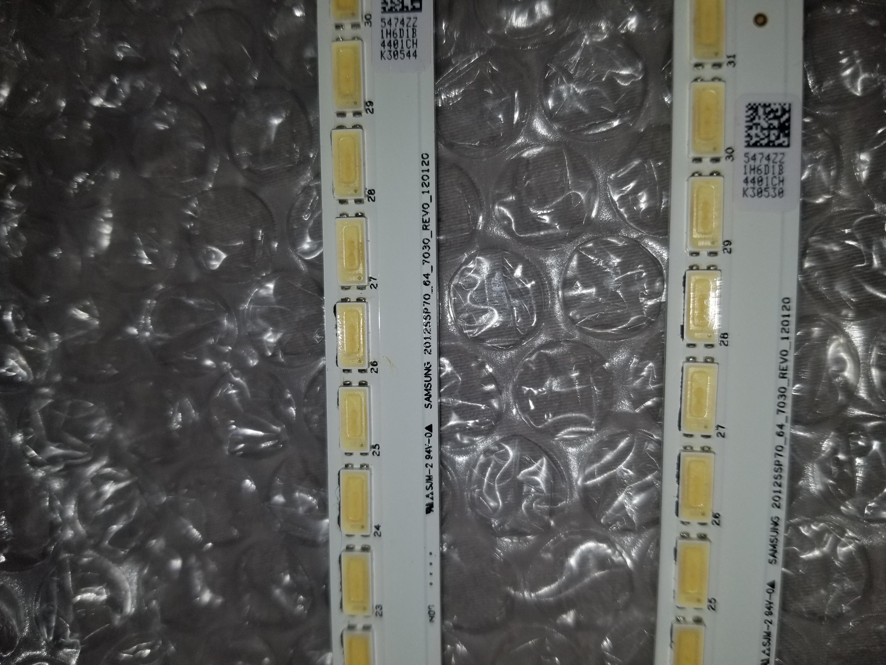

                Ok. Strips came in and I am surprised and a bit confused. I hope you guys are still with me,,, somewhere, out there...
                The strips seem impossibly small. See photo. If there were 3 together, being 20inches each, it would only cover 60inches. It's a 70inch TV. How are these things layed out in the set? 2 in bottom one on top?
                I used the LED tester. Allllll lights light, which is a good thing and they look to be in pretty good shape. Tester says it takes 175v to light each. Is that right? The leads on the set were coming in at 160v or so. I really hope I don't have to solder ANYTHING. These lights are so so small. I have purchased a magnifying glass, .05 solder, a hot plate and a new iron with fine tips - I also have a heat gun around here somewhere. Oh, and no clean flux...
                Anything I should know - besides WHAT IM DOING, of course, lol...

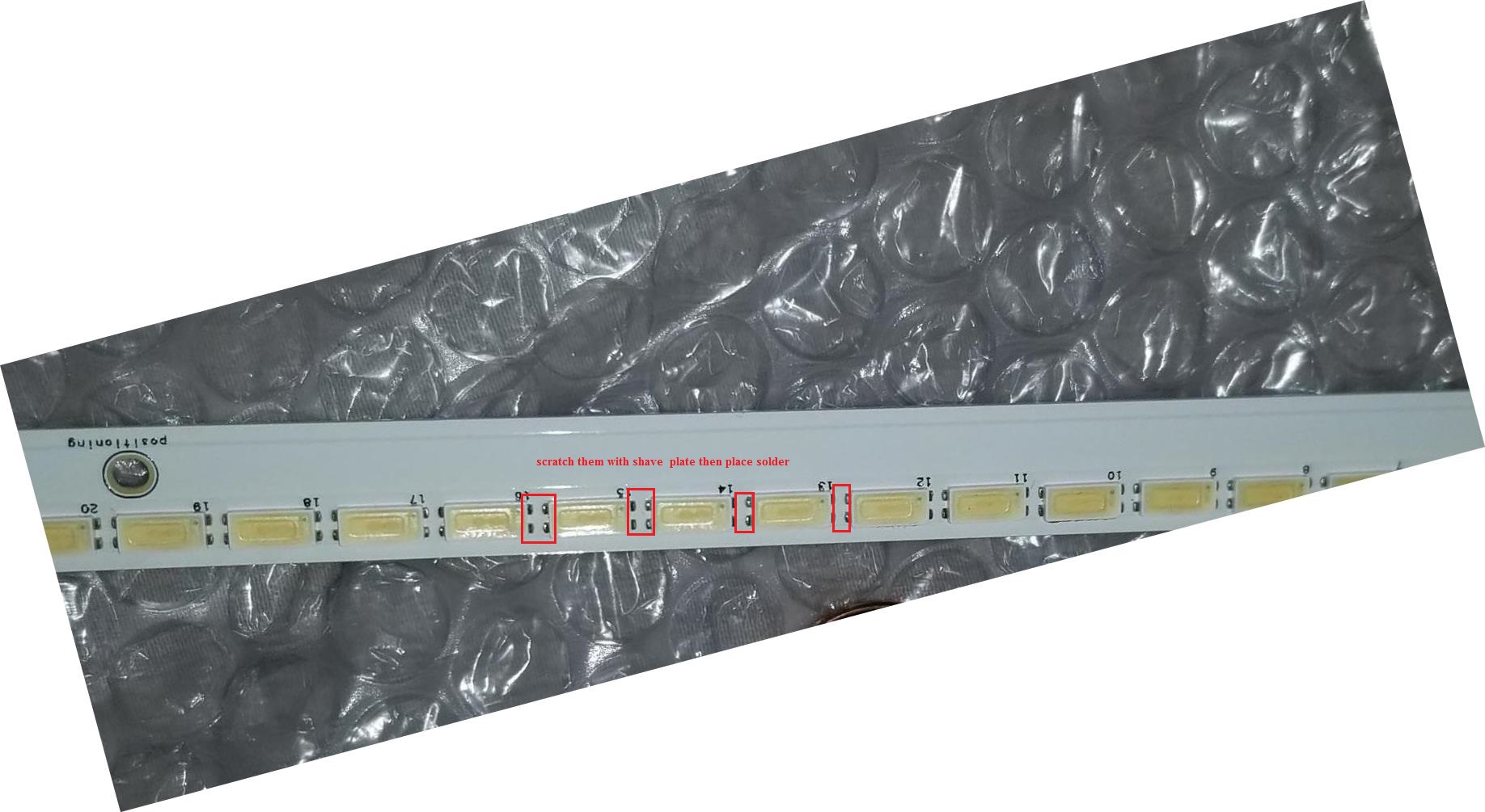

                  #48
                  Re: Sharp 70' LEDs Spike 260v at start up?
                  they pass all 3 on bottom or top side...
                  TV 70 inch = Width 61 inch / Height 34.3 inch
                  about yours old strips if you are going to working on them.. easy way with heat gun from down side remove all... the area between each LED as in photo scratch them with shave plate then place solder at the3-4 area one time. align the SMD LED in place at correct direction then with iron heat the solder area little far from the led. the solder area complete will mild down so any small push from your finger on the LED will let it stick in place with out damaging the led self.
                  just be aware if the strips had several groups it will be the last LED of group go back to the socket and it should not soldered to next group first led as it will share same led + of the stips. and so on to all groups.
                  this is my way to do specially for 7030 6V SMD LED. complete strips will take less than one hour

                    Understood - except for this last part...
                    Originally posted by Diah View Post
                    [COLOR="blue"] just be aware if the strips had several groups it will be the last LED of group go back to the socket and it should not soldered to next group first led as it will share same led + of the stips. and so on to all groups.
                    What I THINK I am going to do is replace the worst 2 strips with the new strips. Then, of the 2 bad, remove the number of LEDs to make a complete and working third.
                    What I see with these "new" strips is that they each have a plug on them. 3 strips = the 3 groups,,,, which matches the 3 groupings I have on the plug...?
                      #50
                      just focus now on how you take the screen apart with out damage it... then replace all three of them at once. the old one you can later play with them as you like to keep them ready for future.
                      the last parts didnt belong to you.. because each strips you have as one group so all LEDs one line led+ go to LED 1 and the last LED will go to led-

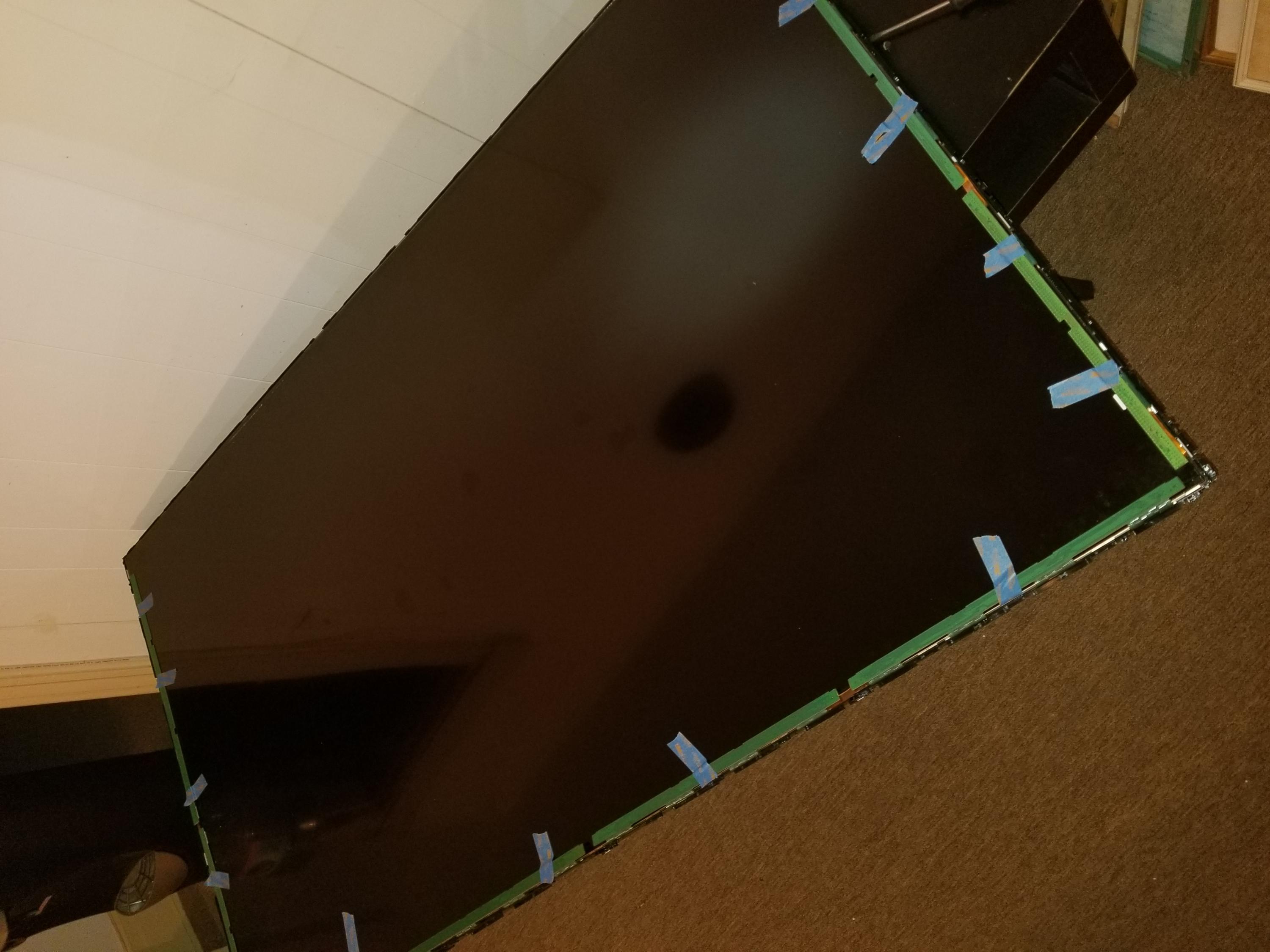

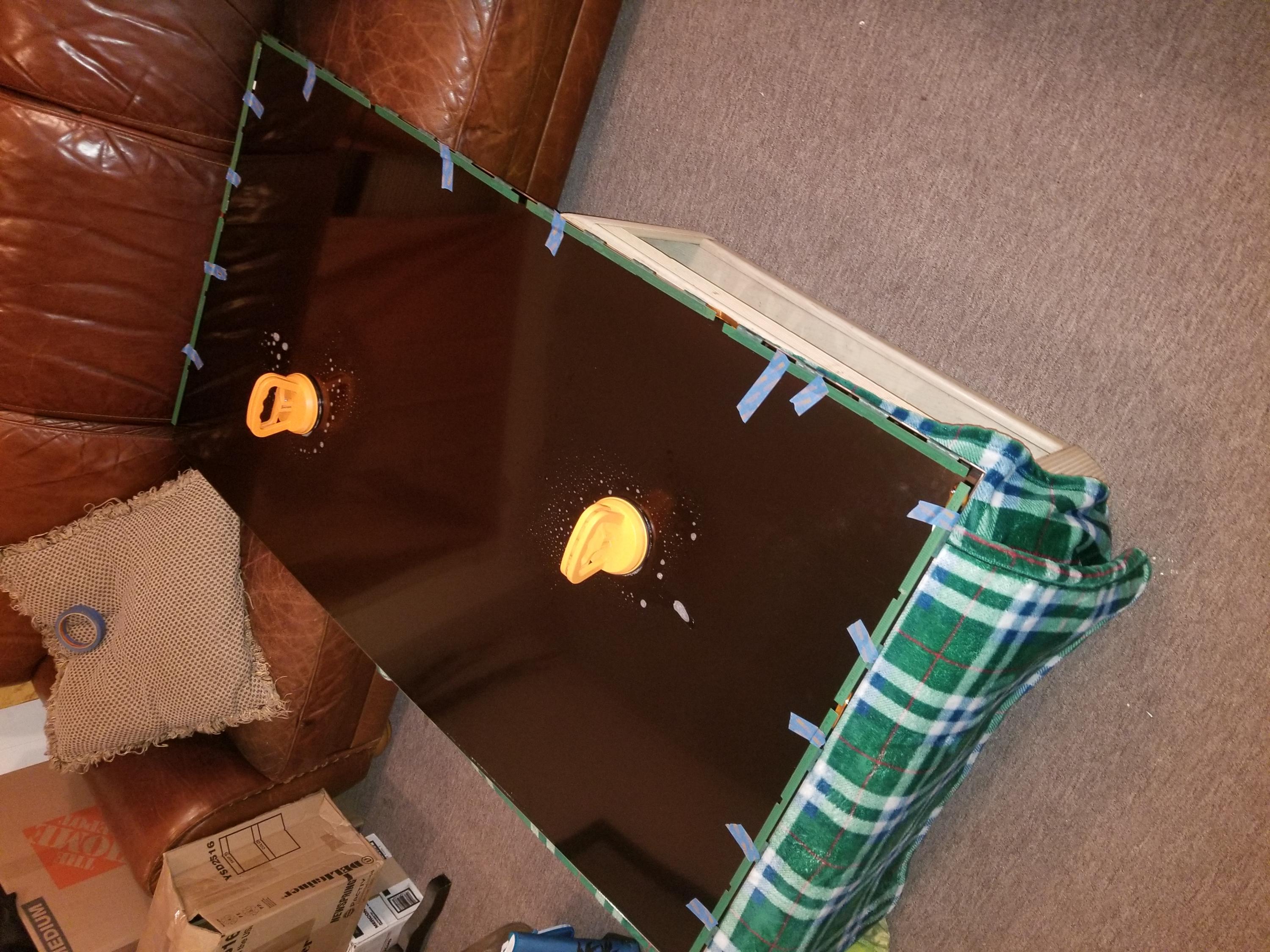

                            This where I'm at...
                            I have 3 old led strips in hand.
                            TV is completely disassembled.
                            Screen came out (did it alone) and is set off to the side. Shweeeeeeeeew!
                            For now I think I should just stick to questions as I amin the middle of this and am not sure what to do next....
                            The best strip has 8 bad LEDs. The other two, they light up well up to a point and from there, individually, many of the LEDs in the strip PARTIALLY light, but not completely. Dim. A few in the PARTIALLY lit section are completely dead. What does this mean? A short?
                            One strip gives BRIGHT lights from end to end. With 8 bad LEDs. I guess I should go ahead and pull 8 good LEDs off the WORST strips, and try my hand (this is the hard part for me) at soldering them into the BEST single strip. The center BEST strip lights up the best by far.
                            Can I use super glue to adhere the strips once complete?

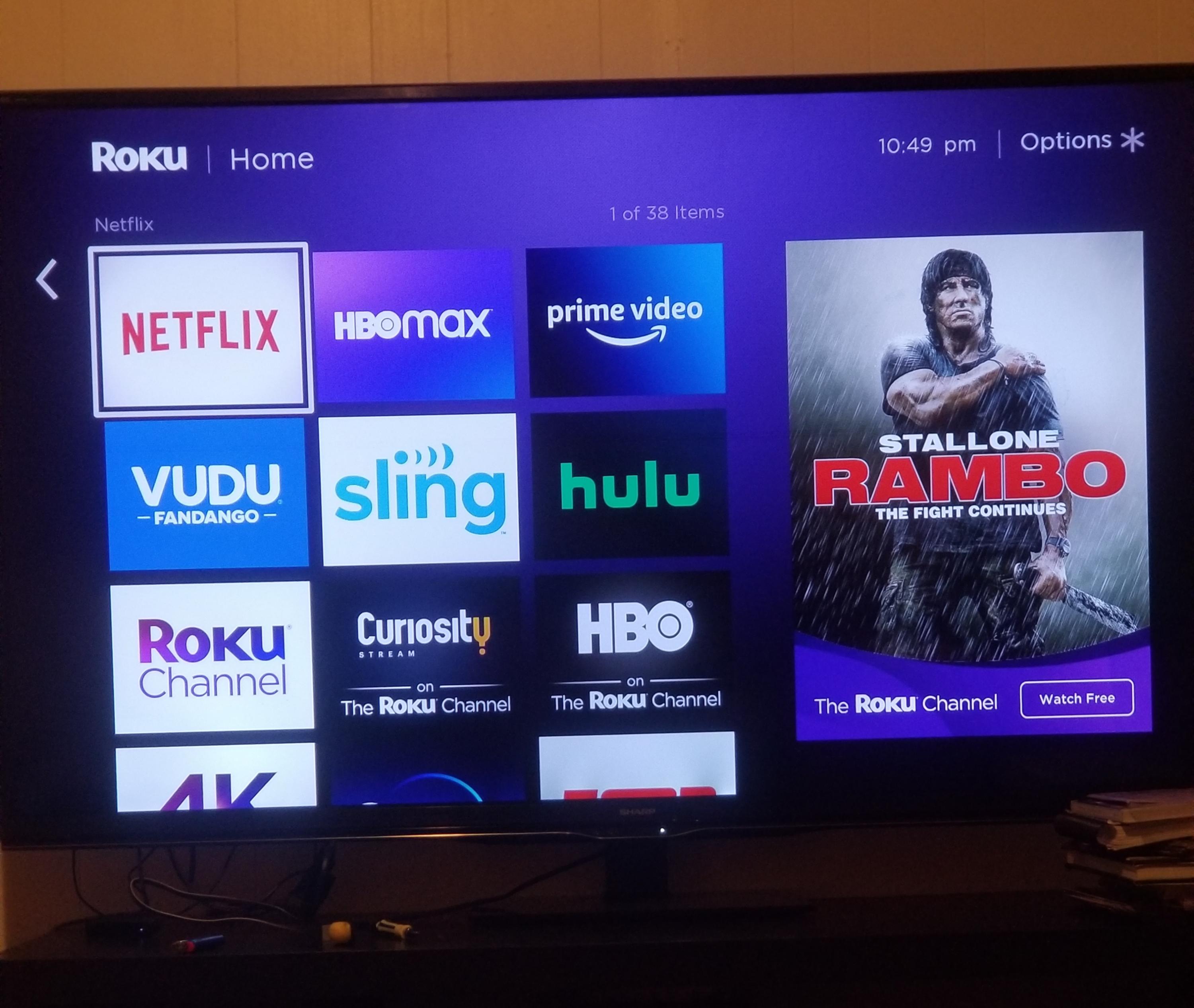

                                    Success,,, well some...! Keeping my fingers crossed, of course.
                                    Hmm. Full disclosure.
                                    I didn't have the courage (or skill, I felt) to tear into and do the soldering on the one "good" strip with 8 out of MANY LEDs. I sat there, looked and looked at it, and just chickened out. I mean, if I wrecked it, I would be stuck in the water.
                                    Not bragging, the job was pretty easy and with the suction cups, there was no point on the removal or reinstall of the screen. In and out.
                                    The difficulty was in the reinstall of the ribbons. Strange. Then, getting the defusers correct and clean and right...
                                    What I'm left with:
                                    TV overall looks pretty great! I think.

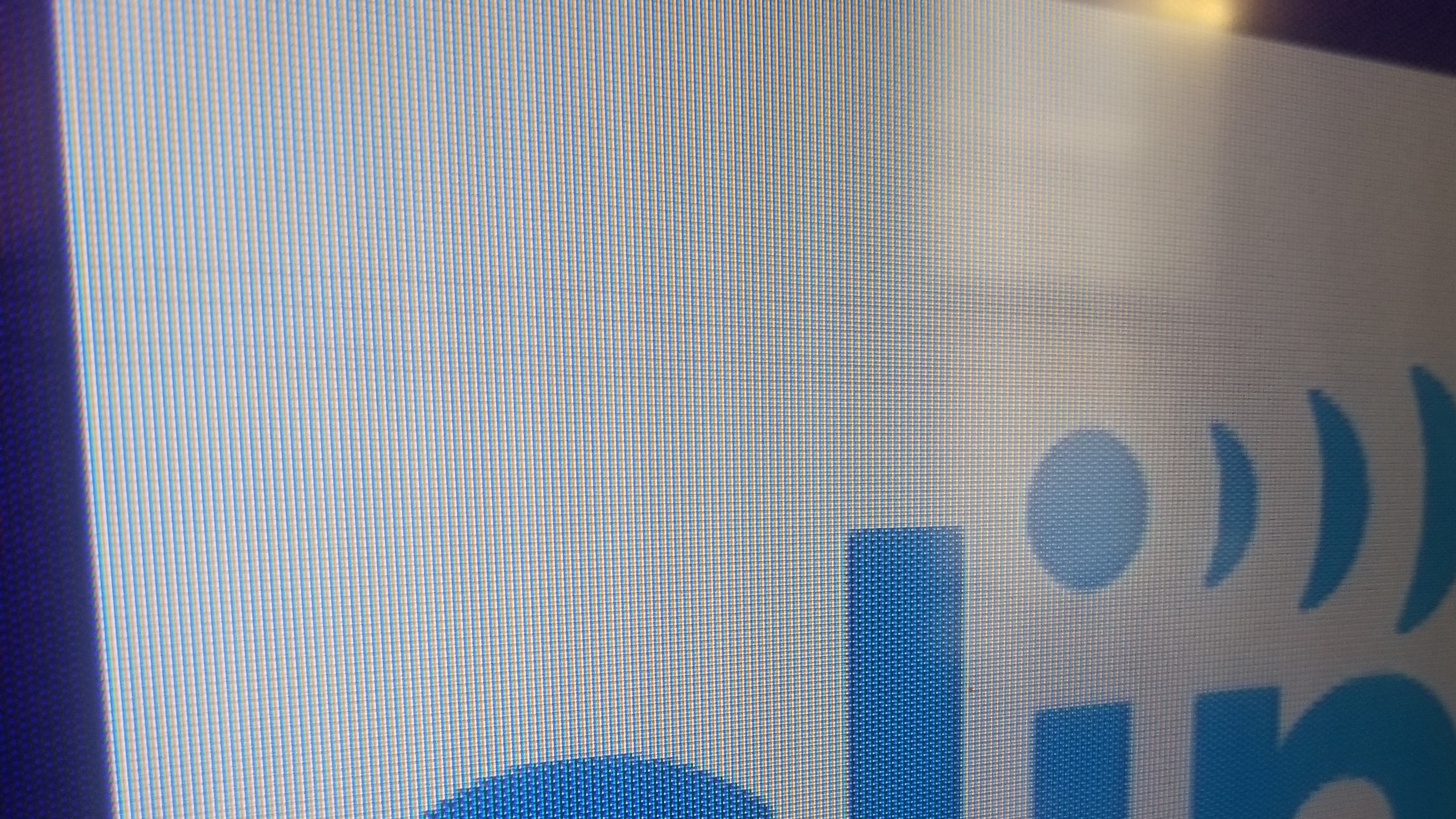

                                    I have 3, maybe 4 barrrely perceivable black lines that run straight across the screen, horizontally. Super fine and thin... What is that? I figure it must be a poorly seated ribbon???? Please tell me what to do if you know. I still have the back off the set.

                                      I don't know if the image quality on the site or posting this here will be clear enough. But these are the lines. They go completely across the screen, end to end, and to my untrained eye DON'T look like screen damage. What say you?
                                        #59
                                        good work.
                                        the noise thin horizontally lines caused as you thought because of ribbon need to clean the contact pins and seated them carefully.. as they are old and already dried out so easily the contact pins break out
