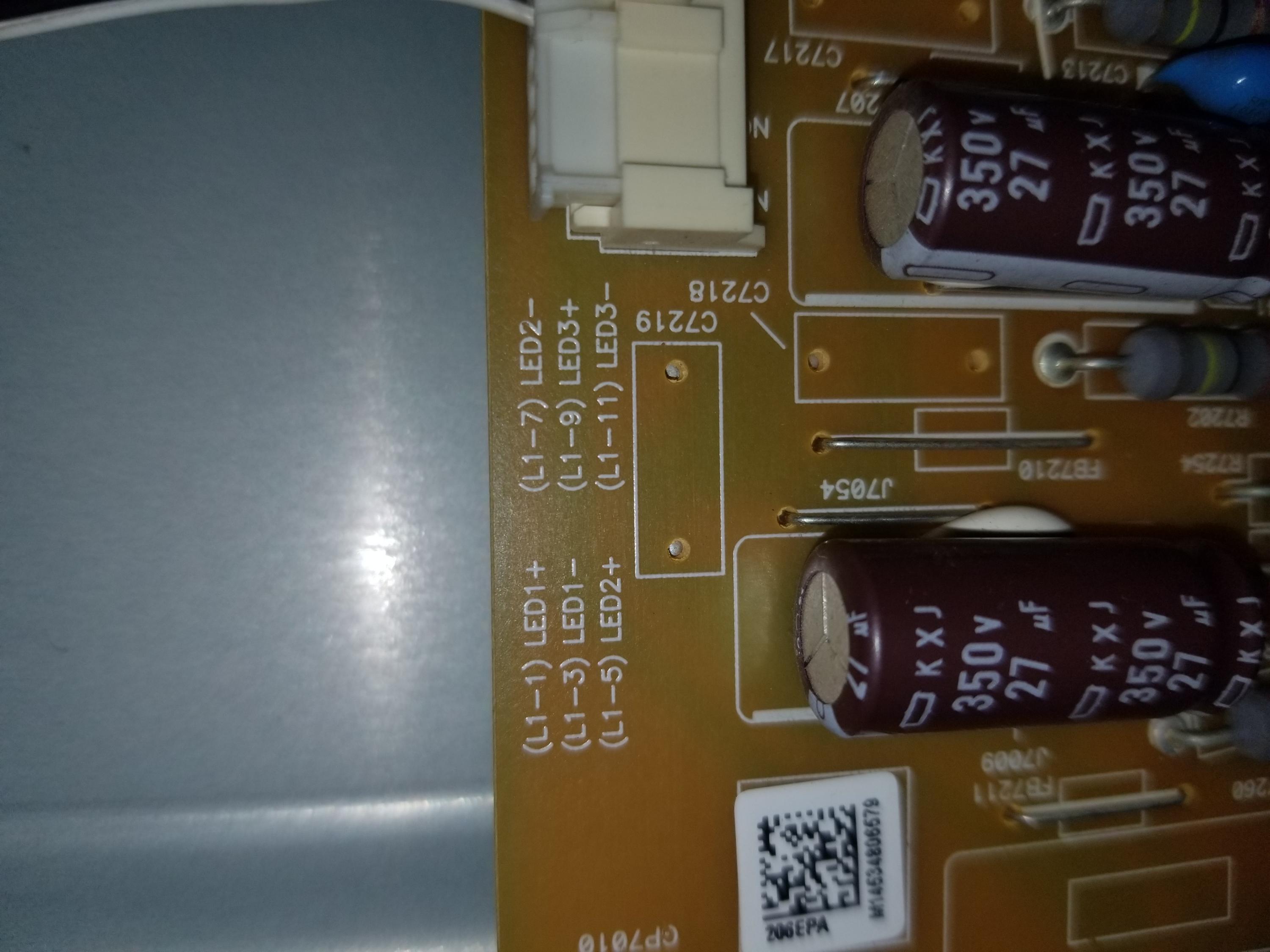

    Hi all. This is my second thread. Have a bunch of questions.
    I got my hands on a 70 inch Sharp Aquos LC70EQ10U. Not working when I found it.
    I replaced the power board (found in eBay) and the TV finally produced an image. Reset it had image and sound.. Went from 2 slow and 2 fast blinks as a fault code to 1 slow 1 fast fault. Lamps or inverters according to the manual. TV is one now, at this moment (looks great w/ ZERO dark spots on screen) but it powering up and producing an image is unpredictable. 3 out of 10 times.
    There are 3 leads to the LEDs. On start up with a DMM I was getting a spike up to 260v measured with DMM. TV would cycle up then shut itself down due to power spikes....?
    With LED tester (if I'm doing it right) tv off, plug discon and back probing into red, blue and black and its white counterpart,,, I get R = 196 Bl = 196 and B = 190... All 3 LED strips light up, I can see them in the back of the TV...
    Voltages on these leads when the TV is playing varies but they are usually around 160 to 170v
    I have a "new" main board on the way.
    I don't know what's going on or what I'm seeing.
    What causes the spikes and what part of the TV controls the amount of voltage provided to the LEDs and when.
    I kinda am hoping for a basic TV anatomy lesson.

    Re: Sharp 70' LEDs Spike 260v at start up?
    The reason the voltage is high is that it sees an open circuit, so one or more led's are likely going open.
        Originally posted by JayPoorJay
        What is a "normal" voltage one would expect?
        Likely what you measured when the tv was working, around 170 v
        This is the V+LED supplied to all three strips, then the - return side of each strip is current controlled. This current is closely monitored and will shut down the controller if the current draw is out of spec.
        Also remember that the led tester only supplies about 10~30 ma of current. the leds draw a lot more under normal operating conditions and that's when they can fail.

          So does that ONLY leave the LEDs, or can it it be the main board not monitoring what's going on correctly, or both? Where does that leave me?
          The prospect of removing a 70inch display to replace individual leds as my first go around with something like this freaks me out a bit, lol. But, I did rescue a early 2000s something jaguar that had gone under water! Yeah, I'm nutts like that.
          Are there suitable replacement LEDs that can be found and, is it just a matter of time before more fail considering age and the punishment they've dealt with, etc?
          Someone had suggested running/wiring a "table lamp" in series with the LED strips...? Is that a thing?
          What would you do here? When operating, the darn thing looks perfect!
          I have a used main board in the way.
          Is this board what monitors this? Could I be as lucky?
          At this point I'm into this for 100bucks. Willing to spend more. The "poor" in my user name IS saying something and a new 70inch tv, well, that's lots of pennies in the piggy bank. And, I like to rescue and repair.
          What now?
          Sorry, I'm all questions...
