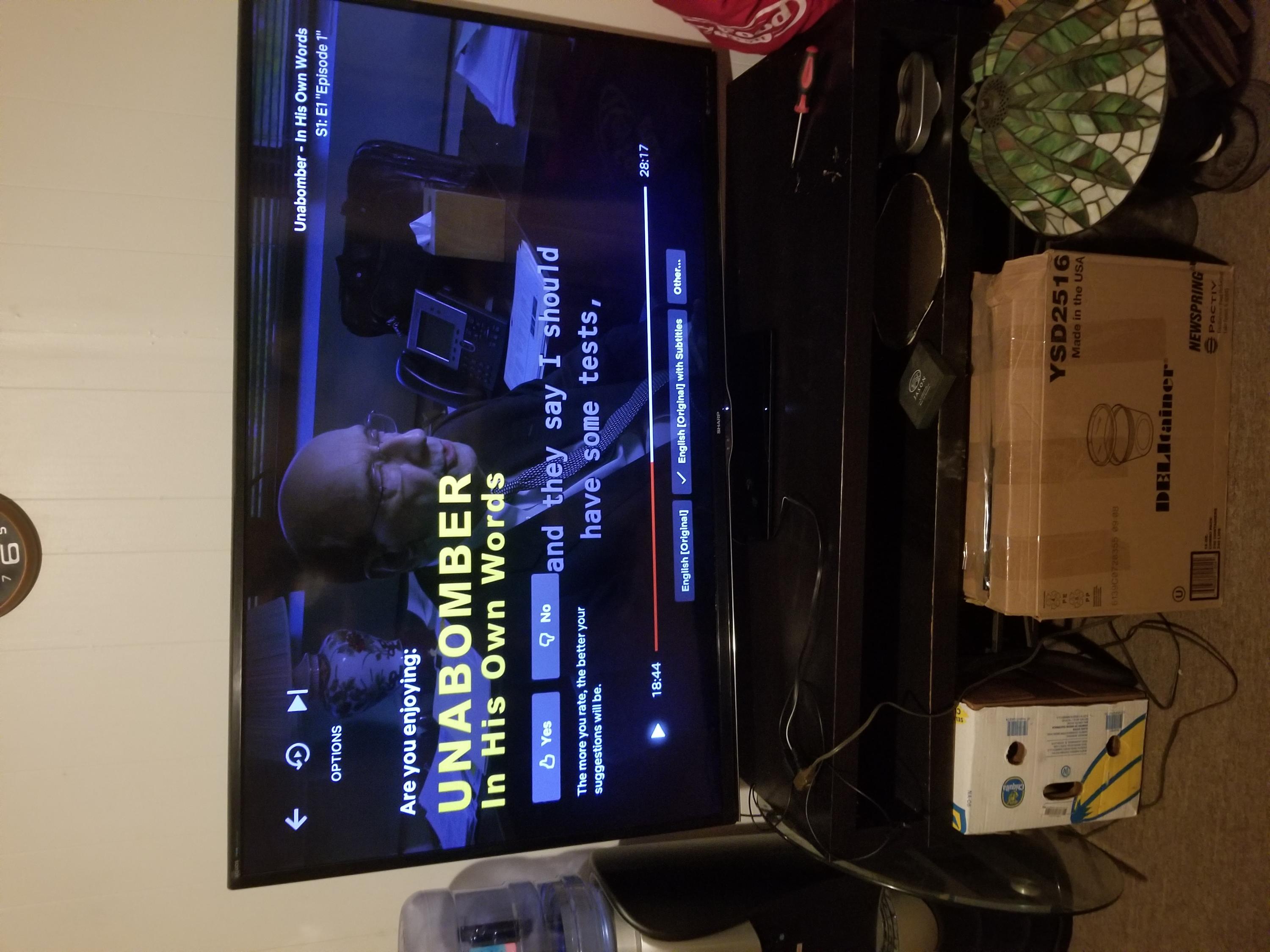

              Re: sharp LC70EQ10U 2 slow, 2 fast blinks
              Shoot!
              So, got a stand, been turning the thing on for days since "fixing" it and today, went to turn it on in anticipation of putting it on the stand and setting it up and BAM. Something that's happening that wasn't, when I turn the TV on SHARP comes up on the screen in bright red,,, that disappears and the TV seems to go to the next step - I see a input kind of menu item - telling me the INPUT and a channel I think. Then I hear the faintest click or a soft tap and the screen shuts off. It's strange. Then,,, slow single blink, then a fast single blink Wich, from the chart about be, indicates lights...
              I was getting that blink pattern before and when I did a hard rest it came together. Blinking stopped and tv worked
              Now, when I try to get to that K mode to get to those settings again, K comes up briefly to give me the menu with a static-y screen,,, then shuts itself off.
              I'm all kinds of confused.
