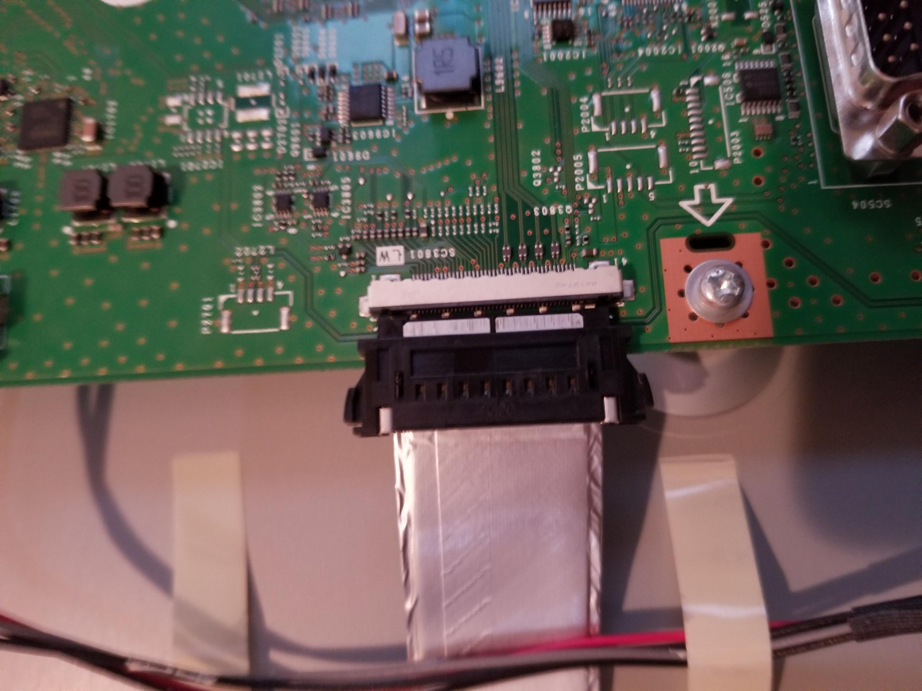

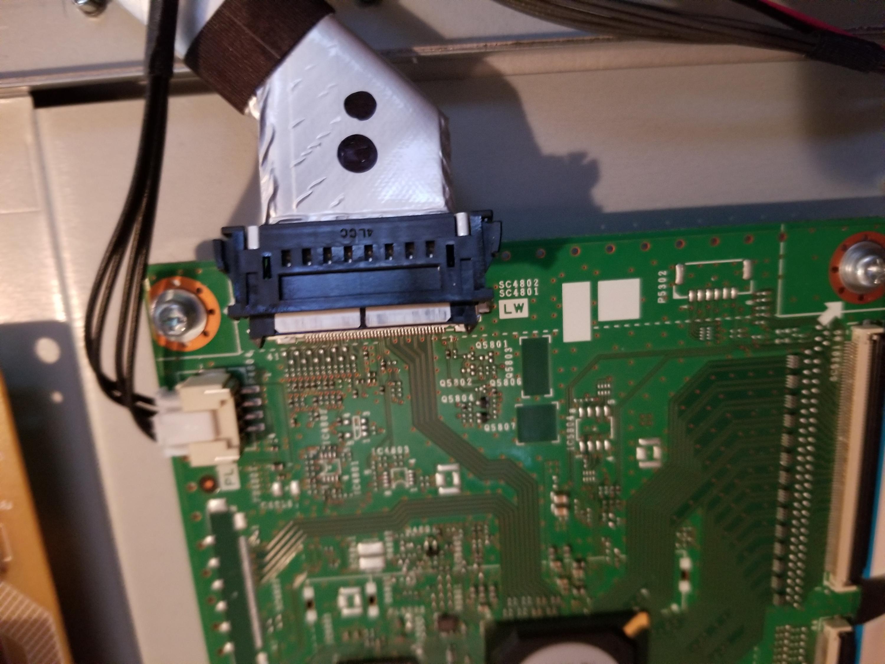

              Update. When I went to work on the thing this morning all I got when I plugged it in was the one slow one fast blink... So, I took the back off - and intend to leave it off until I am confident the problem is sorted,,, or not. If ever.
              As suggested I've removed and cleaned all of the major clip on/in connectors the best I could. I noticed two things in this. One of the main if not the main connector(s) going from the power board to the main board was sitting just the slightest bit cockeyed in it's slot. Also, the back sides of the connectors on both the power and main boards looked a bit corroded/dirty/worn. I used DeOxIt and a qtip to clean the best I could. The never came completely clean and witness marks were very visible - the qtip did show some soiling... I did this all other connectors I found. At least unseated and reseated several times, spray on qtip where possible.

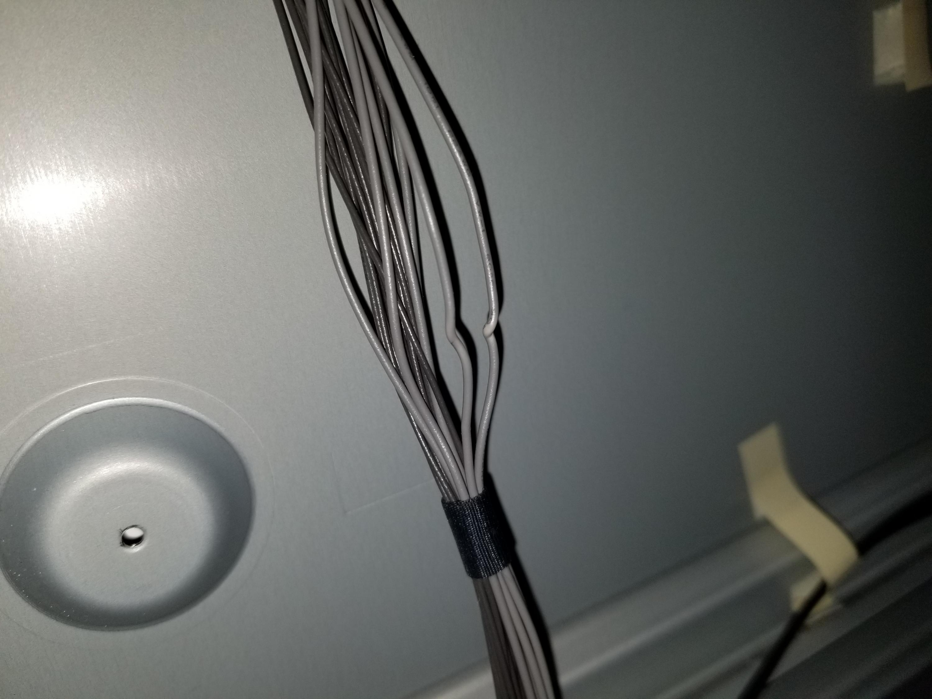

              Also, found a severely kinked wire in the loom between the power and main boards. Cut out kink and soldered in a new short section of wire.
              Also, using DeOxIt, I seated (screwed out then back in) all 15 to 16 small screws holding on the boards as well as the spacers that are between the board and the SET body - which I assume provides ground for the boards and their components?
              Did this and some other things (just things) and plugged it back in while holding the power button on. Power light blinked maybe 25-30 times, SHARP on the screen. This completed some kind of cycle and the TV powered on and up. Full lit.
              I have turned it off and on several times. I applied a small drop of super glue on the outside seamof the cockeyed power plug as it seemed to want to remain cockeyed after being squeezed together. The mating surfaces are now flush (thanks to the dab of glue). I've turned it off and on several times since and it powers up rightly and goes to Roku screen. No more flashes/blinks fault.

                  I suspect there's a problem with the mainboard, all the voltages are as expected on powerboard right?
                  I will need some help checking main board power voltages...
                  I have the back off the set, just need some instructions.
                  I'm all ears at this point.
                  It seems like alllllll lights light when they do light. When they don't, none do. When I power up the set SHARP comes up red, looks normal, then to a screen, lights on, upper RH corner says channel 2 analog if Roku is not plugged in, then it suddenly goes black. With a flashlight I can still see images IN the screen, but there is no back lighting.
                  The inverter,,, is it in the power board? Earlier, someone posted the fault codes for blinks. When it does go into a fault mode, I get 1 slow, 1 fast and from the chart it describes lamp or inverter issues.

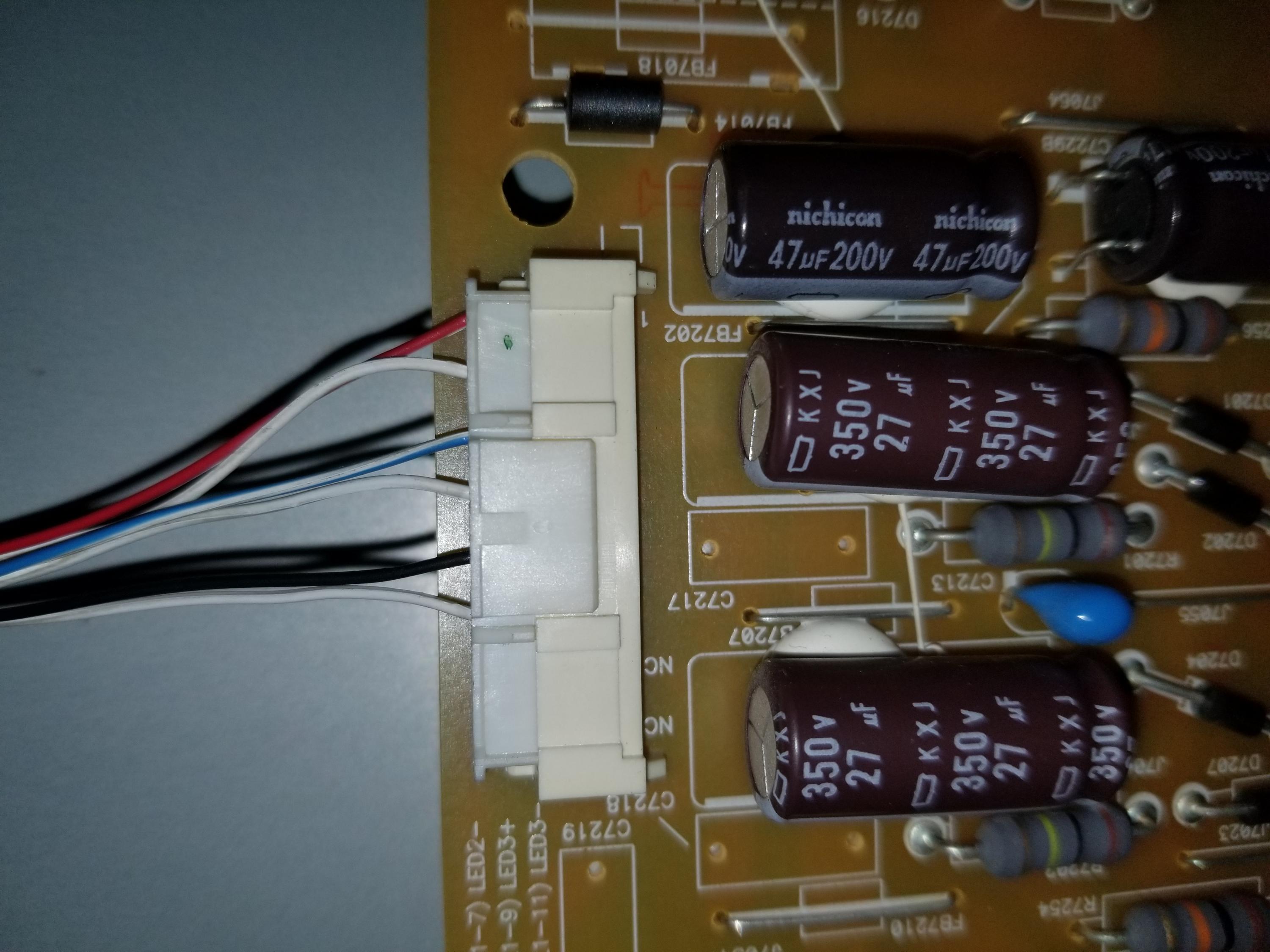

                      I found what I believe are the 3 major leads to the LED strips. Measured to ground and got 5.5 - 5.6v on the positive side. Do those values make sense? From memory, I got nothing at the colored wires but voltage (above) at the whites...

                                yours photo
                                on this socket you have 3 groups each with LED- and LED+ , when you recieve the LED tester it had also - & + so you can test each group if it lit and the currents pull out of each group = the other groups mean there are no open circuit at them. so first start with this easy way

                                          Ok. Home from work. Wire colors from the picture above.
                                          When I turn on the tv with DMM probing red wire I get 250v as the power boots up and the screen lights thru SHARP logo. After that, when screen goes dark it settles at 164v
                                          When I turn the TV on blue and black wires both give 236 volts as the set boots up and SHARP logo... Like the red wire, once the tv completes boot and screen goes dark it settles at 164v...
                                          Using INPUT ONE for Roku, Roku info can be seen on black screen if a light is used. While screen is black all LED leads are at 164v - no lights on screen.
                                          After force start the above are the values I get at the LED plug. After force start TV will power on with button, lights for sharp image and a second for an "INPUT" screen (or something) info in upper RH corner. Then it goes black. 164v values remain.
