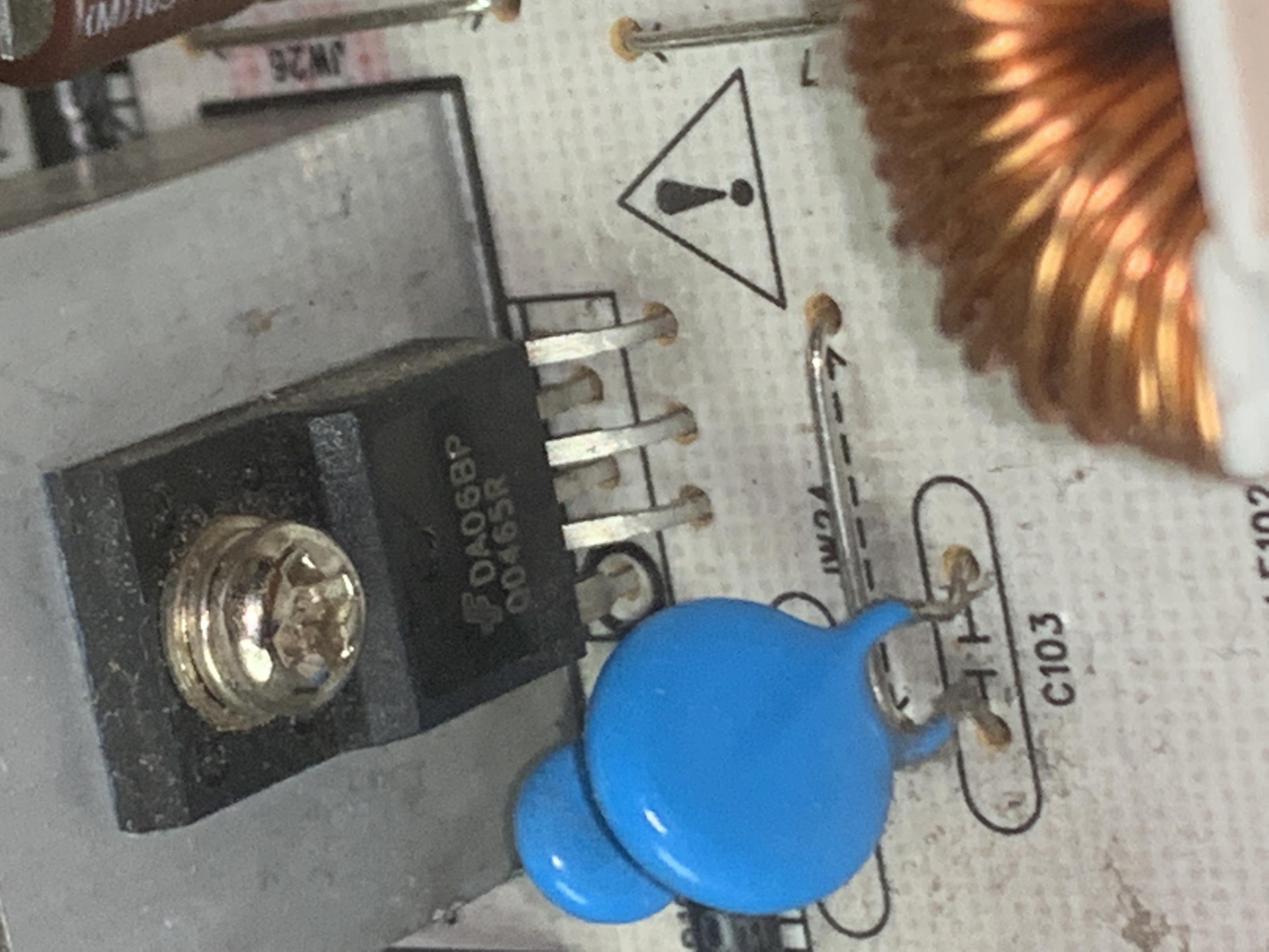

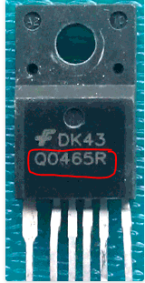

                            I was not able to find an exact datasheet of the original IC. This is the replacement IC FSQ0465RSWDTU. I'm attaching the data sheet for it. Could someone confirm if it is a suitable replacement?
                            I'm also attaching a picture of the original IC

                              Re: Vizio TV E470VL SMPS Flucuation Output Voltage
                              Your original Q0465R (bottom line) is FSQ0465RS/RB (this is the full label).

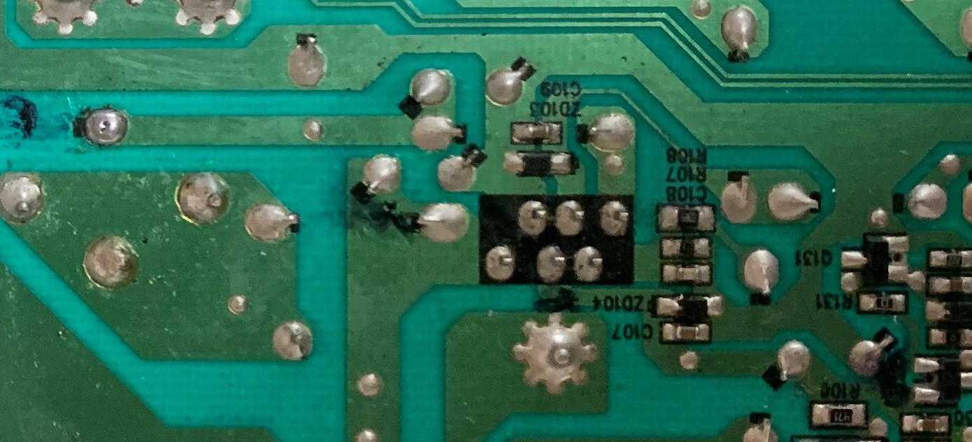

                                          Can you tell me what the black area is at the 6 pin IC? Is it a kind of epoxy? Does it help in the removal heat? Some of it was removed when I de-solder the IC. Is it important to replace? If yes, can you tell me where to purchase. Picture attached.
