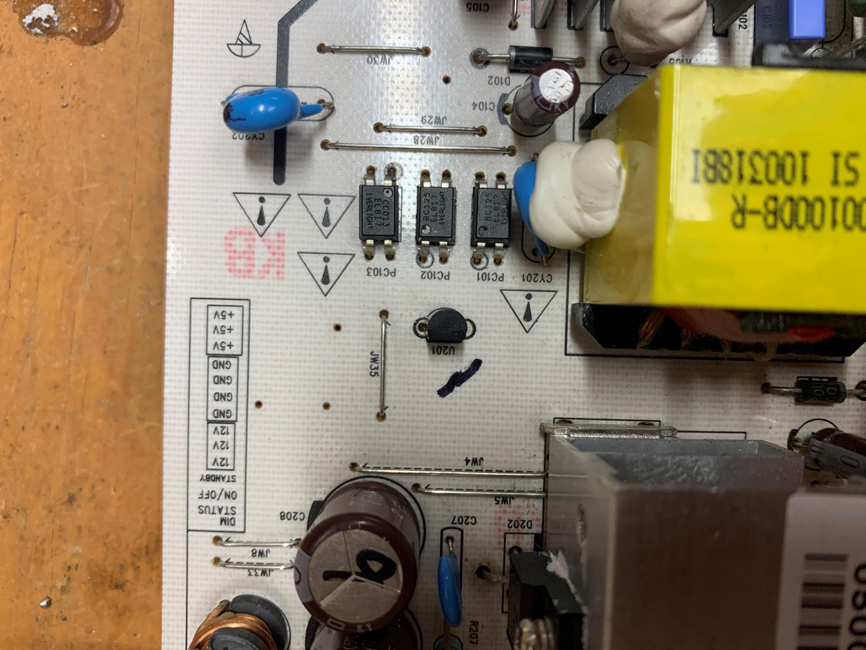

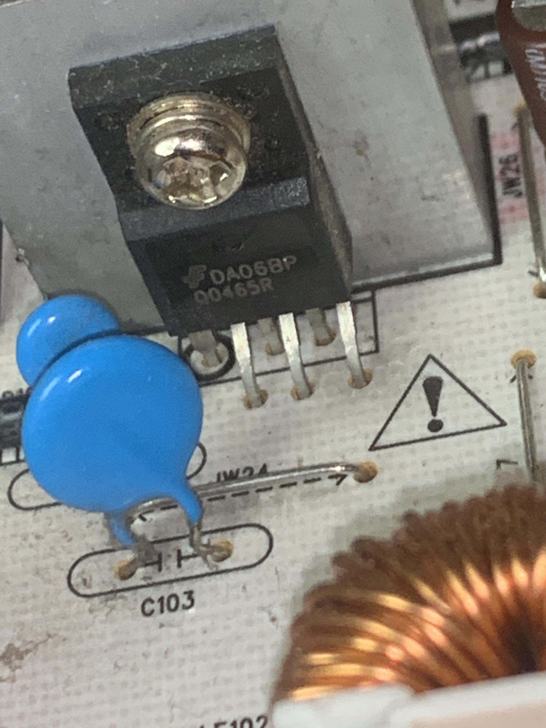

    Re: Vizio TV E470VL SMPS Flucuation Output Voltage
    Images there, some of yours look cracked, a little flux makes the solder flow in nicely: https://www.google.com/search?source...h=708&dpr=1.25
    • R_J
      • Jun 2012
      • 9535
      #42
      I read which parts you changed and had another look at the pictures.
      After another look at your board, I think I found the problem, U201 is in backwards.

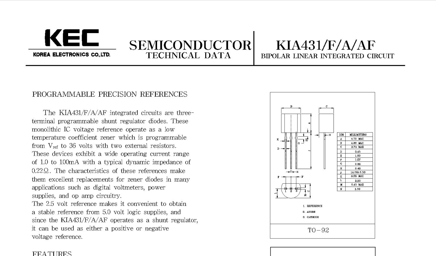

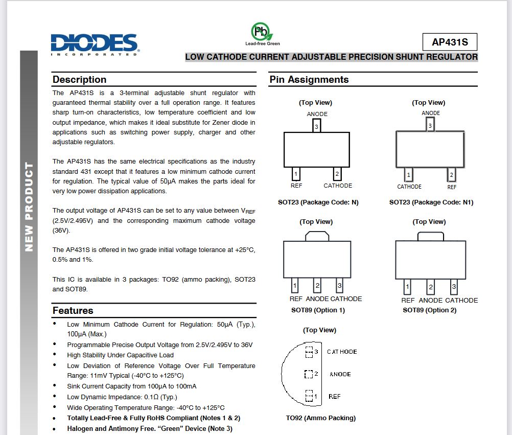

        Good Morning RJ, I certainly could have installed it backwards. I installed AP431 to replace KIA431, I'm not for positive, but it appears the pins out are opposite and that is why it is installed in the opposite direction. I'm attaching pictures of the pins out for each, will you have a look and see if I indeed installed it backwards?
        • R_J
          • Jun 2012
          • 9535
          #44
          I still think it's backwards. The AP431S is showing the pin configuration looking from the TOP. I'm sure the original is ok

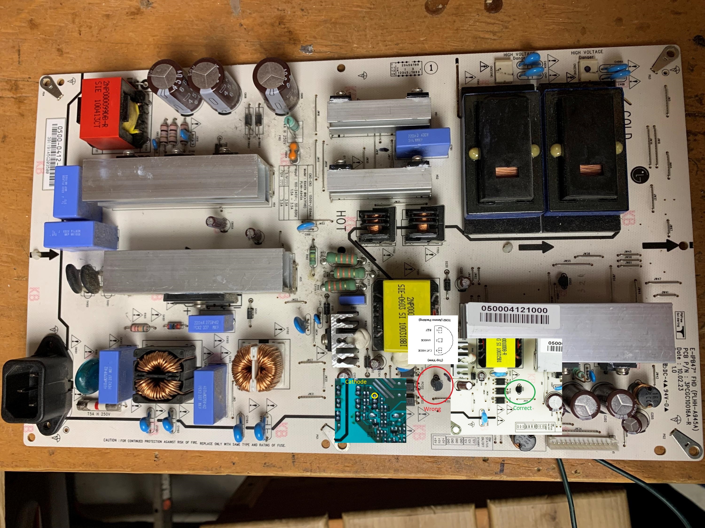

            #45
            Ok, I will change it. Thank you.
            • dholley
              Mr. Blinky
              • Jan 2022
              • 87
              #46
              RJ, i changed the orientation of 431, picture attached. There is approximately one volt higher on the 5 volt output, it used to be around 4 volts flucuation it is now approximately 5.25 flucuating. VCC is flucating between 9 and 11 volts, approximately.
