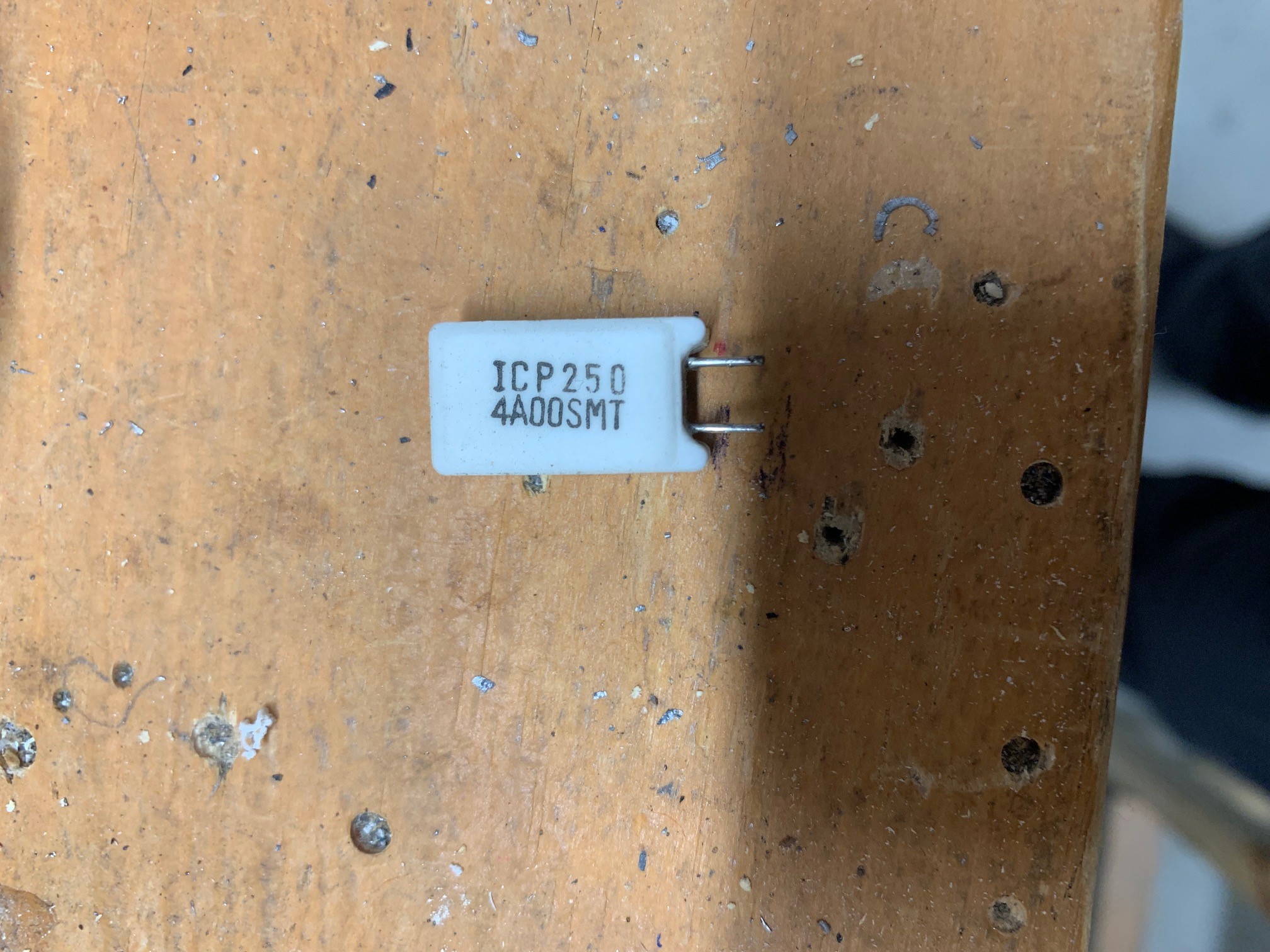

    Fuse 102 was blown. I replaced with a fuseable 2 watt 0.1 ohm resistor FKN200JR-73-0R1. the information for the fuseable resistor replacement was obtain from another Badcaps thread, the person had a similar Power supply and problem with the same fuse. Original fuse attached

      Re: Vizio TV E470VL SMPS Flucuation Output Voltage
      huge different between label F & R ..wrong Info on another threat.. remove the R . u can use normal fuse.

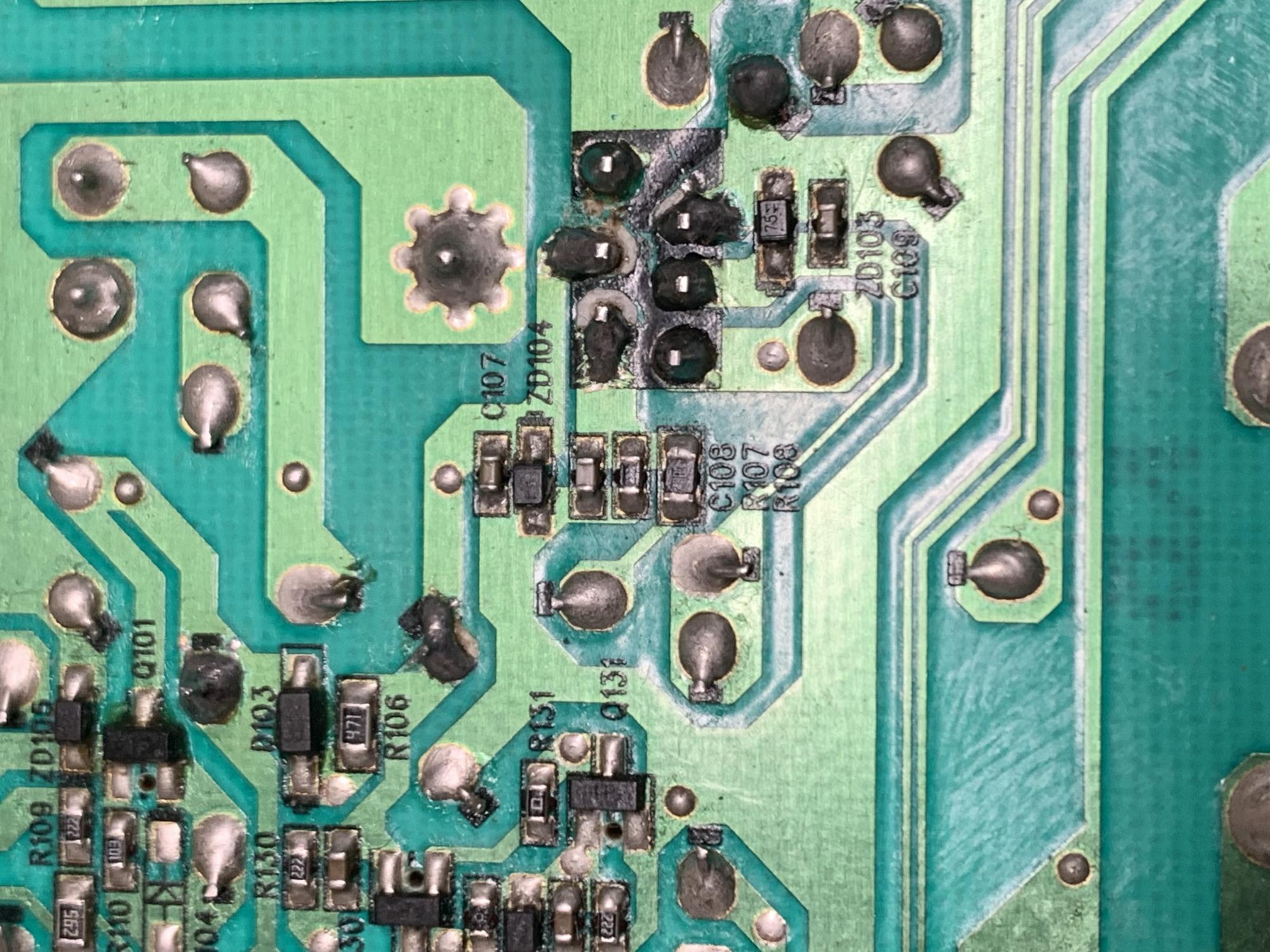

                        I think that is a problem. Backside pictures are to blurry to trace out. You need to identify components in pin3. Should end up at one pin of transformer.
                                Zd104 and or c107 appear to be shorted, they read .072 both ways In diode mode. They are both connected to Vcc Pin 3. Should I remove from the board and test further? Picture attached
                                • nomoresonys
                                  • Jan 2013
                                  • 12206
                                  • U.S.
                                  #116
                                  Why not, lift a leg of the zener and retest, also test where they connect to see if you still read short and see if the cap still reads short with zener out of circuit. could also test that cap in circuit in ohm mode, it dont look like those should be testing short.
